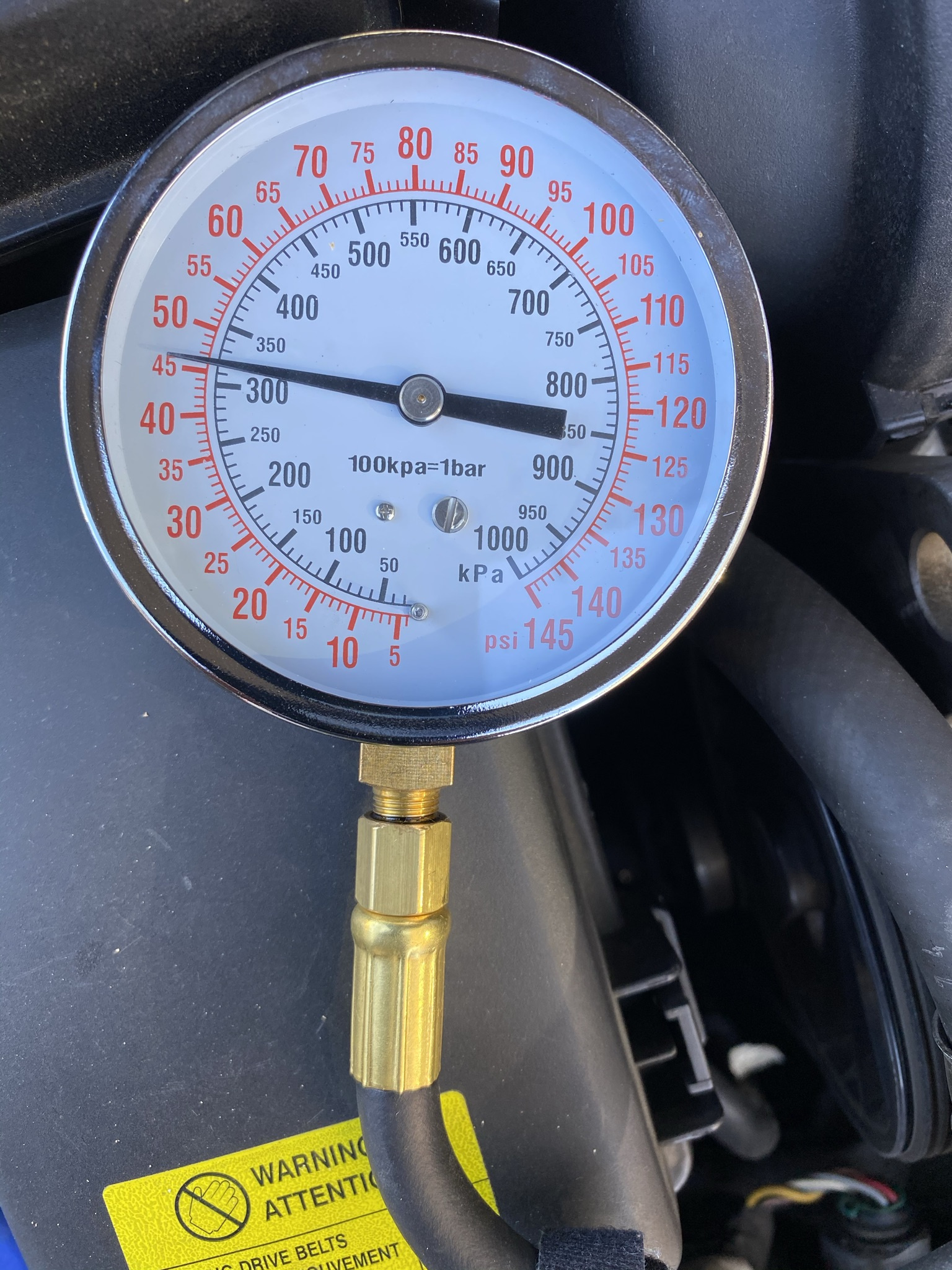

I think it is due to Vida measurements is absolute pressure and the gauge measures relative pressure. This explains the difference of 100kpa/1bar.Rvolvos wrote: 05 Dec 2020, 15:31 Ordered a CTA fuel pressure gauge from Fcp.
Gauge shows 300 kpa & Vida shows 400kpa while idling.
The FPS has been replaced at 175k. Which one is correct?
Vida did not detect any codes.

Did some further investigation into the starting difficulties.
I did a dry compression test on a warm engine. Compression numbers where 165,160, 167,170,165psi
Looks healthy to me @194k.
Checked the spark plug gaps, the where between 0.75-0.8mm. The color of the spark plug looks oké too.
Top of the cilinders have some carbon build up, cilinder one has a shiny spot on the carbon buildup. It’s not gas. Left the spark plug out for 24hours with out a change in color.
Left the fuel gauge connected for 24 hours and still showing 46psi/320kpa.
Next I will be doing the fuel pump test in Vida. And have new antenna ring on order.

Spec pressure 52 psi.

I still don't like that you don't have spec fuel
Pressure
Pressure

Thanks much for your response.abscate wrote: 22 Dec 2020, 09:29 Ignore that damaged cat message.
Pressure
For clarification the last picture of the fuel gauge was after the car was turned off for 24 hours and still holding pressure.
I did run the fuelpump test in Vida and the pump was able to follow the whole curve.
