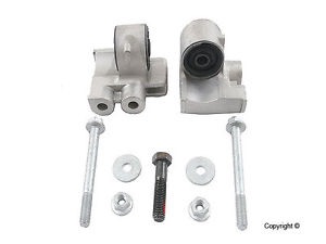

Anyone have a good write to to change the trailing arm bushings on a Volvo 850

Point to remember -- take a picture as the links can be installed upside down- you will notice when you try to install the second one- pray that the bolts aren't seized in place, if so you will need a sawzall to cut them out- easier if you undo both trailing arm ends and drop the whole shebang- the brake lines give enough slack for this as do the abs wires

I did both of mine a few months ago. No pictures that will help much. Passenger side is easy. Drivers side takes a bit more coaxing. I soaked everything in PB the night before....no issues with seized bolts. Only used 6pt sockets which is key.

I actually ended up dropping the whole back. Not too bad of a job. No bolts seized on me. I reassembled every nut & bolt w/ anti-seize and loctite. Got the alignment the very next day. From what i was told, the rear camber has no adjustment recommended from manufacturers. Is this true ?

The threads on the actual trailing arm inboard, the long bolt that goes into the arm through the 3 bolt hole bushing housing.
