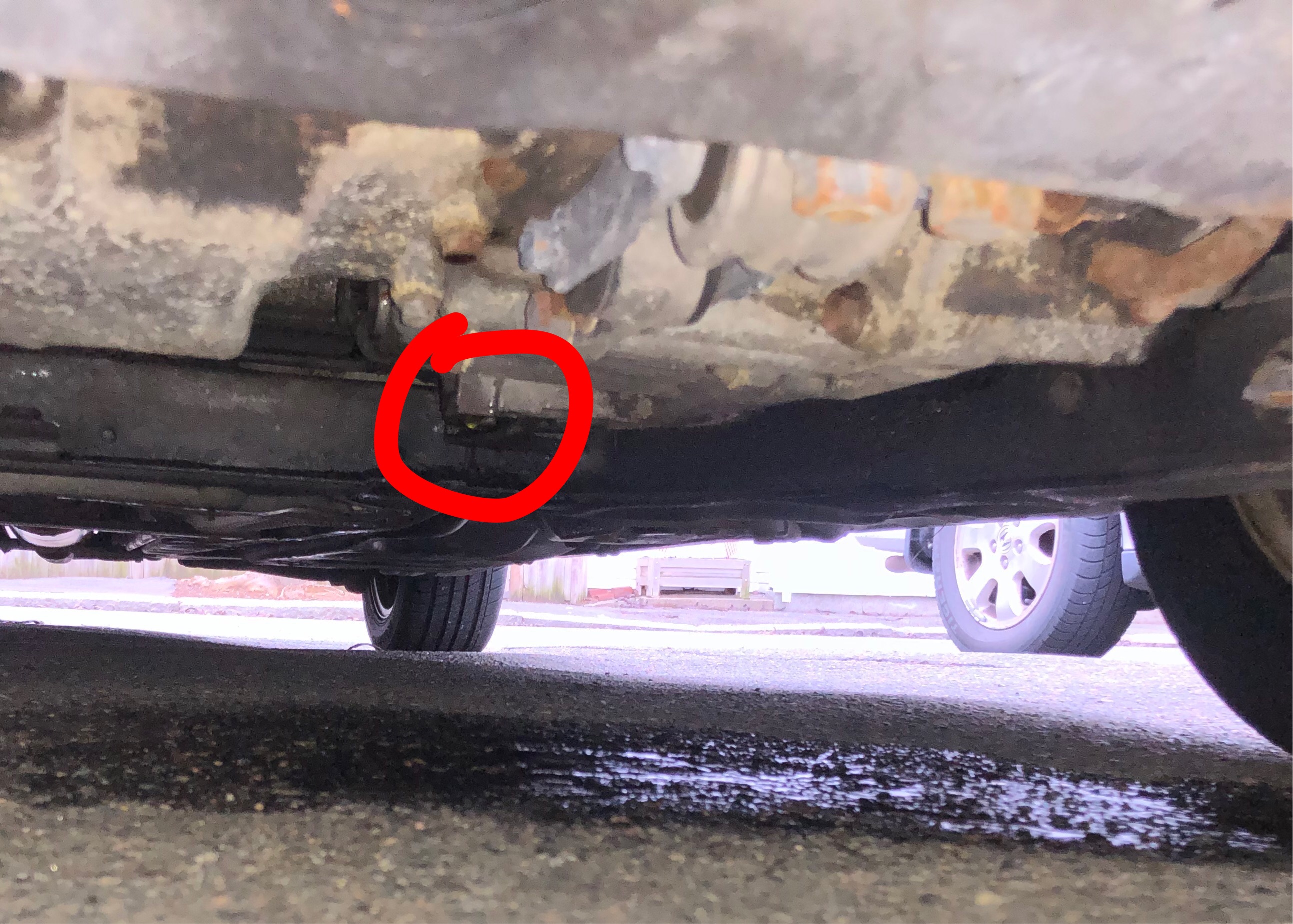

Also, not sure if I should put this in a separate thread, or how directly related it is to the problems above, but I also saw, for the first time ever, some coolant pooled on the ground towards the rear of the transmission. I am not sure of the source of the leak, but it was dripping from the rear of the transmission). I have never had a coolant leak or seen coolant pooled in this area before. It seemed to show up after I had been running the engine for a while, then switched the heat on as the ECT temperature had reached 205F. I'm just wondering if this is a symptom of the coolant being hotter than normal, and perhaps pressure seeking another outlet after having replaced the coolant reservoir cap and tightening it down more securely than previous. Photo below:
