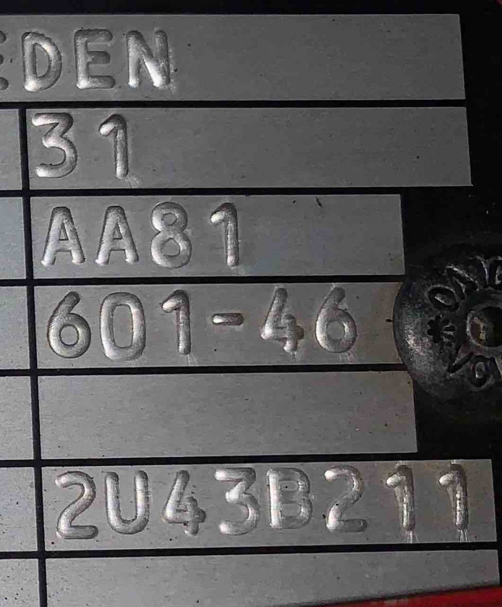

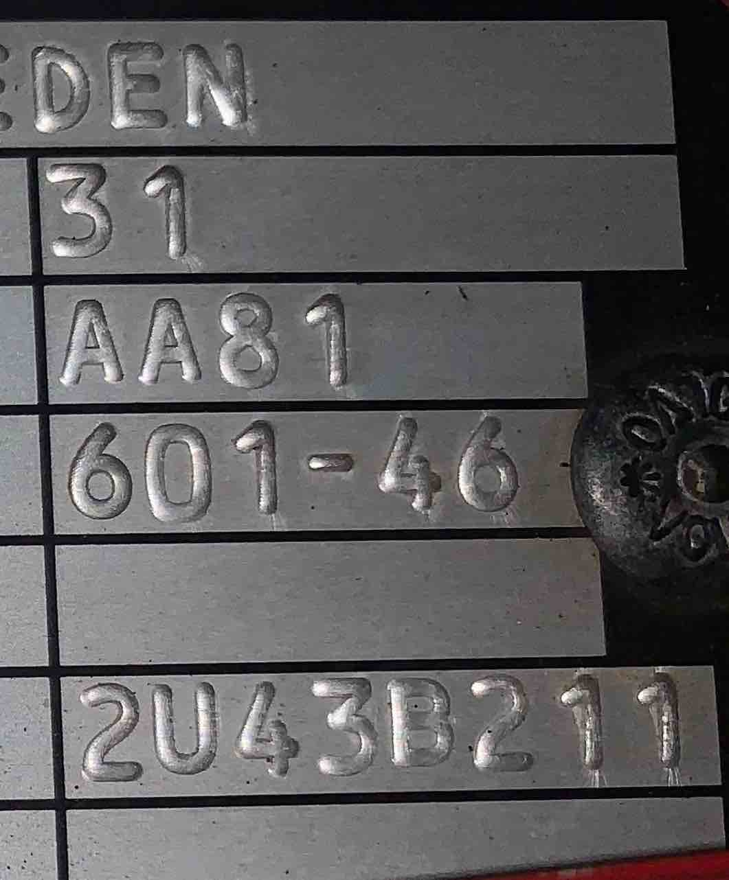

the plate says AA 81 - a light camel tan.
31
AA81
601-46
31
AA81
601-46

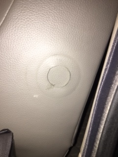

This is what you'll end up with if you put a passenger side skin on the drivers side, the lumbar hole hides behind the seatbelt and B-pillar, completely imperceptible. My side bolster was ripped and worn and the base was split so I had to change the seat base and back skin.
