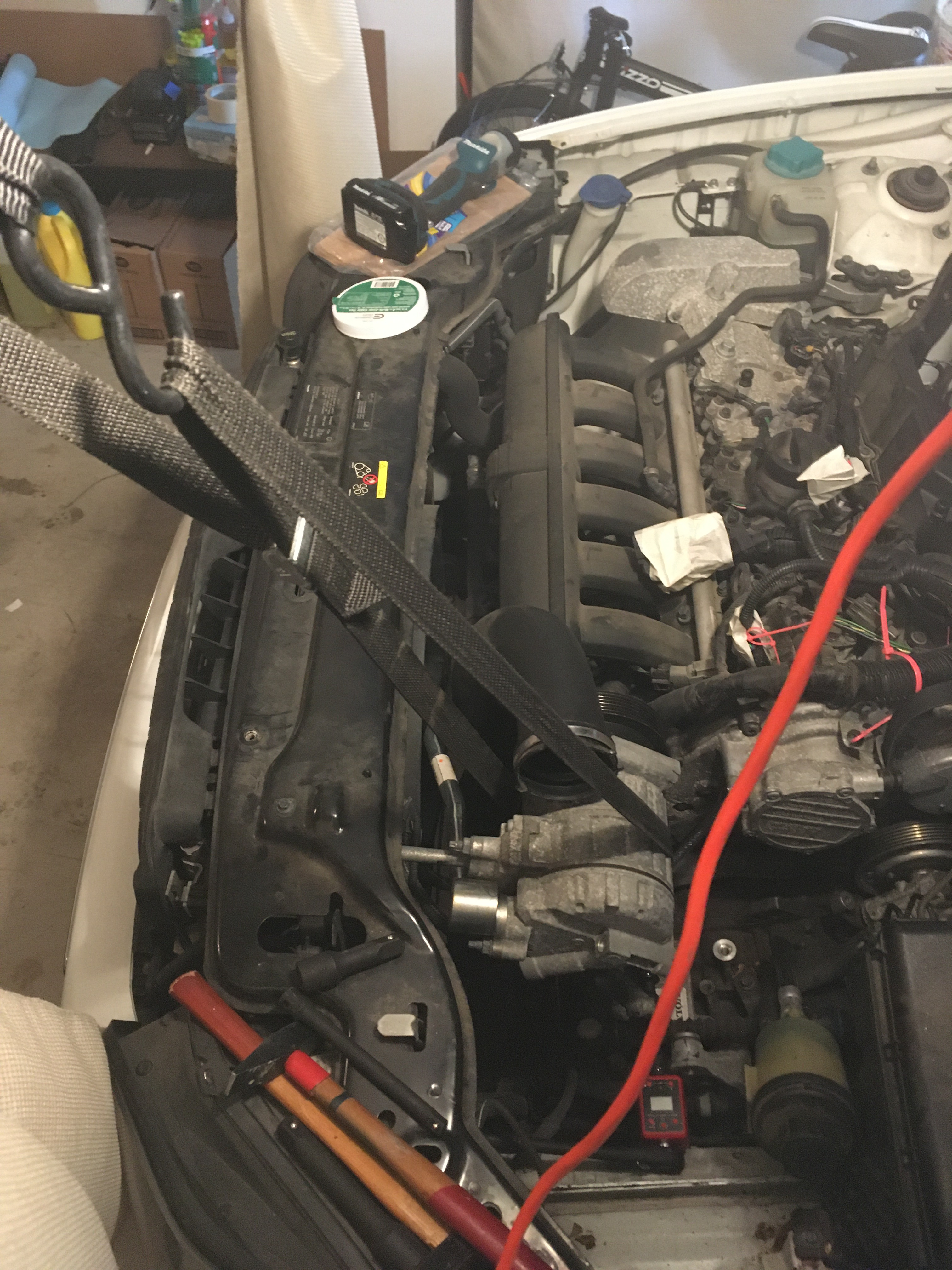

So as an encouragement to everyone who wants to try it. Just finished today the same job on our second Volvo. This time it took me proximately four hours. So it is definitely doable. Can just reiterate how useful it is to lift the AC compressor out of the way.

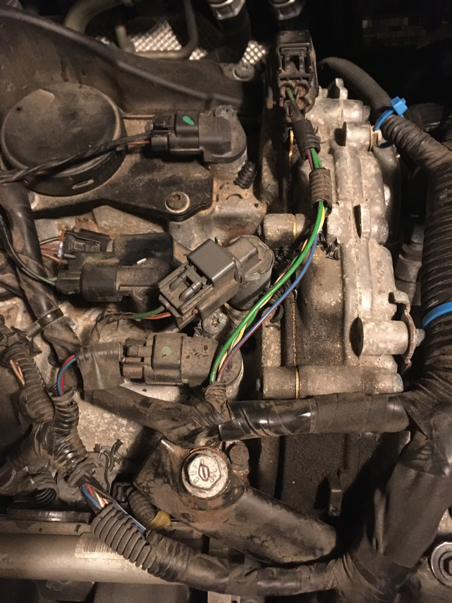

I just purchased a high mileage xc90 and trying to figure out if somebody was able to put back the ac bracket without the alignment jig. The jig is around $150 for 1 item use :(
the serpentine belt on mine disintegrated and destroyed the idler and tensioner pulleys, I made a stupid mistake of taking out the ac bracket without making alignment marks (I didn't realized that an alignment jig is needed)
if somebody can loan it for me, i'll pay shipping and I'm in Kansas City.

Post by toolpusher »
I did the job on two cars.
On the first one I forgot to put marks, but when putting it together there was no play that I noticed in the bracket that would allow any alignment.
Now for the second job, I marked each and every screw and joint, but it turned out when I put everything together, as soon as torquing up, the bracket just slips in that one original position and all the marks line up perfectly without any alignment.
So I’m really wondering what this alignment tool is needed for.
