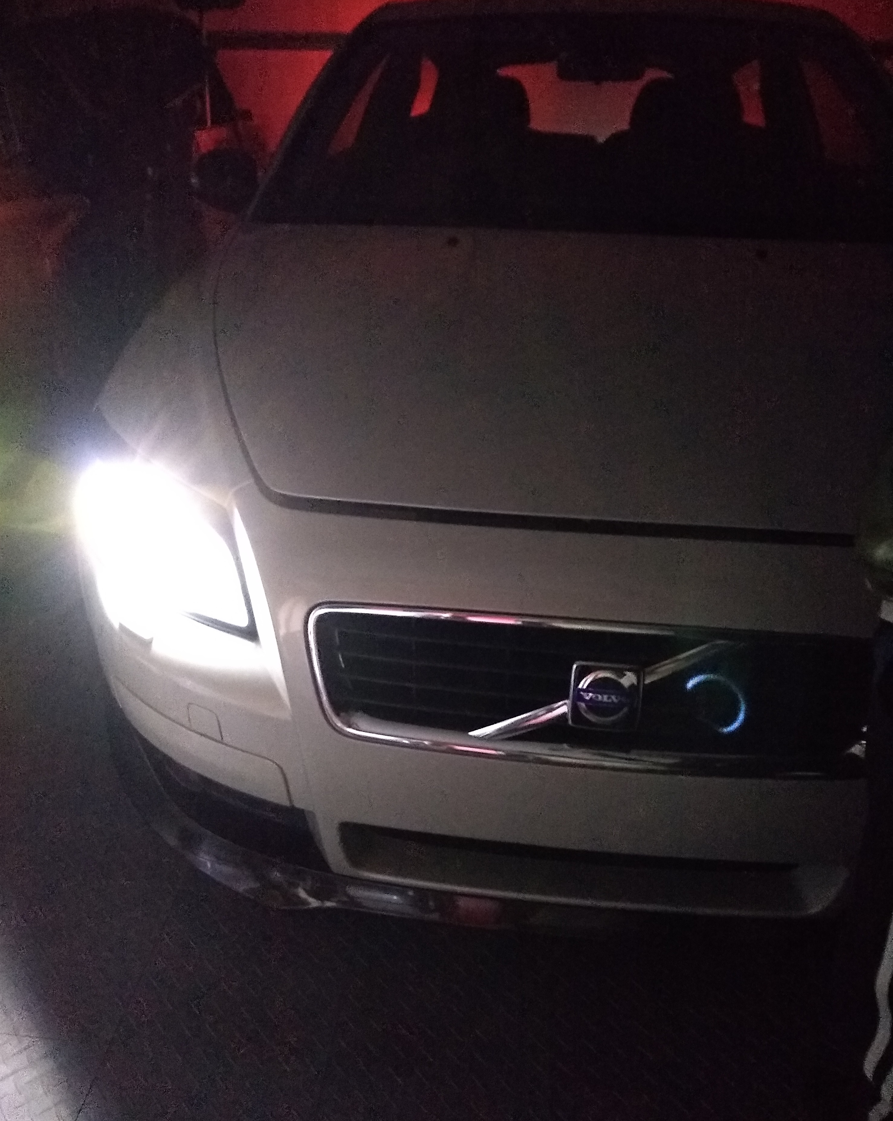

Hi, the little P1 wanted to show the P2 big boys something that might work for them also.
Bought some less than $30 eBay Angel Eyes and thought we could just attach it to the front of Bi-Xenon lens assembly and reinstall. It was too thick and pushed the front round cover off so we decided to attach it to the front of the cover instead. Was debating on the oven or heat gun. Decided to give the heat gun a try as preheating the oven would take too long and we felt there maybe more control of the heat even though the oven would have better even heat distribution.
It took less than 10 minute but it really did seemed like a lot less time. Sat the headlight assembly on a microfiber towel and slowly rotated it around while heating at 750 degrees from about 1.5 inches away. Son held the temp gun to check the temp rise around the heated areas. At around 170 to 180 degrees we decide to pry it open and it worked.
Use a putty knife first, butter knife second then the two Volvo bone tools and lastly a flat head to keep the areas opened from closing. No where close to how difficult we thought it would be. After opening we used bared fingers to push the sealant back into the groove. When closing up we just press the lens back on, reheat and pressed till the 4 clip could be reattached. We did continue to heat the sides and further press the edges of the lens face down on the table with a microfiber for a couple of minute to make sure the assembly was fully seated.
We tried several different light settings on the camera. It is really bright.
