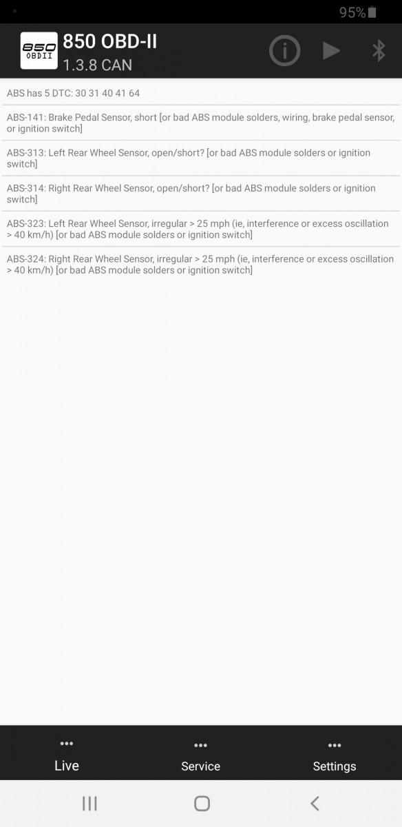

The last time I ran ABS codes this is what the app told me. Its suggestive to me that maybe the module is bad.
