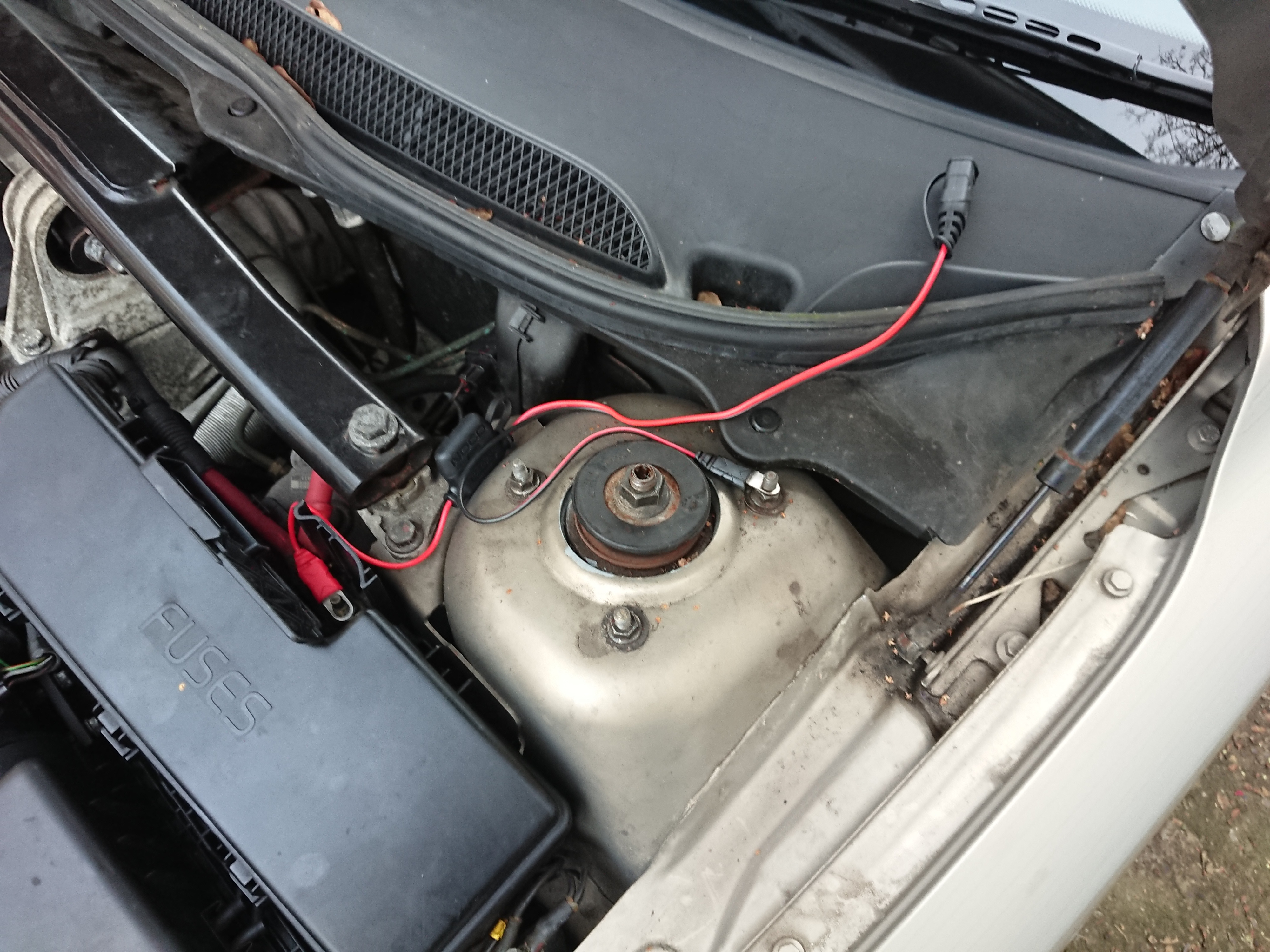

I'm looking into how to maintain my battery
s-l640 (1).jpg (53.69 KiB) Viewed 1893 times
this is my plan is it a suitable and safe way of trickle charging I don't want to cook any modules by trickle charging this way
It means I can fully lock the car and leave the charging cable protruding from under the bonnet all the time.

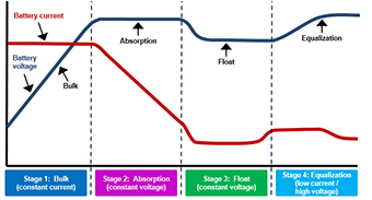

You want a Float charger rather then a Trickle charger. Both are low current chargers but the Float charger will reduce the voltage to keep from damaging the battery after it is charged. A battery maintainer is a low current four stage float charger.
A Trickle charger does not have stages 3 & 4. It stays at stage 2 and will cook the battery if you leave it hooked up.
Stages 1 & 2 are the charging cycle, 3 & 4 are the maintaining cycle. A battery maintainer will switch between stages 3 & 4 as needed.

I use a similar charger for my '02 v70 - it has a 5 stage charging cycle:
https://www.amazon.co.uk/Maypole-7423A- ... 75&sr=8-15
I would recommend connecting the charger to the battery in the boot to be safe.
You will probably be ok connecting where you have but it's riskier as all the current has to travel across to the other side of the car, who knows what modules etc it goes through.
