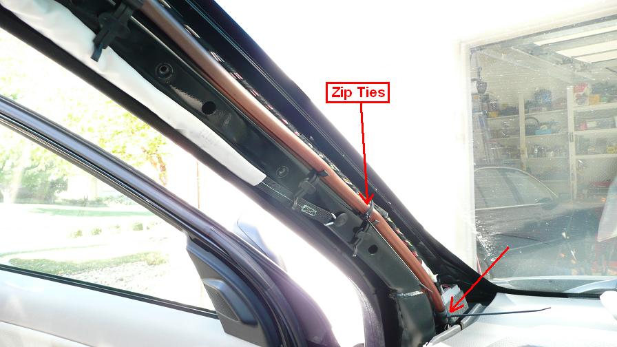

DIY 2005 XC90 Sunroof drain maintenance
Old topic but once every 10 years, I'd clean this drain tube to prevent overflow of water inside cabin, causing expensive damage. Very very easy thing to do.
About 10-15 min per side.
TOOLS:
- Small screwdriver
- 8-mm socket and extension
- Zip ties (optional)
PROCEDURE:
1. Pry the tab off, and remove the 8-mm bolts.
2. Drain Tube drains into Rubber Elbow:
3. Not sure why the Rubber Elbow has flaps to restrict flow (my BMW X5 has the same design!!!). I cut diagonally to increase flow. Whatever you do, during installation, make sure the Rubber Elbow fits properly (pay attention to the flange that sits inside the car round hole).
Tug the Rubber Elbow a bit, it should not come out.
- Take this opportunity to blow air upward (I guess you can use your mouth but clean the Drain Tube end first!), there should be no flow restriction.
4. I put 2 Zip Ties (optional) as shown to prevent the tube from coming off the Rubber Elbow.
5. During re-installation, make sure the Black weather strip sits on top of the White Trim.
When in doubt, look at the other side for advice!
6. The other side (R side), well the P.O. already did it, so I just reinstalled it back.
Easy Peasy...

cn90 wrote: 18 Oct 2015, 10:42 DIY 2005 XC90 Sunroof drain maintenance
TOOLS:
- Small screwdriver
PROCEDURE:
Easy Peasy...
