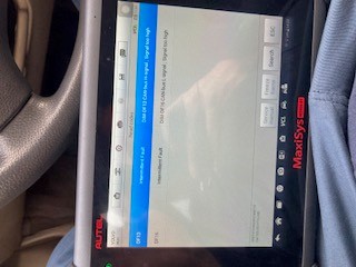

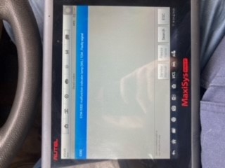

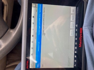

Hey all I have three questions. I put a 2001 t5 engine into a 99 v70 originally a lpt . I have ironed out most of the stuff....
I keep getting the ecm code 530D malfunction indicator lamp (mil) faulty signal
I keep getting the tcu codes 0023/0087 the permanent one is engine speed (RPM) sensor Signal missing
also i am getting df 13 and df 16 DIM can bus h signal too high and can bus signal too low..
any input will help. I have tried changing the transmission speed sensor.
somewhere I read that I need to change both external sensors on transmission and I dont know where the other one is or what it is so please feel free to explain that as well.
pictures attached below.
please help p80 woes

- Posts: 36147
Put each chassis into the volvowebstore.com engine and pull up part numbers fit each sensor; they need to be the same

Does your check engine light light up in position 2 before you start the car?
S60UT
- Posts: 64
- Joined: 14 Jun 2017, 14:31
- Year and Model: 2000 V70R
- Location: Tennessee
- Been thanked: 4 times
I installed a 01 T5 into a 00 S70 LPT.
I didn't have any issues with transmission sensors. Just had to get the ECU tuned for the bigger turbo and injectors. I did see a MIL communication issue in Vida, but i don't have a CEL. Did you get the ECU tuned ? If so, did tuner mess with the torque limiter ?

I have not gotten it tuned. who would do it in Utah? also the CEL is on in position 2 as well as the up arrow for the transmission is blinking.
Robertmac100029
- Posts: 5
- Joined: 10 Jun 2019, 19:01
- Year and Model: 1998 s70
- Location: Utah
the transmission is not from a 99 either..
S60UT
- Posts: 64
Nobody in Utah. I had it done through Rolling Motors in CT. People recommend VAST tuning also. You need to get it tuned. Makes a big difference. Im boosting to about 15psi. I think its actually faster than my R.
