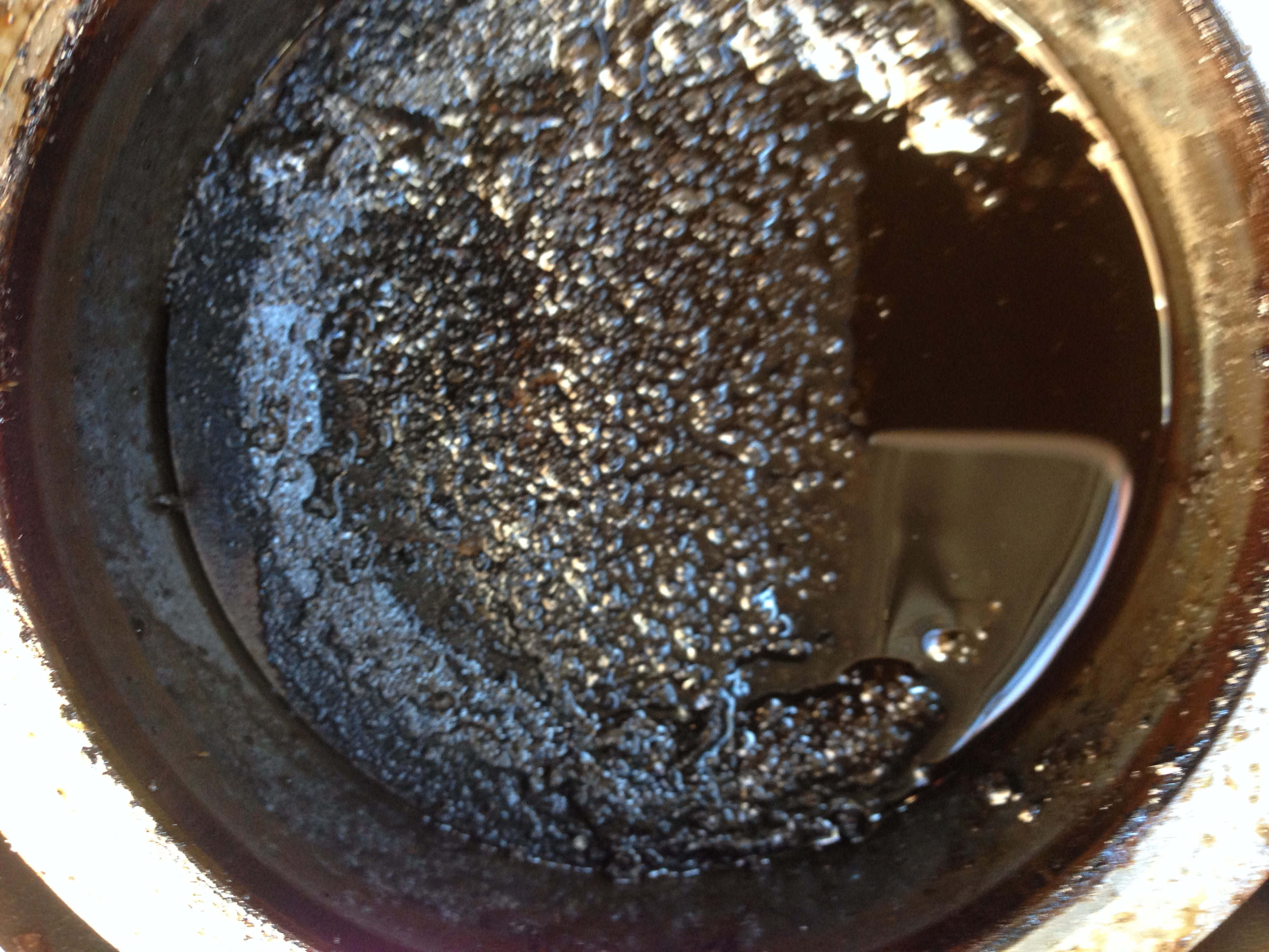

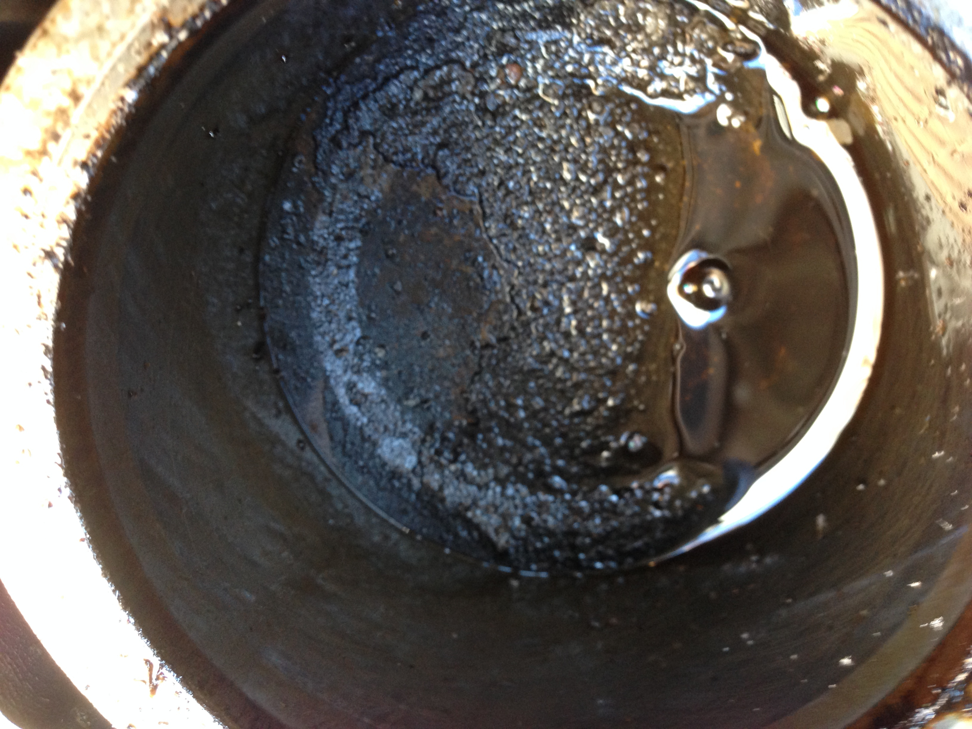

If you think it maybe carbon build up.
1. Pull the Spark plugs.
2. Pour some Seafoam additive in each cylinder to flood the top of each piston.
3. Stuff rags down each Spark plug well.
4. Let sit overnight.
5. Crank engine to push out any liquid Seafoam.
6. Reinstall spark plugs.
7. Start engine and let it idle until it stops blowing black carbon out the tail pipe.
8. Drive the car until a hard acceleration no longer blows black carbon out the tail pipe.
Notes: If the cylinders are as bad as suspected, expect thick black smoke out of the exhaust. It can take 20, 30 .. 45 + minutes of idling for the carbon to clear up.
If you want to get the Combustion chambers free of carbon also. Remove the Cam cover which will close all the valves. Then in step #2 flood the cylinders to the bottom Spark plug threads. After step #4. Reinstall Cam cover the do steps 5-8.
Modified procedure to clean Combustion chambers also.
2. Remove Cam cover.
3. Pour some Seafoam additive flooding the cylinders to the bottom Spark plug threads. .
4. Stuff rags down each Spark plug well.
5. Let sit overnight.
6. Reinstall Cam cover, timing engine in the process.
7. Crank engine to push out any liquid Seafoam.
8. Reinstall spark plugs.
9. Start engine and let it idle until it stops blowing black carbon out the tail pipe.
10. Drive the car until a hard acceleration no longer blows black carbon out the tail pipe.

It’s just a collection of solvents and organic chemicals. It won’t attack metal on the short timeframe of an overnight soak
You need quite a bit to cover the piston tops as I found during my cylinder head job, the pistons are angled back to the rear, or right side of the engine , so liquids will pool there.

If it ate metal Seafoam would be long gone and buried under all the lawsuits for damages.
Seafoam is Pale oil, Naphtha, and Isopropyl Alcohol (IPA).
Seafoam eats the Carbon on the rings not the rings. If a engine is so far gone the Carbon is the only thing holding it together. It would start burning oil after a Seafoam treatment. Sound like you been reading postings from idiots that screw up then blame others.
