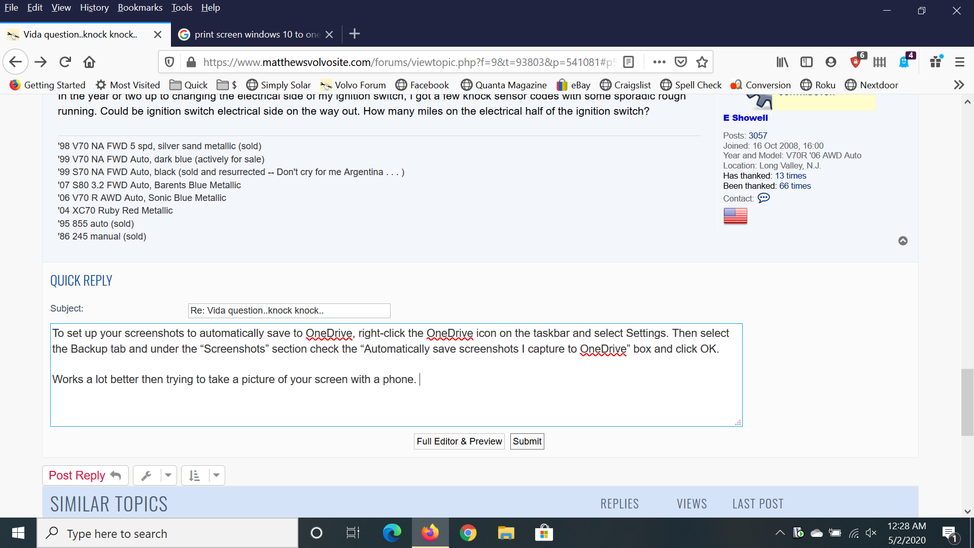

To set up your screenshots to automatically save to OneDrive, right-click the OneDrive icon on the taskbar and select Settings. Then select the Backup tab and under the “Screenshots” section check the “Automatically save screenshots I capture to OneDrive” box and click OK.
To take a Screenshot use the [PrntScrn] key.
Works a lot better then trying to take a picture of your screen with a phone. Less work then cut and paste from the clipboard.

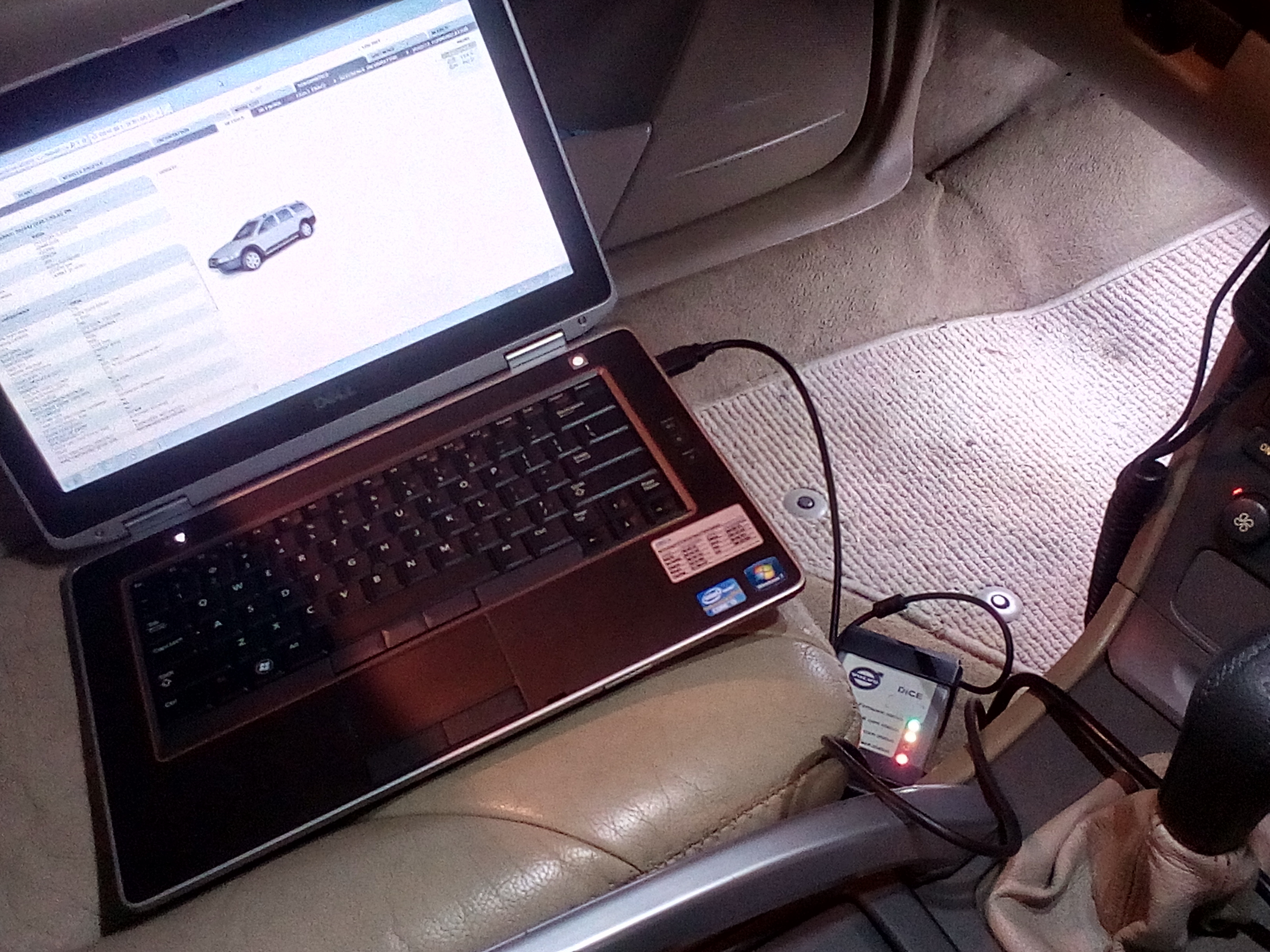

On a related topic, I don't see the Volvo DICE sold on ebay any longer.
If you go to ebay and enter "Volvo DICE", the usual device (shown in the photo in the 1st thread above) is no longer sold on ebay.
The DICE was usually on sales for about $75-$90 or so.
Here is an example of the search result:
https://www.ebay.com/sch/i.html?&_nkw=v ... e&_sacat=0
