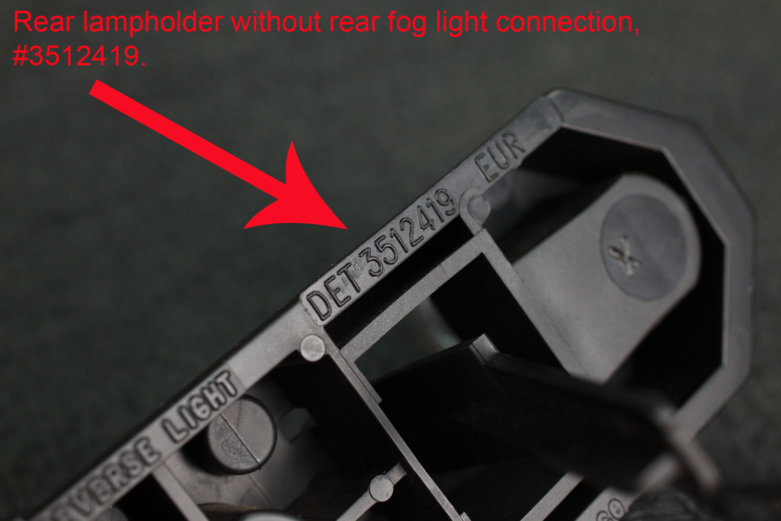

This only came to light just now because I went to search for a solution to another problem... So, here are the belated snaps, newly annotated. For your information, the lower, rear lampholder part numbers are;
#3512418 = with rear foglight circuit.
#3512419 = without rear foglight ccircuit.
Hopefully, I'll be forgiven.
