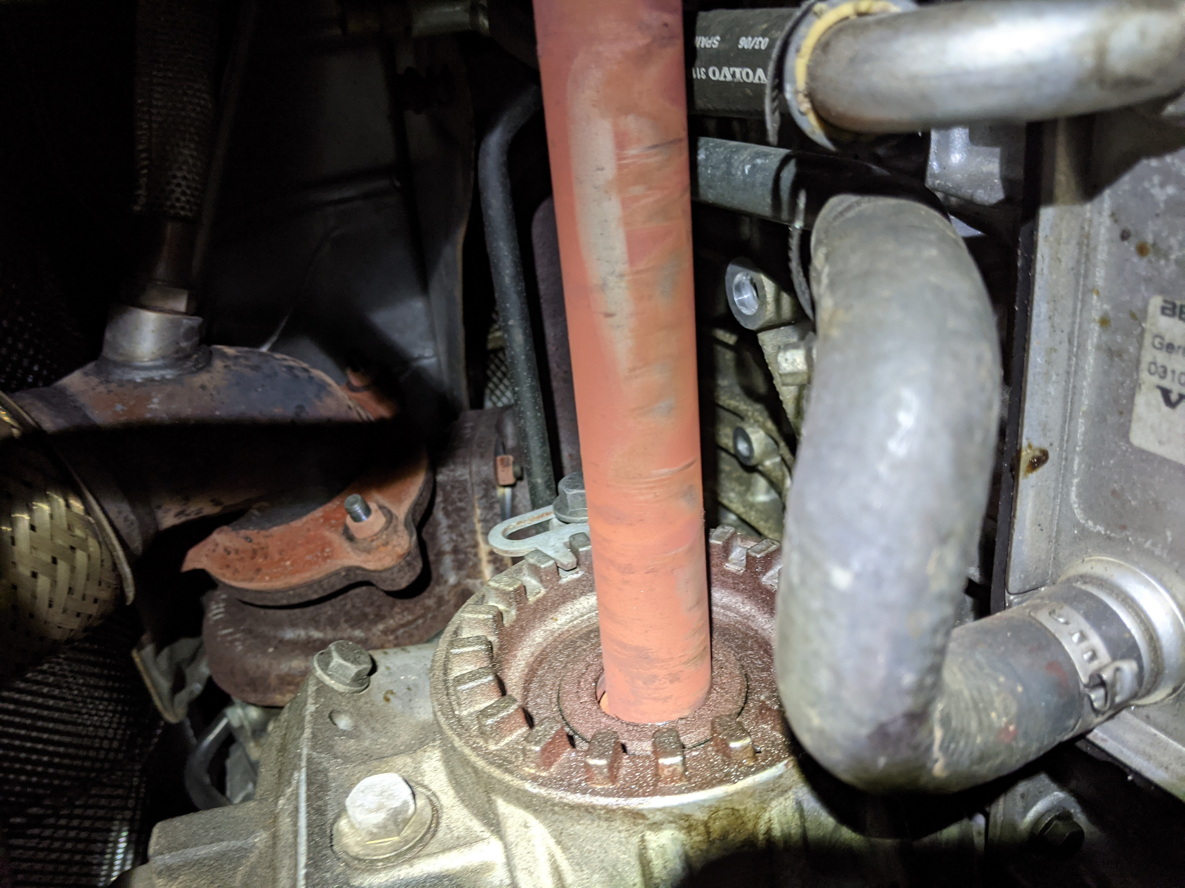

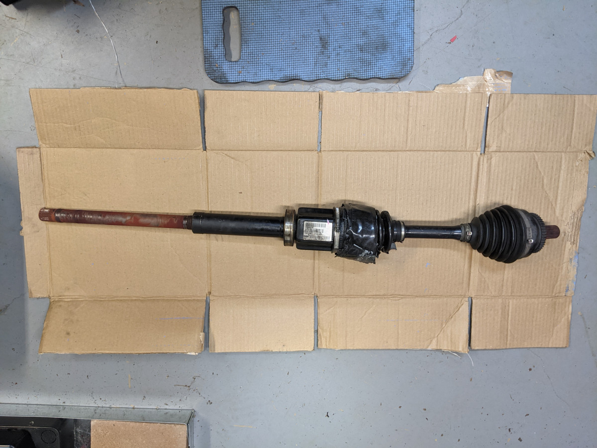

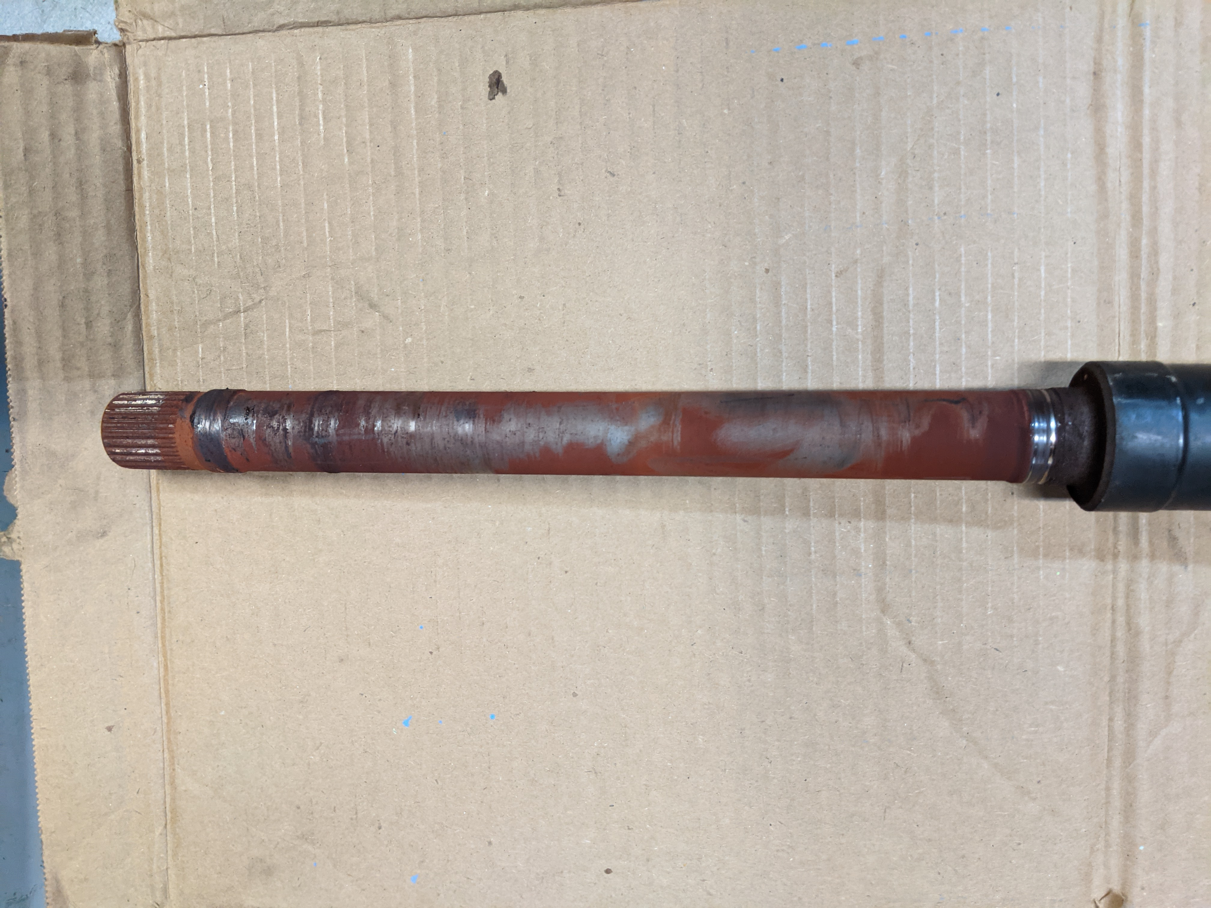

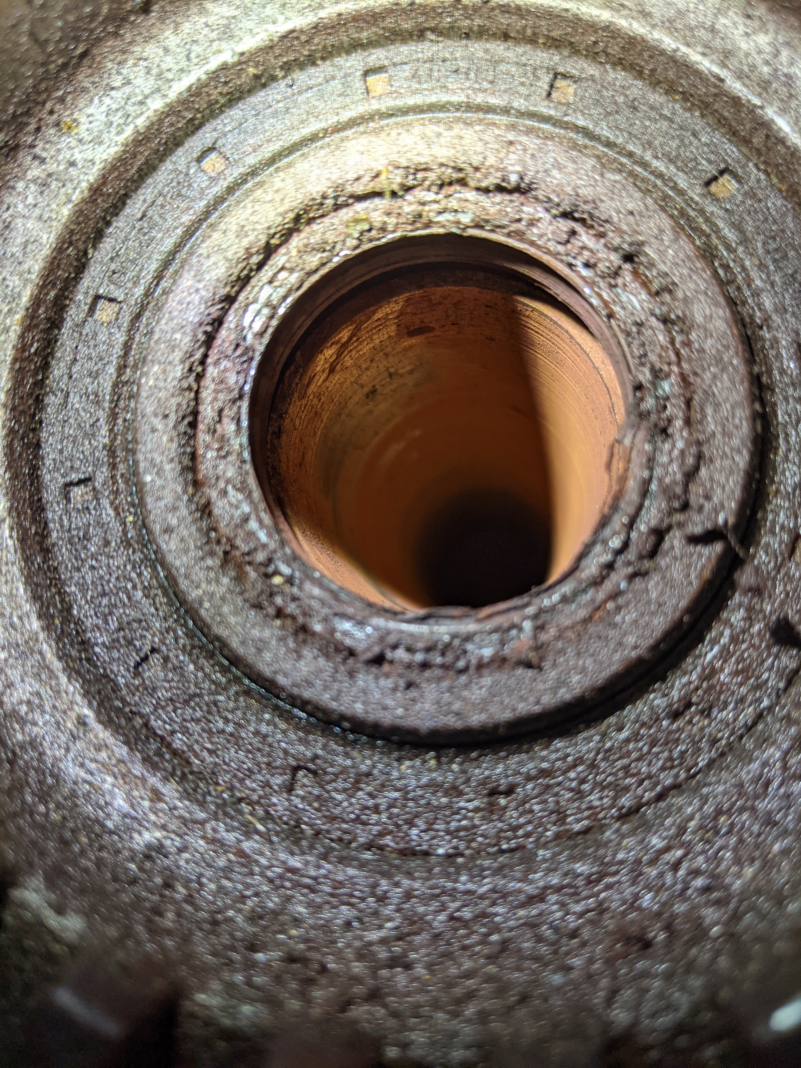

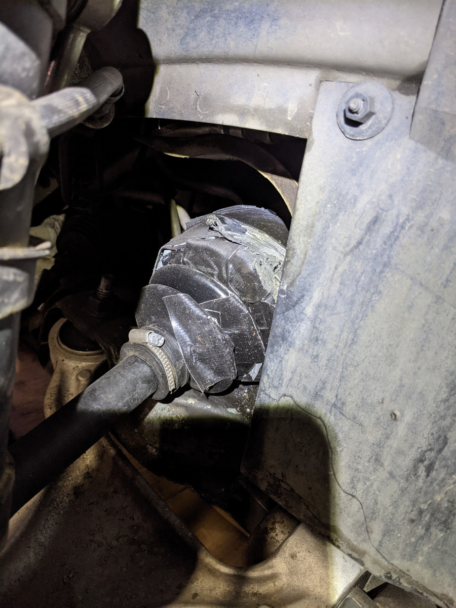

Right this very minute Ben is getting new CV boots on his passenger side. Have any of you ever encountered the dry rust dust (I have no idea what it is) on the inner shaft? I am driving up to Jersey in two weeks. I don't need any more stressors!

Yeah, that rust is common, same on the driver's side. The axles go into a dry female spline on the transmission. It's also dry where it goes through the angle gear. You might want to put some grease on the splines when it goes back in.

Awesome, thanks. I got it to where you see in the pictures. I couldn't find the clip people were talking about and I was starting to get hangry so opted to leave it to revisit later.
The Bav Money Waster's headlights flicker, remember (probably a ground issue somewhere)...so I opted to leave to get home by dark. Right now the mood is waffling between buying a whole new driveshaft from FCP and trying to find a good video that's applicable to my car to help me out. Food first before I get in trouble with my grumpiness.

You will be ok with that driveshaft, it’s holding grease in so it’s not letting water In.

I hear ya, gotta figure out how to disassemble it to put the new boots on though.
