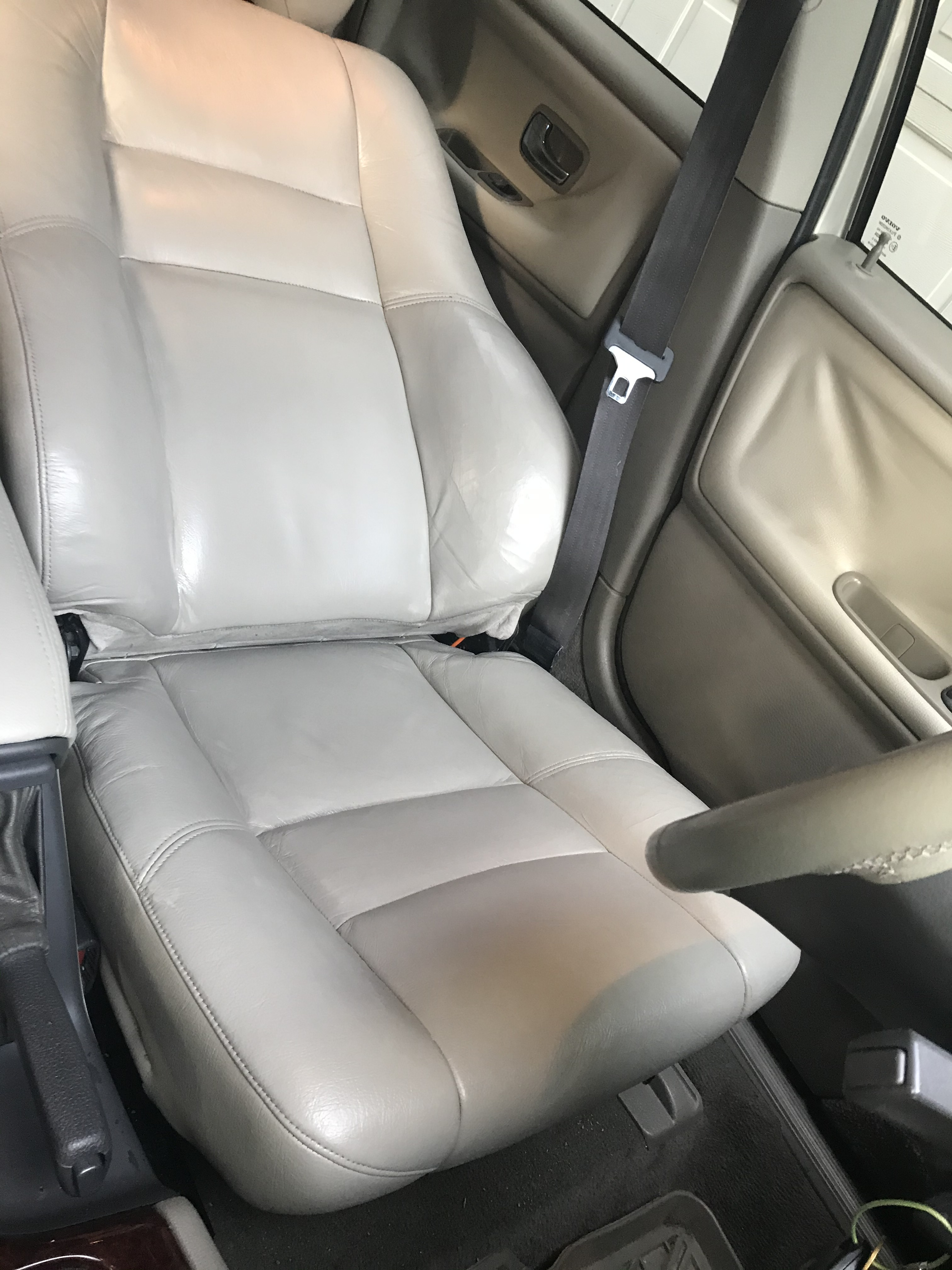

Just get it matched at Home Depot, about $6, you don't need spray. Get the best paint they have, Behr Marquee in the sample size. I used a cleaned rear seat base and the match was perfect.
To match sand for plastic covering in an S60, I cleaned up one of the door sill trim pieces to use as the match. Excellent results. Or probably the back of a panel, it's going to be original.
Here are before/after pics of the interior of my 2000 XC. You can use it on interior plastic panels or seats/etc.
I posted the whole process here:
https://www.swedespeed.com/threads/cent ... oo.639602/
I got the original idea for this a year ago from a post on Volvoxc.com. I modified it w/things I learned from furniture repair blogs/websites, etc. It works very well and is cheap, just takes some labor.

Oro, thanks for the link to your thread. Seats turned out really nice. Have you tried the same paint technique with the plastic parts and vinyl parts around the door cards and dash areas? I assume you brushed on your color and that might not end so well for the plastic and vinyl. I did order a SEM color chip card so I could look that the colors more closely instead of guessing.

Yep, I did a panel in the S60, and I have others still to do. I just brushed it on with a sponge brush and it looks perfect. I haven't done all the other panels. I'll try to take a picture of it for you tomorrow, but it works great.
This is a very high-end acrylic latex, so it dries hard, and it dries flexible. Just what you want. A different league than cheap latex wall paint.
I have some panels on an XC70 door card I need to do. For that I got a spray because they are such large, flat, smooth surfaces. Will do that next week or so. For smaller areas, or textured thinks like the center console panels, brushing is a-ok. The quality paint makes a difference - it levels as it dries and there are zero brush marks. The Behr Marquee might be ok on the door cards, but since I don't care if it's a shade or two off (they already are), I will go with spray.
