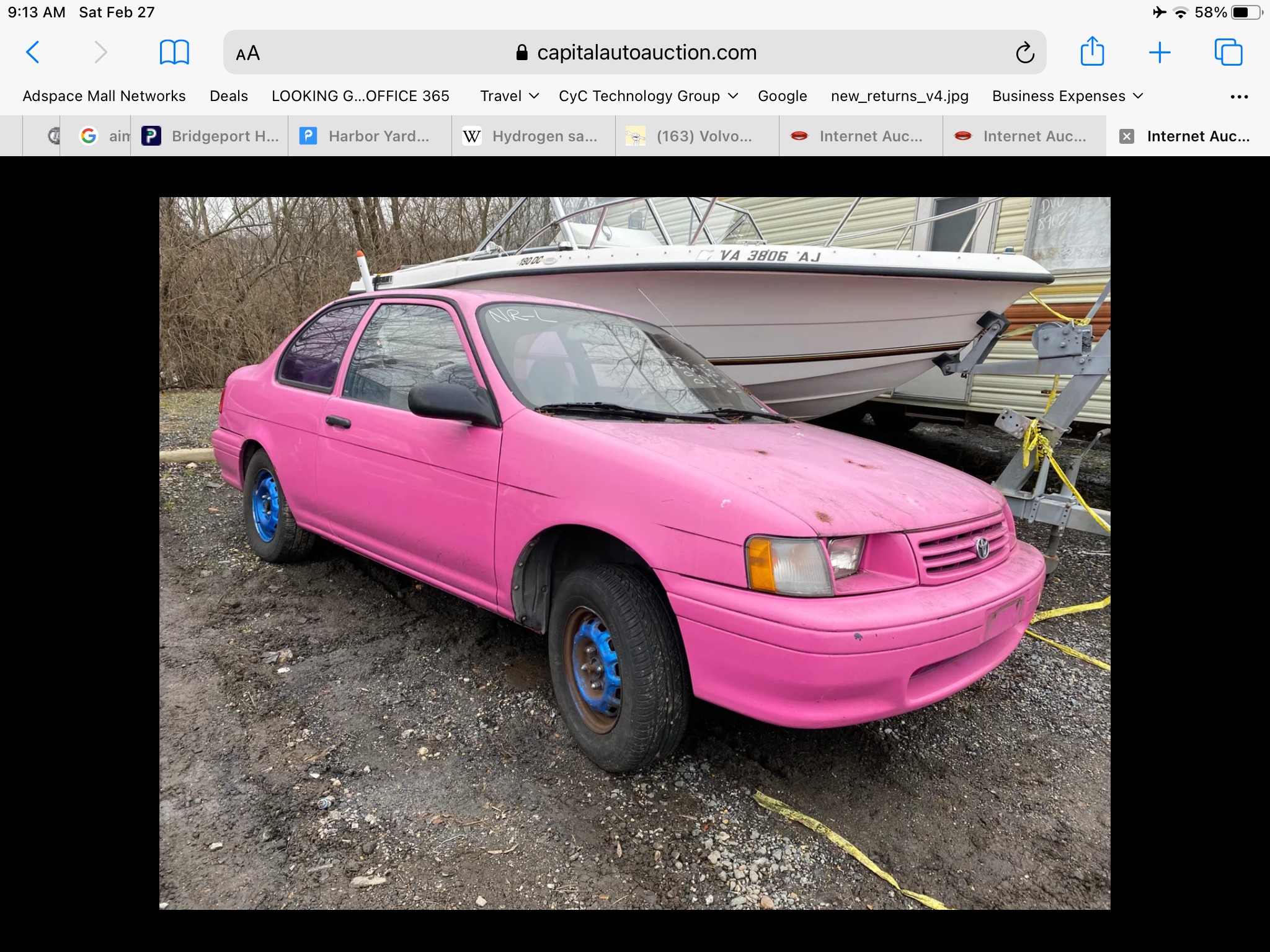

The progression is
Black wheels, egg crate grills, Miatas, then finally.....
