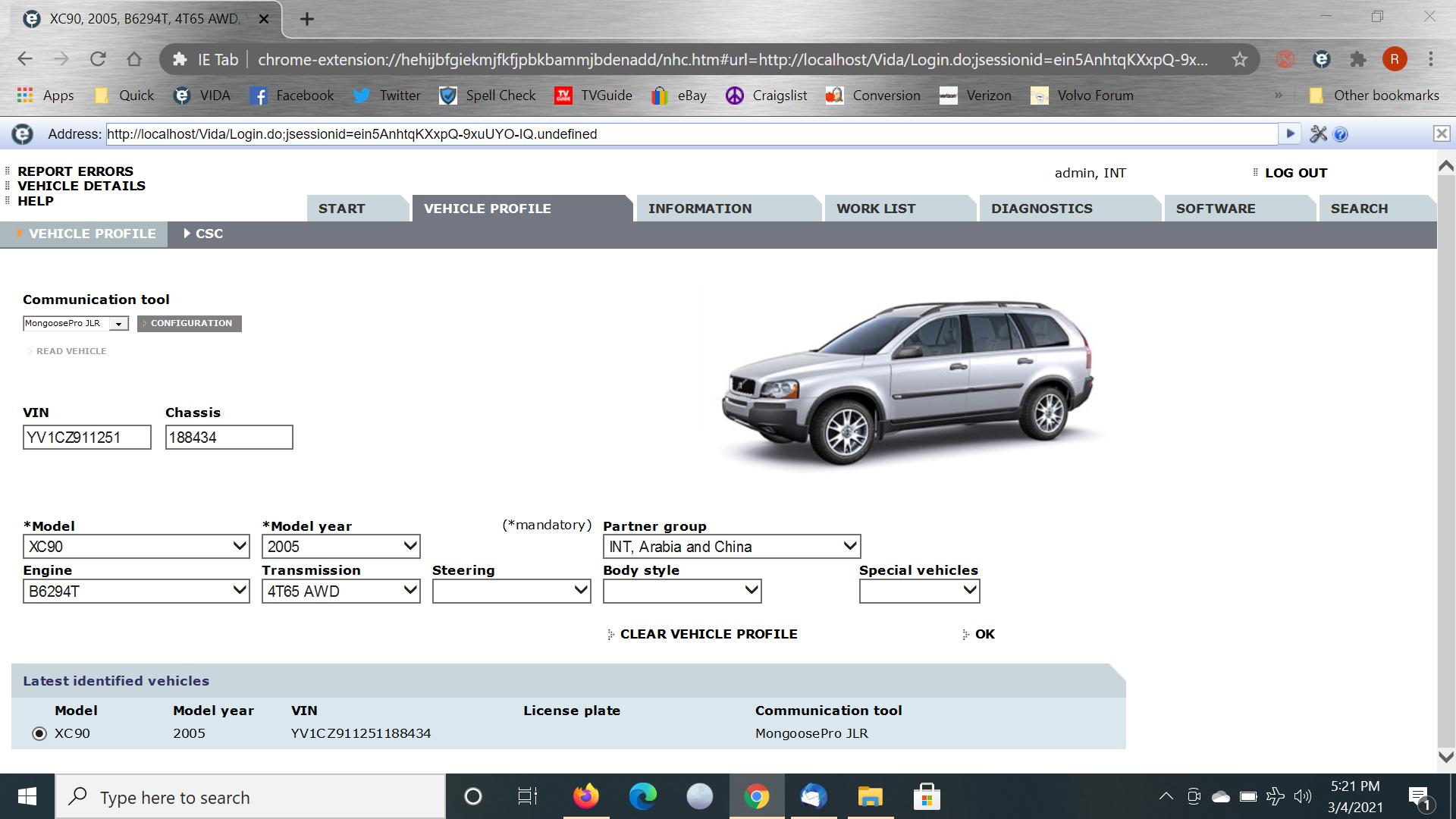

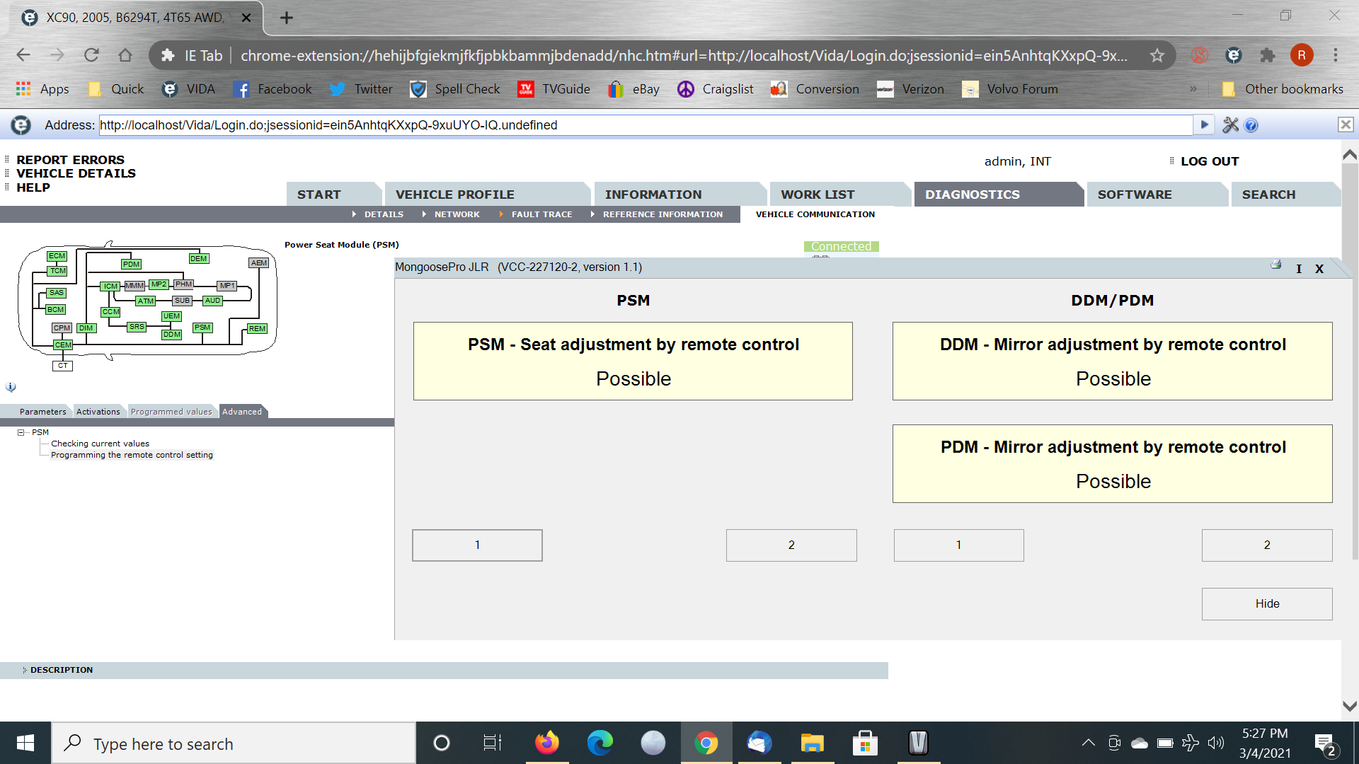

cn90 wrote: 03 Mar 2021, 15:24 From my random reading on the Mongoose J2534 Cable, it is probably OK but there are some complaints on amazon.
There will always be idiots that blame the product.
Some of the sellers on Amazon and eBay pack software that does not work. I always toss the disk and find the software on my own.
I have not played around with it too much but it works on mine. Reads VIN, DTCs, sets software flags.
