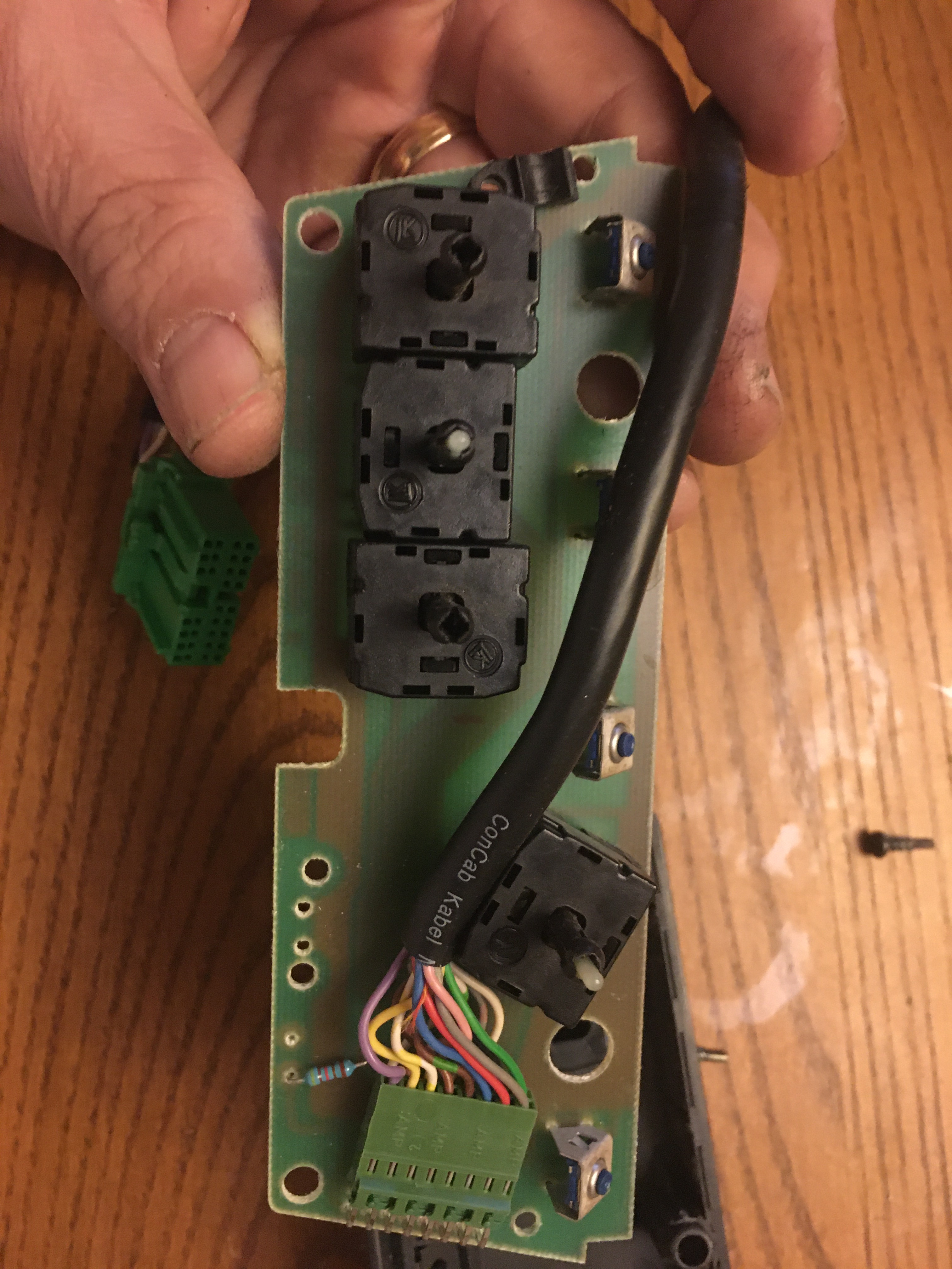

Shaggkira driver seat fore aft has gone out, seat is stuck in fairly close position
This is a problem as Iβm 6 foot 1, and we have girls home who run from 5 feet 2 to 5 feet 14 inches
A single function not working points a bit to the motor, but I pulled the switch assembly first and probably found cause,
Seat switch unclips from seat without tools
Torx T25 allows switch to release from plastic
Philip is screws hold circuit board to switch body
P80 power seat switch troubleshooting , driver side

So resoldering solved the problem?

Update, now I hear the motor clicking but no motion fore aft.

On the 850's that symptom would point to a problem with the cabling, not the motor.
