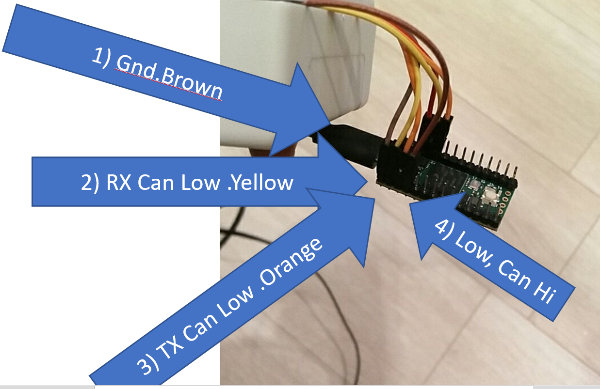

jcdillin wrote: 09 Mar 2021, 11:53 How big is your wire? Do you have CAN HS L direct to pin 2 or to Can RX pin?
from OBDii to DB9 is about 1 meter.
Schematic_Volvo CEM Cracker M_2021-03-09(2).png (35.12 KiB) Viewed 1338 times
vtl
Posts: 4936
Joined: 16 Aug 2012, 13:35
Year and Model: 2005 XC70
Location: Boston
Has thanked: 130 times
Been thanked: 686 times
Post by vtl »
Try rerouting Teensy pin 2 to U1 pin 4 (CAN-HS transceiver's RX pin).
