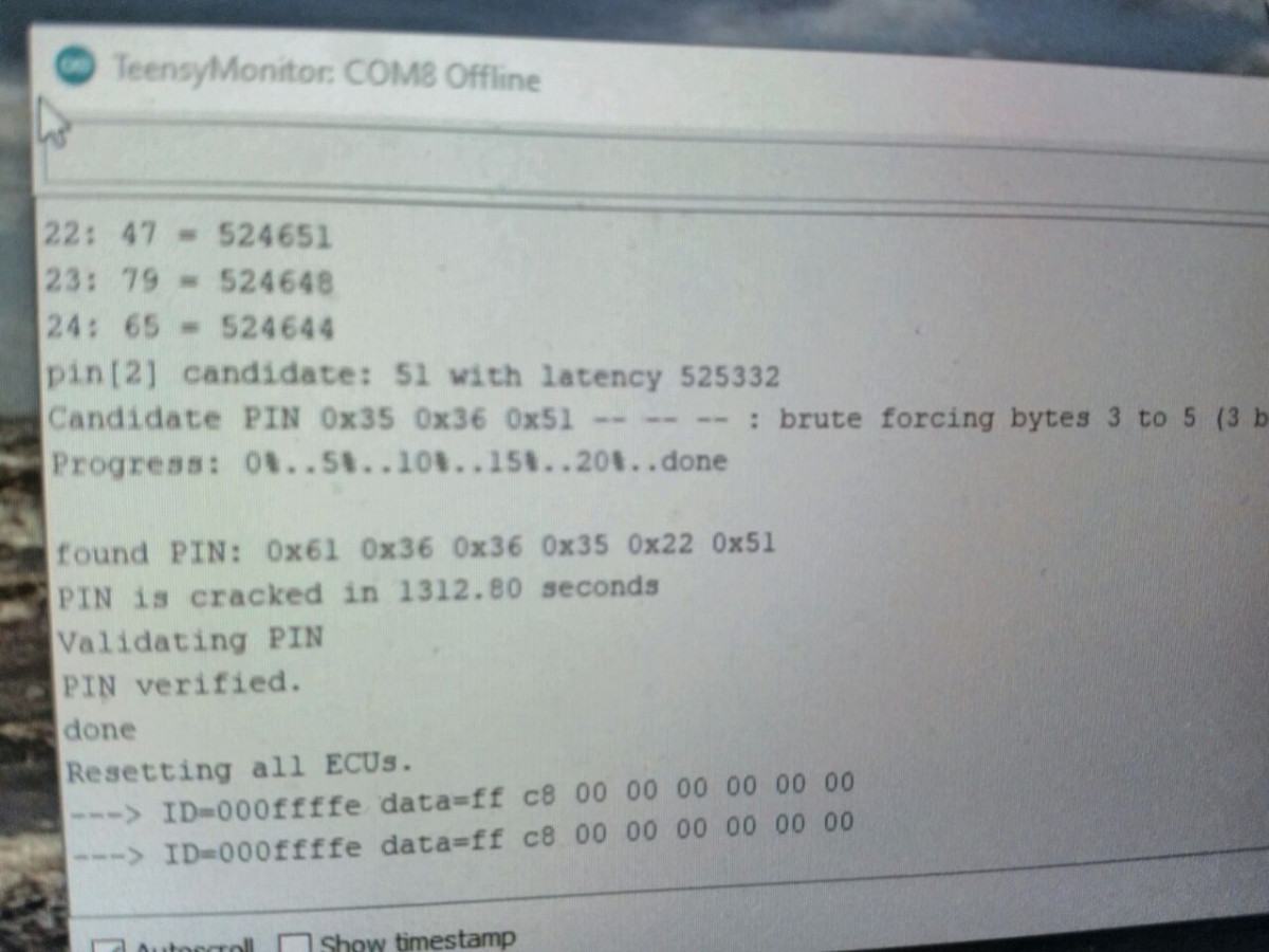

Done using OBDII!
@Vitaliy Thank you very much!
Key position -0
Same wiring as used before. Just used charger for laptop during pin finding.
Code: Select all
CPU Maximum Frequency:   600000000
CPU Frequency:           180000000
Execution Rate:          180 cycles/us
Minimum CEM Reply Time:  30us
Platform:                P2
PIN bytes to measure:    3
Number of samples:       60
Number of loops:         1000
CAN high-speed init done.
CAN low-speed init done.
Initialization done.

Congrats! So it again comes to a wire gauge question (use thick wires) and whether a good source of power is needed (it is needed).
Also I see SAMPLES are set to 60, which also helps to distill the signal in all that noise.

Yeah, I think it's mostly a noise issue in the car.
I emailed D5T5 and they will accept the pin to update to your account for configuration changes. I'm just waiting for them to update mine to see if I can do the manual configuration change in the CEM.

jcdillin wrote: 09 Mar 2021, 13:58 Yeah, I think it's mostly a noise issue in the car.
I also just sent my pin to D5T5 and will share some news after.
I want to add extra key and remote instead of lost one.

MaxDenisov wrote: 09 Mar 2021, 13:34 Same wiring as used before. Just used charger for laptop during pin finding.
Power supply board not enough current capacity?

RickHaleParker wrote: 09 Mar 2021, 15:01
I just thinking that Vitaliy is right, better to have dc/dc converter 12v-5v.
I had some difference/issues because of power supply and long wires
