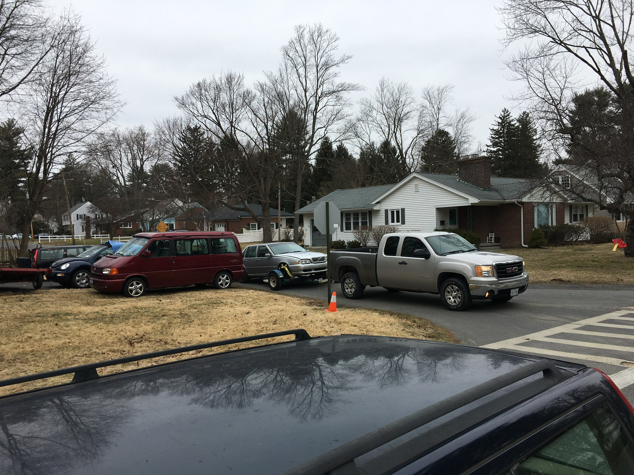

It was a good day yesterday...
Pushed Ekaterina out of the driveway, aired up, put an old battery in to put windows up and open gas flap. My friend Mike came, we dollied up and made the short trip to the lift
Trailered nice at 60,swervy at 70
