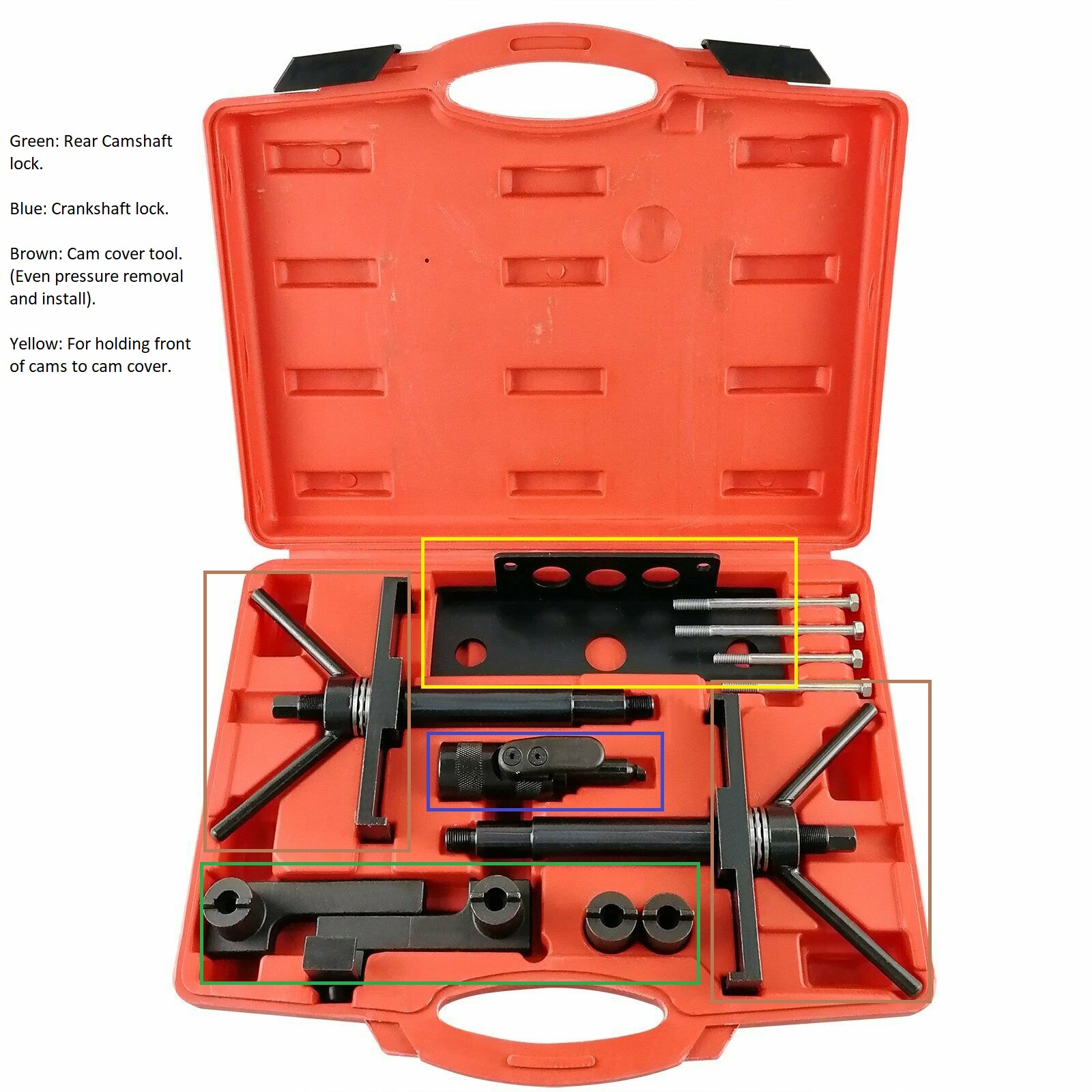

A surefire way is to use the Volvo Crankshaft alignment tool. It is a pin that inserts into a hole in the block, under the starter. Stops the rotating of the Crankshaft at the alignment position. It is included in a Volvo Engine Alignment / Timing kit which go for ~$50.00 on eBay. Most people do not use it because you need to remove the starter to get to the hole in the block.
