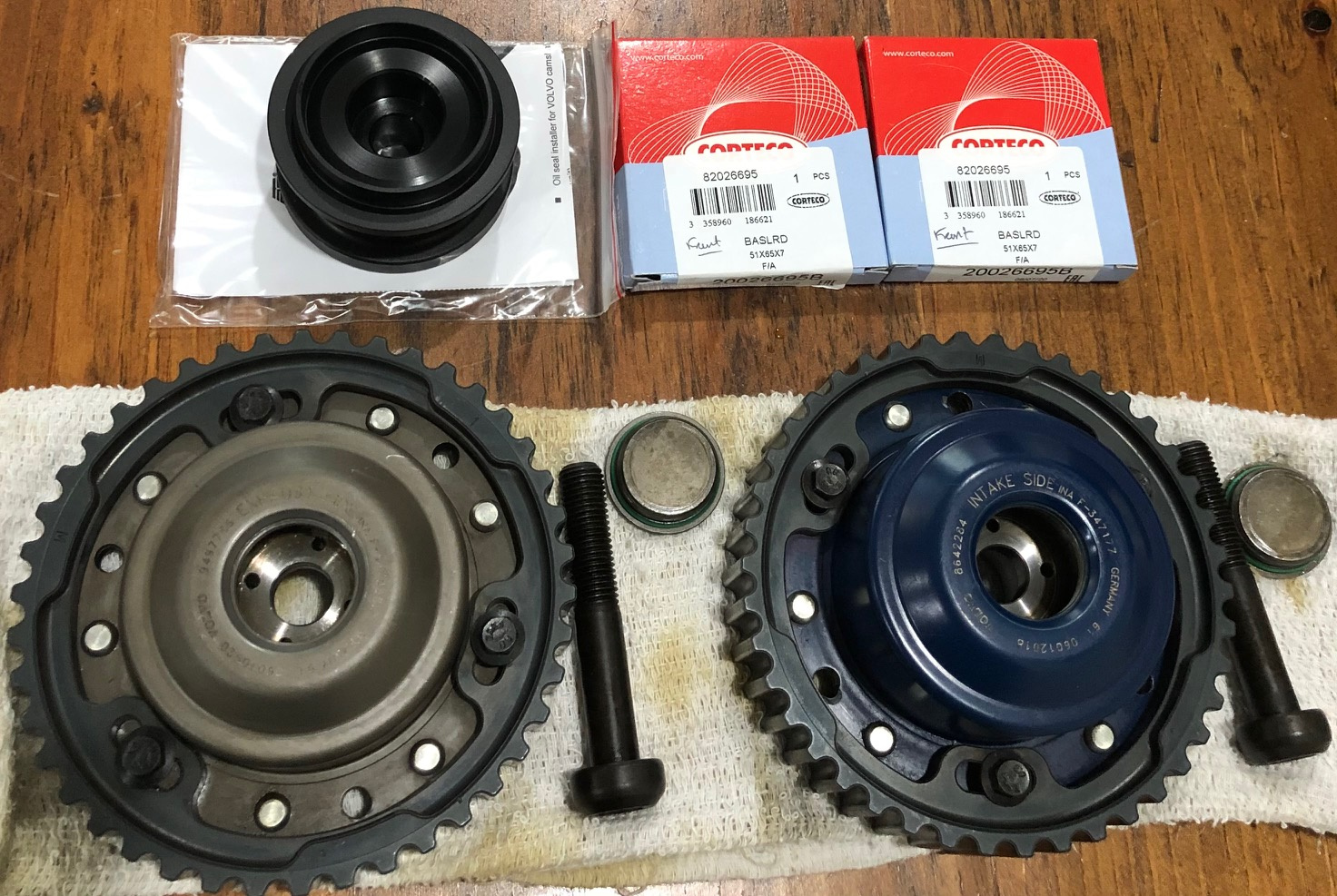

I scored at the Pick a Part the other day. 2 sets of VVT’s for my P2 S60 for $25. This set is the best. Axial play 1.7mm, look nice as well. I know my exhaust hub is easily more that double that. I’m getting some oil leakage. I replaced my harmonic balancer and crank seal a couple weeks ago. I’ll get a measurement on the play of my hubs when I take them off. I think I’ll be doing a minimum of intake, exhaust cam seals and exhaust hub today. I also have to form a game plan on my power steering rack crossover fluid lines. They are leaking at the steering wheel linkage end. I think it might be the O-rings as it had ATF in it.
