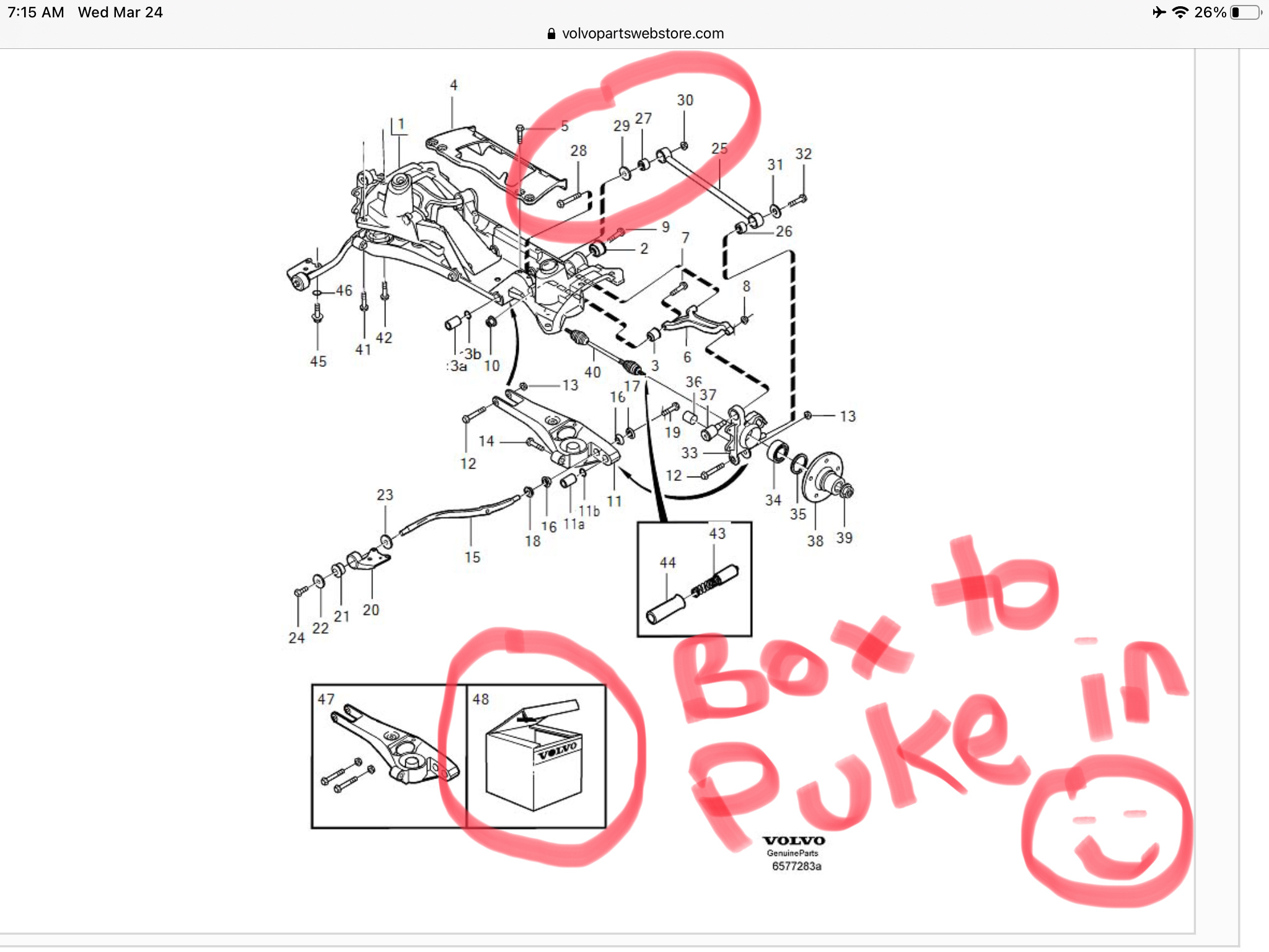

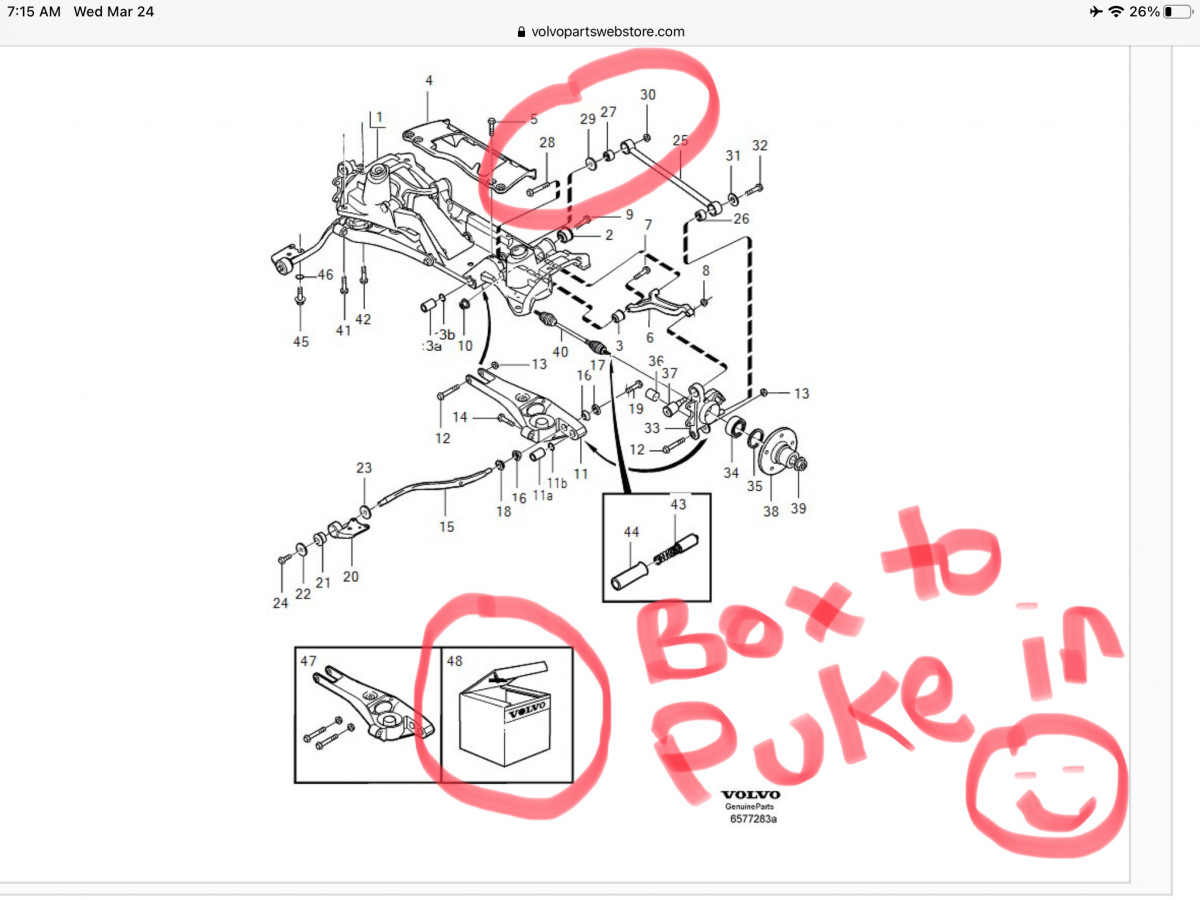

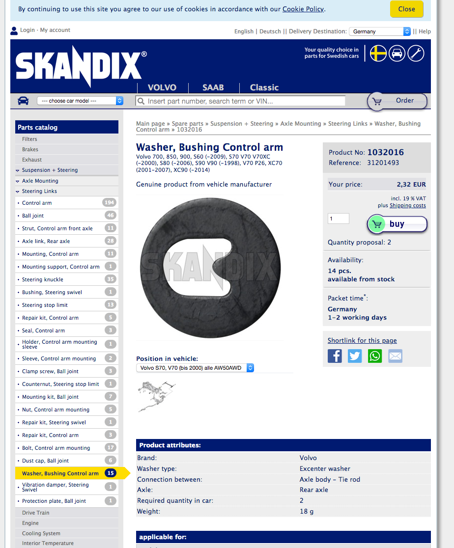

New issue, I have an eccentric bolt and a funny slotted washer on the inboard stay bushing, 27. Can’t find that in the web store. It’s nice volvo also sells a box you can throw up into when you pull up this diagram
A ha!! Skandix to the rescue...
Flange Nut 985870
Eccentric Bolt 986931
Eccentric Washer 31201493
Flange Nut 985870

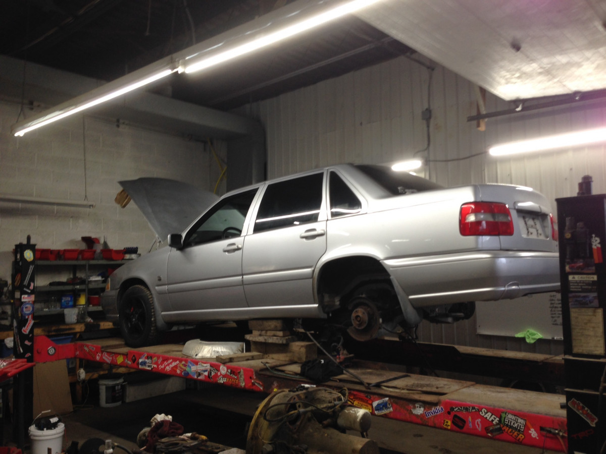

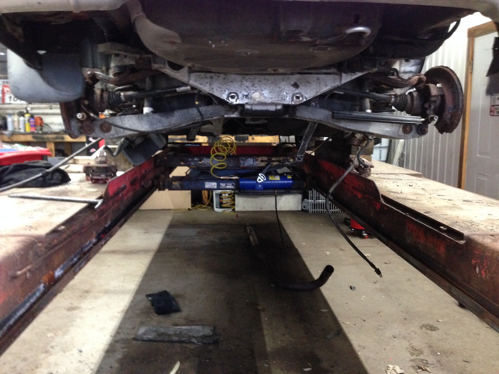

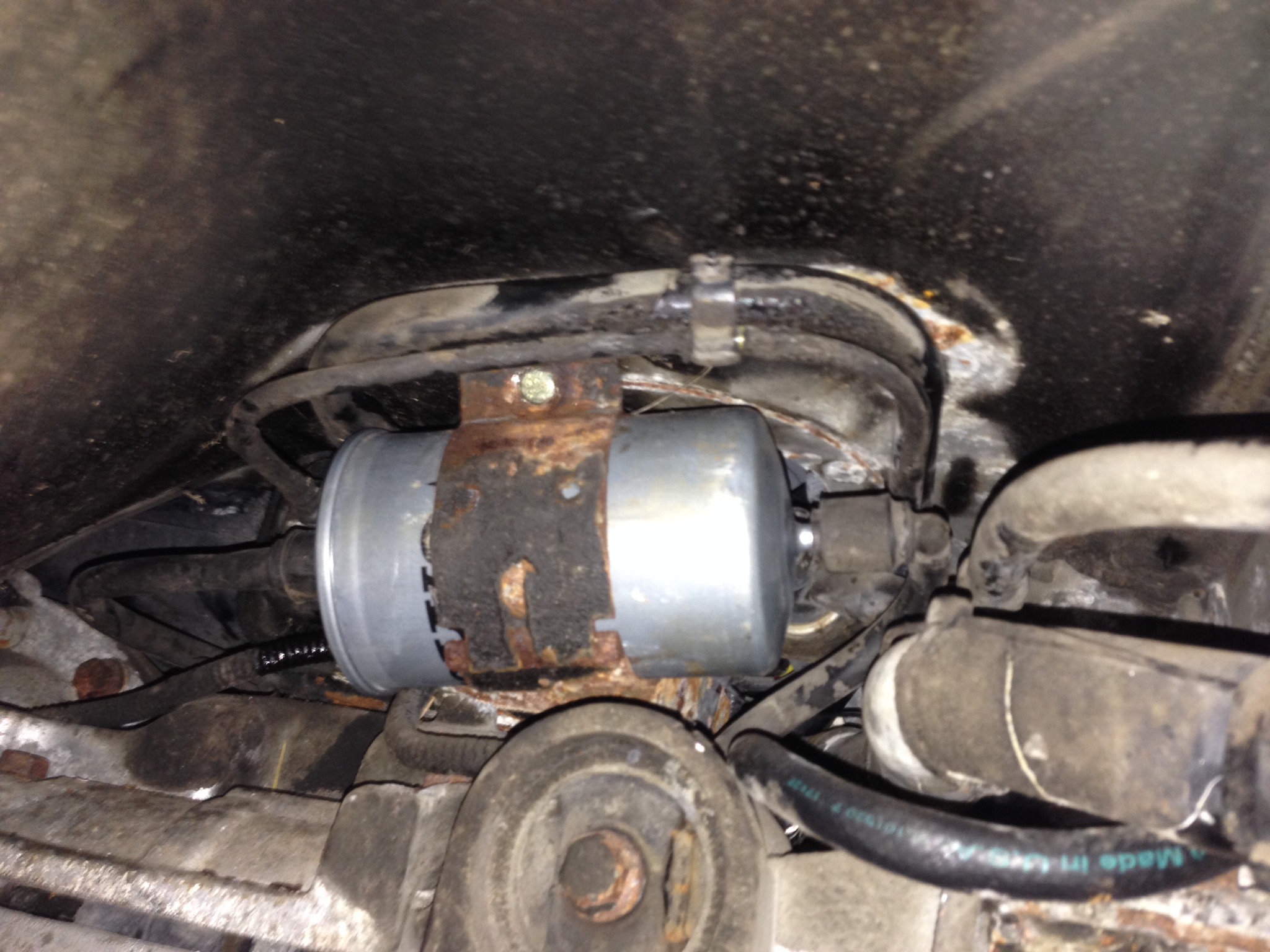

... and 5.5 hours later , total 9.5 hours
( about 1.5 hours lost on stuck fuel line )
Complete rebuild of all fuel lines and half of the evap lines.
Scrape down chassis members , prime and paint.
Axle up and in , and six side rail bolts snugged.

Holly Molly! That is a huge amount of work in that time and you know I know about that although I did not have the fancy hoist to work with.
How far are you from firing it back up to see if you managed to get all the fuel leaks?
Really exciting!!
Really exciting!!

+1 with Neil, lots of work in short time, and (probably) not the only game in play at the moment. Nice shiny new filter, and you either found connectors or re-used what came off ?

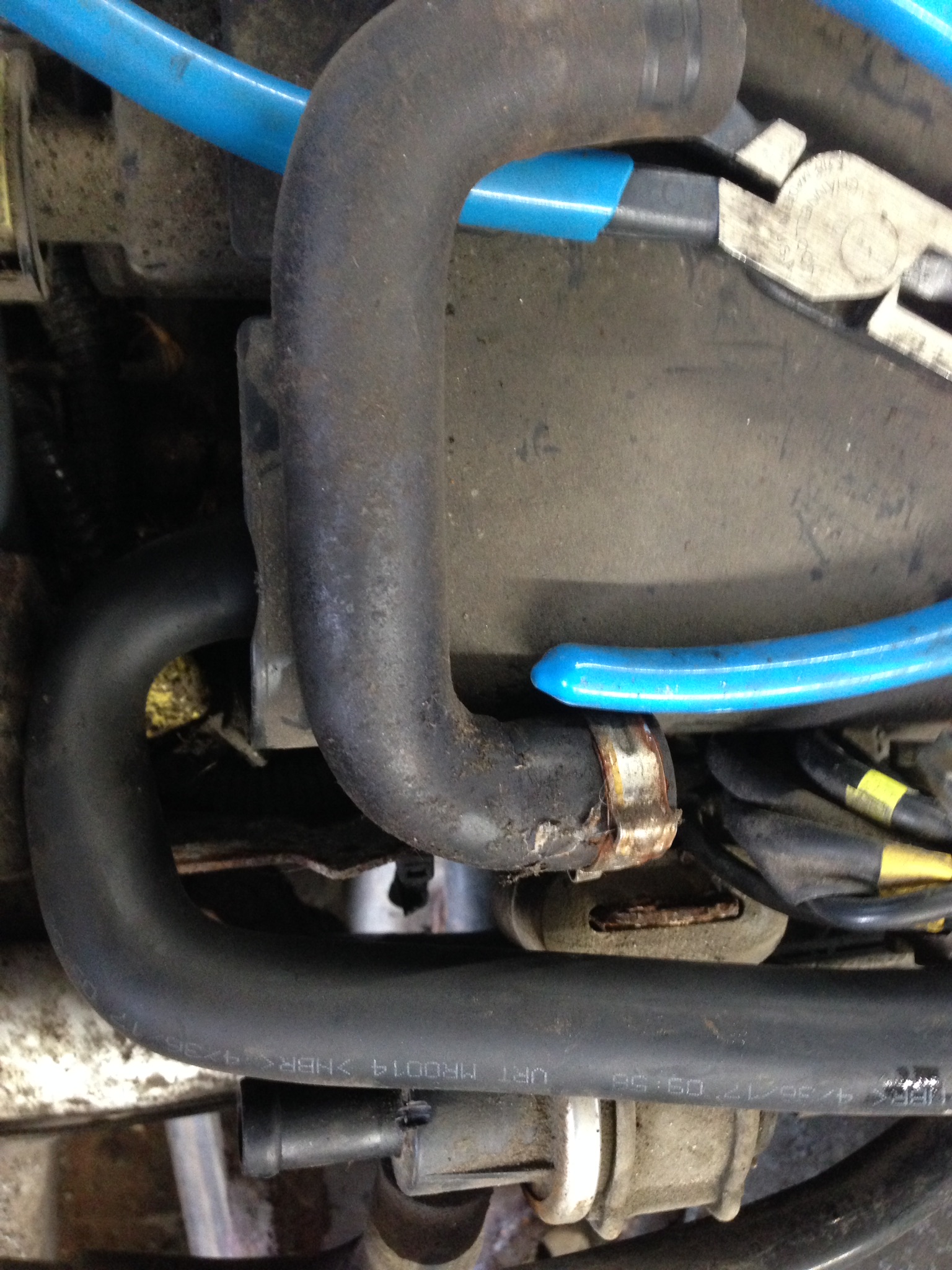

The U hose from Carbon canister to canister shut off on the AWD is NLA but you can make one from a FWD J hose....

I struggled releasing one of the fuel pump fittings at the fuel pump. Three popped off with the 90 degree angled fork tool ( picture pending) but the outboard one on the main pump , passenger side, got mangled badly. The three others, pop and off.
You have to force the plastic ferrule up into the metal spring , which then lets the fitting slide over the swage ridge on the fuel line. Unlike the FWD pump, which is a straight pipe, the AWD PUMP has a lock ridge.
I found a Ford replacement fitting for the one I mangled, picture pending
