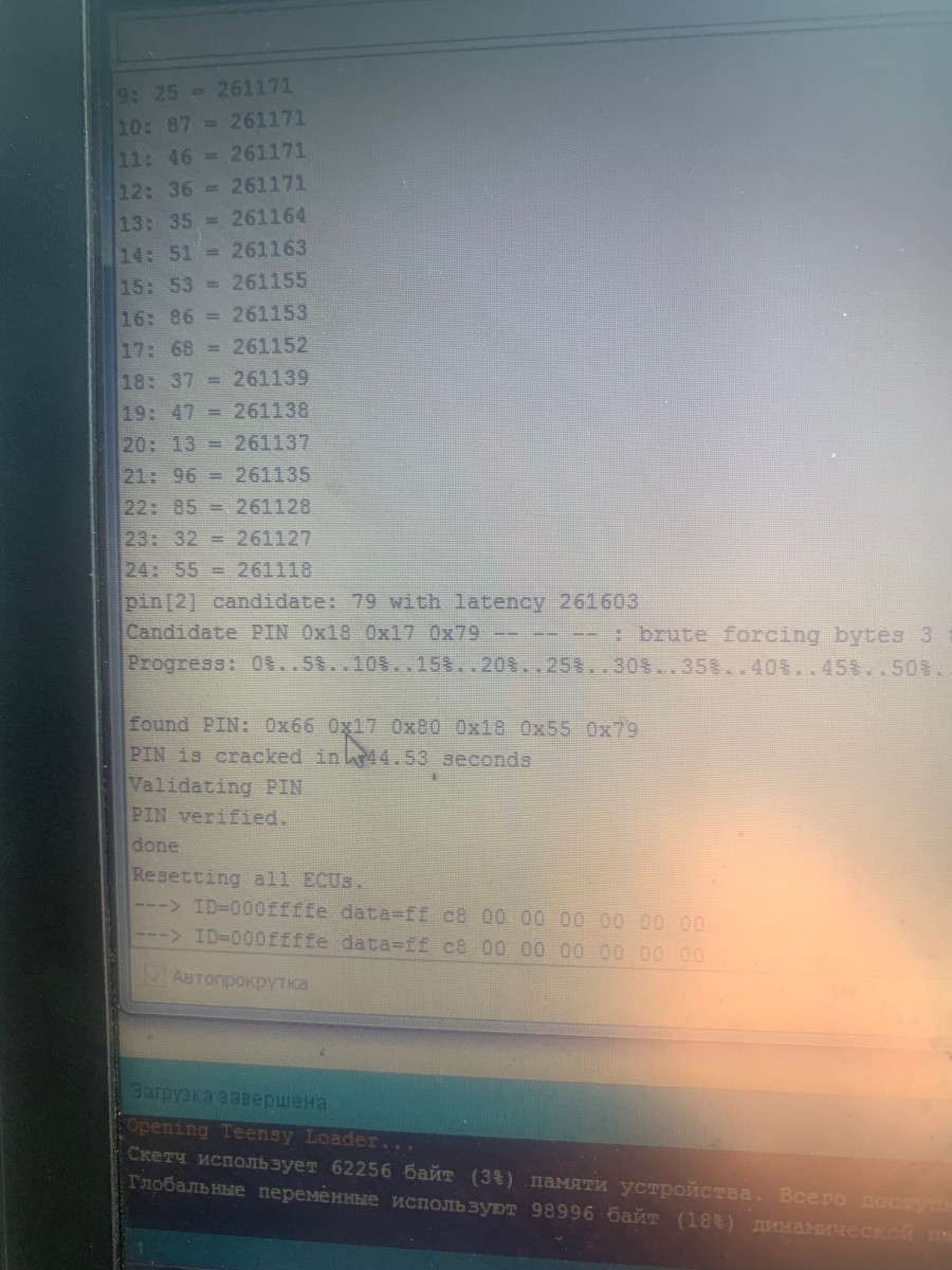

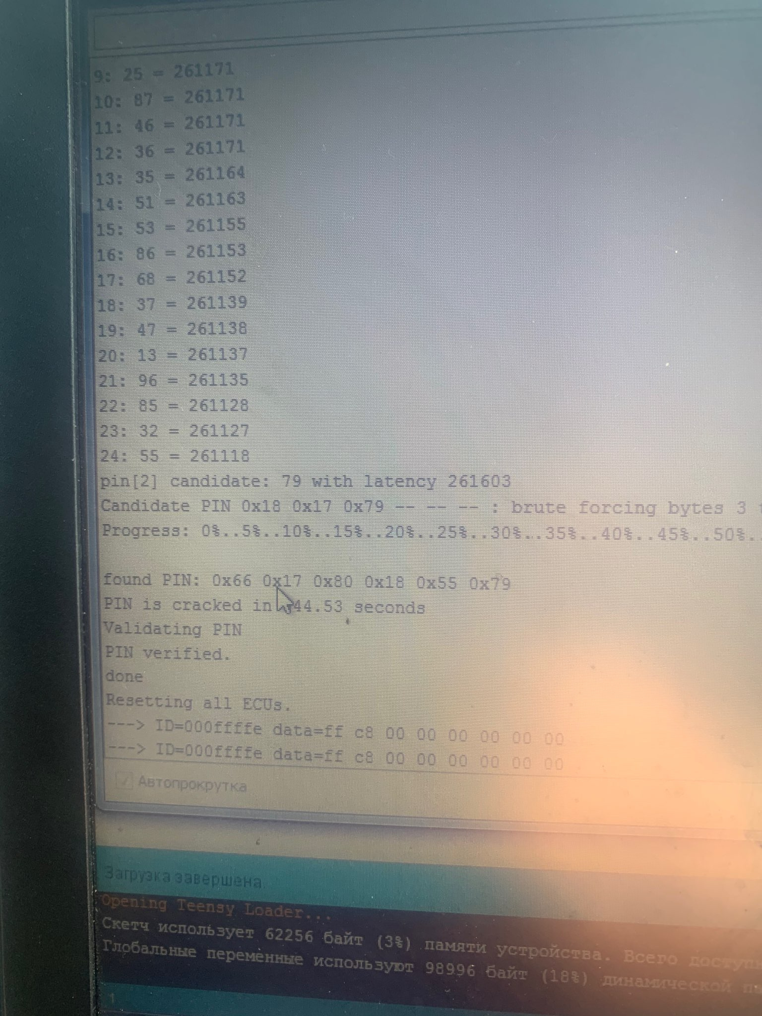

Hello everyone, I tried to hack it turned out on Volvo CEM H, L xc90 2007,2009,2010, v70 2006. Failed with two cars volvo xc70 2006, v50 2005, cpu motorolla mask 1k79x.
Thanks for the project, many will be a good helper
