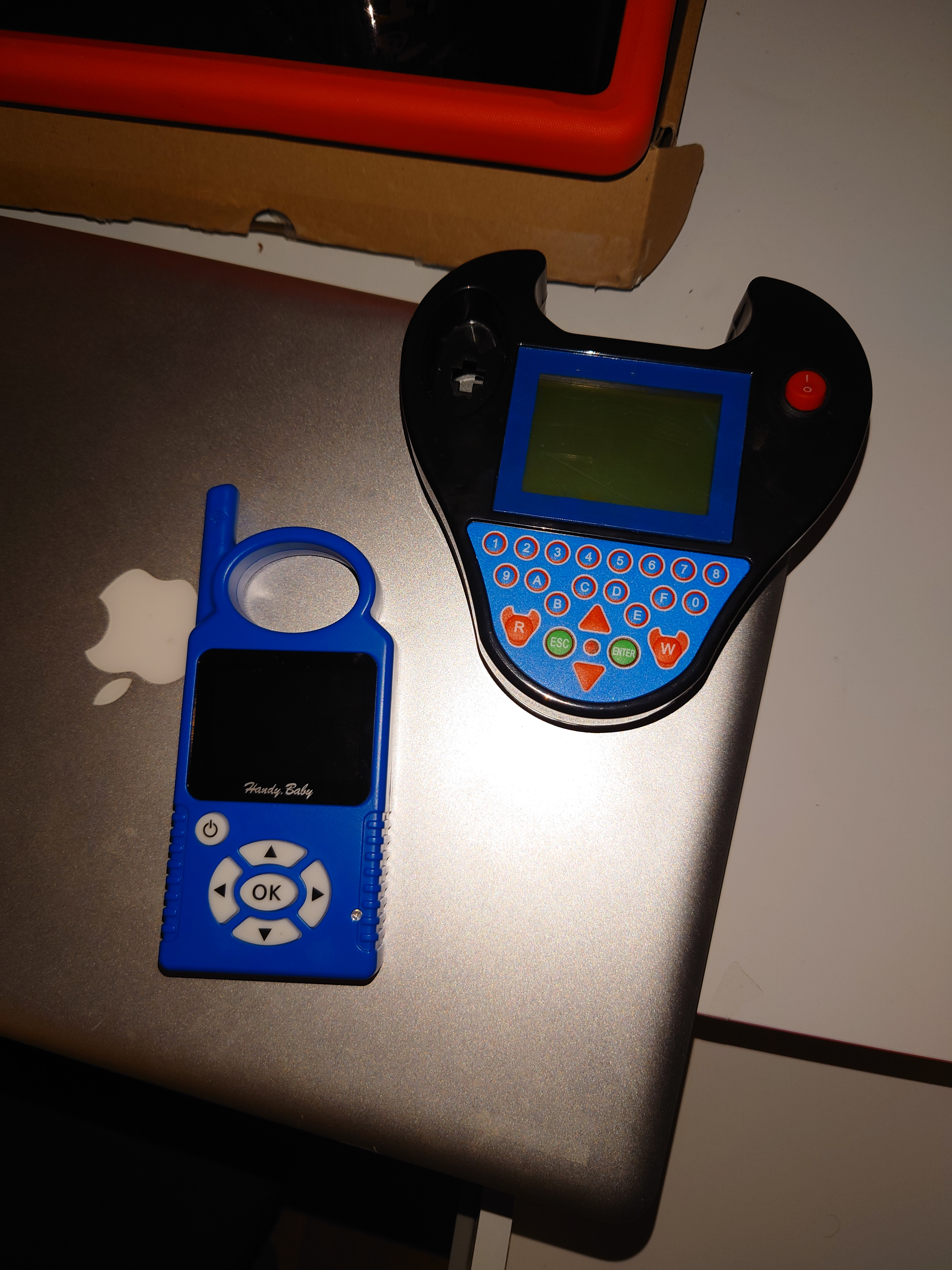

Post by blasaab »
I have cloned my key. Only remote dosent work but can unlock with the blade.
