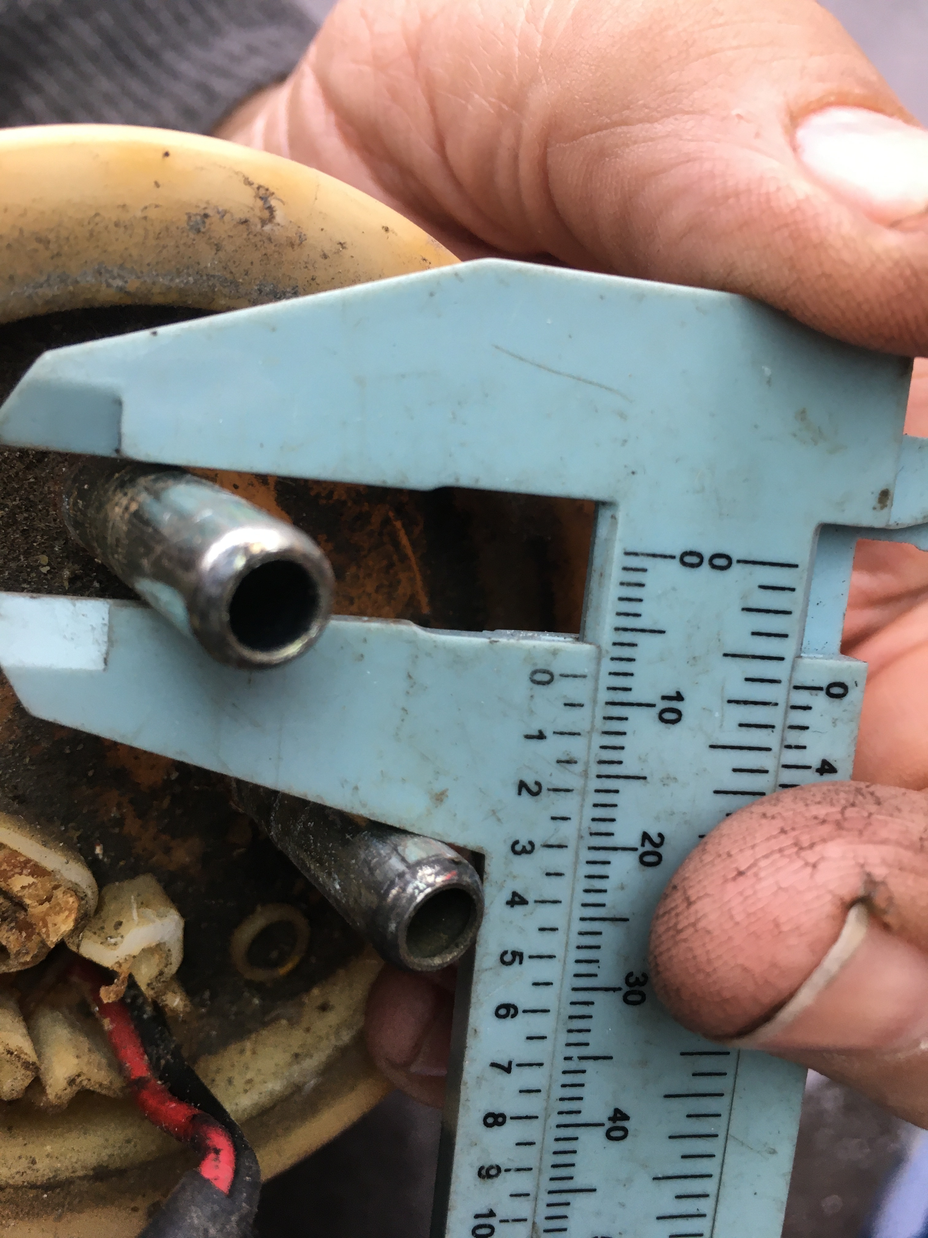

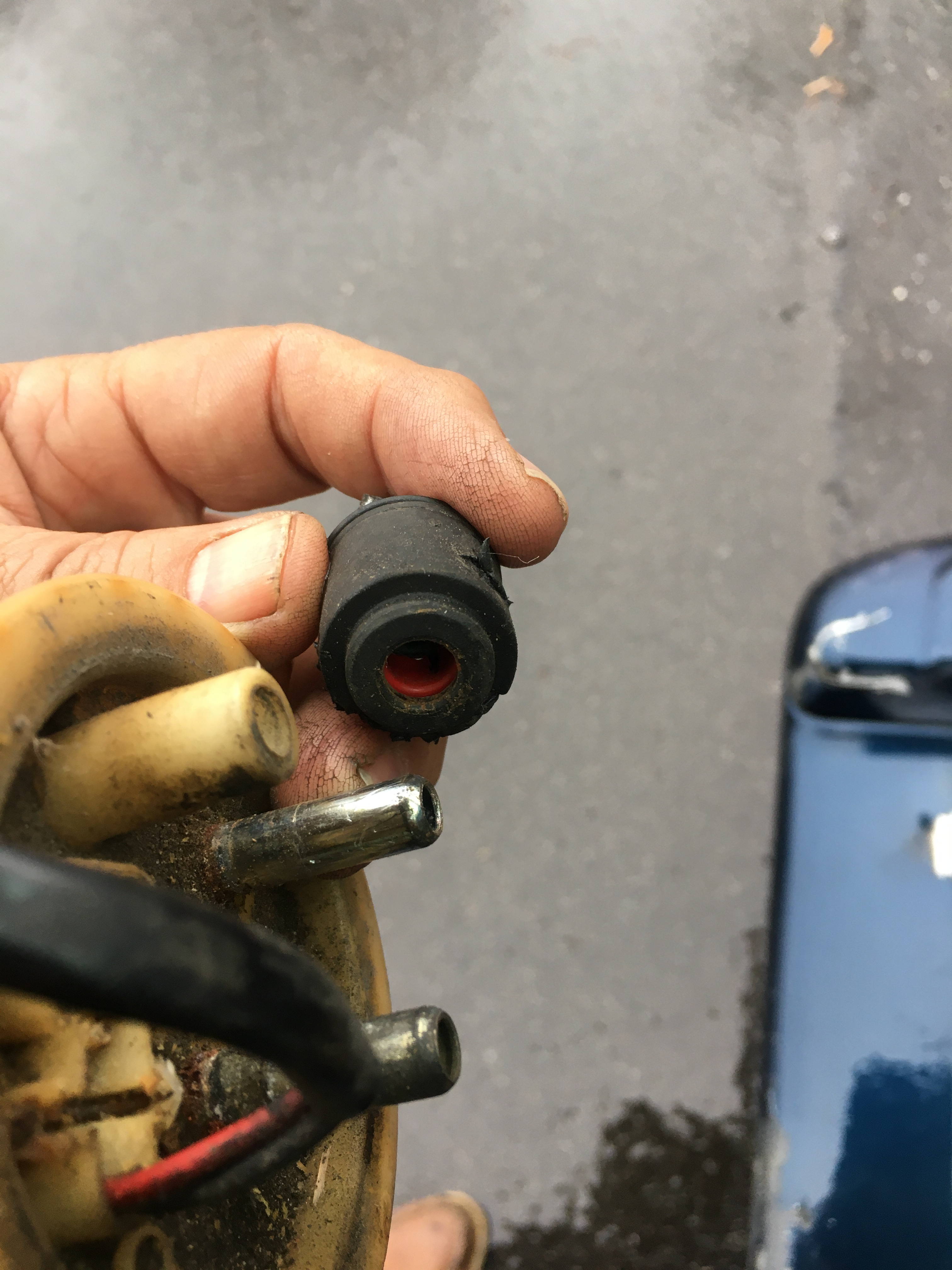

I have to Fab Four fittings for my AWD
Does anyone have a SKU FOR a third party fitting that I can connect to the fuel pumps?
1998 FWD pump
Shown
P80 source for fuel pump fittings needed Topic is solved

I’m hoping there is a bayonet type that duplicates the factory type

Update.
We got the rear axle back in to the S70 AWD but the straight fittings I used won’t work. There is a lot of tension in the hose at the body
I’ve ordered some 90 degree bend ones and I can replace with out the axle drop by just easing the torque tube and torsion bars down , then dropping the tank 3-4 inches

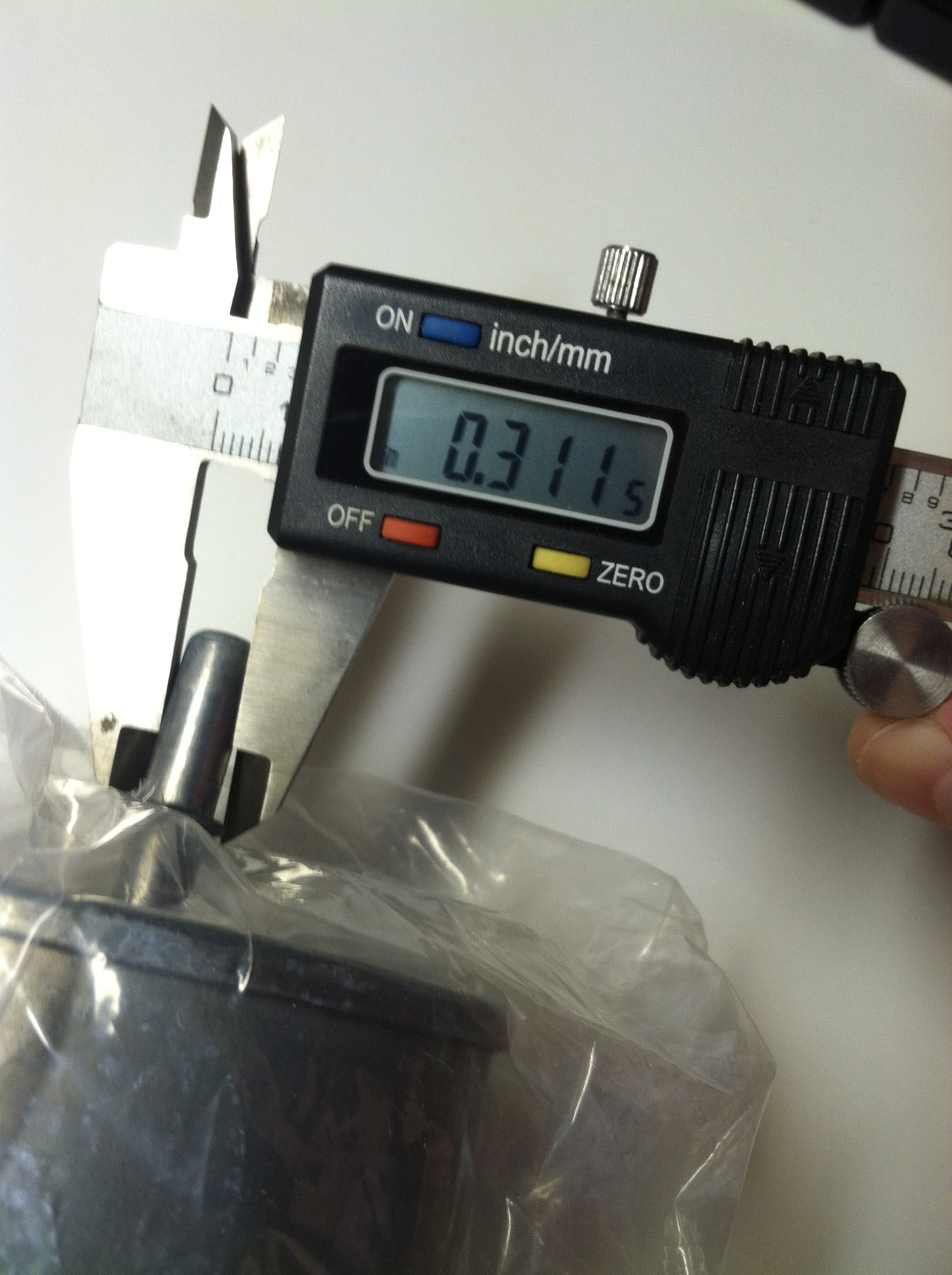

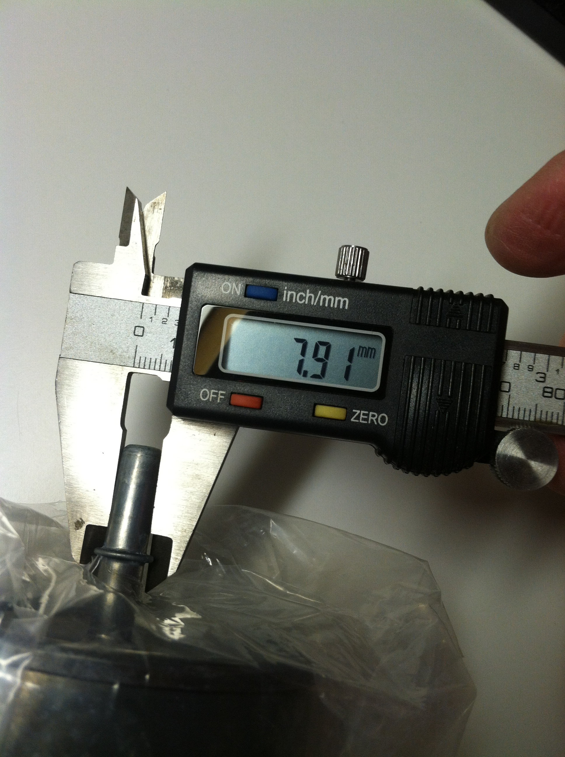

Dorman 800-783 is the right angle , 5/16 metal fittings for the AWD fuel pump
