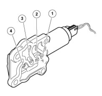

VVT solenoid, cleaning
Note! Some variation in the illustrations may occur, but the essential information is always correct.
Remove the VVT solenoid. Replacing the variable valve timing solenoid
Blow compressed air into the oil feed hole (2). Air should come out through the B port (1)
If the duct seems to be blocked, go to the cleaning
Connect current to the solenoid.
The solenoid should click. It may be easier to hear the click with the solenoid in your hand.
Blow compressed air into the oil feed hole (2). Air should come out through the A port (3). If the piston jams or the solenoid does not work, the direction of flow will not change. If the duct seems to be blocked, go to the cleaning step.
