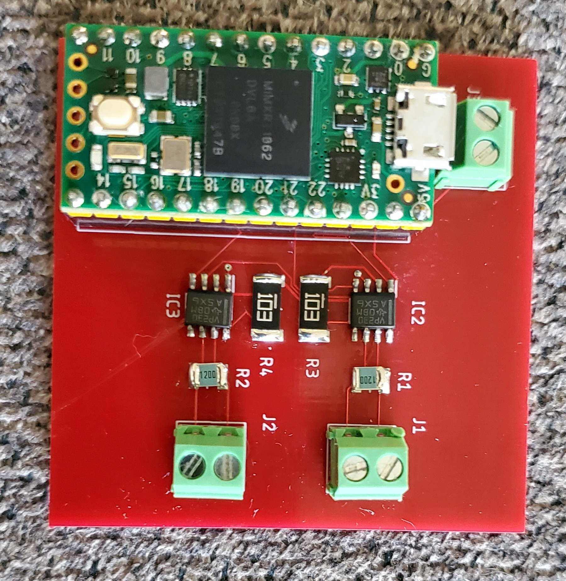

I have been working off vtl's github experimenting on my 2005 XC90 V8. Finally got tired of the breadboard, wondering about crosstalk, EMI etc, so drew up his schematic in Eagle CAD and designed a PCB. Yes, I screwed up and called the project CIM cracker instead of CEM LOL
I've attached a photo and the zip of the eagle project, complete with gerbers. I sent the gerbers off to SEEED studio and for 2.49 plus shipping, in 1 week had 10 boards back.
BOM is also attached. didn't add the teensy or the female pin headers for it as I had those already.
Enjoy!
Enjoy!
