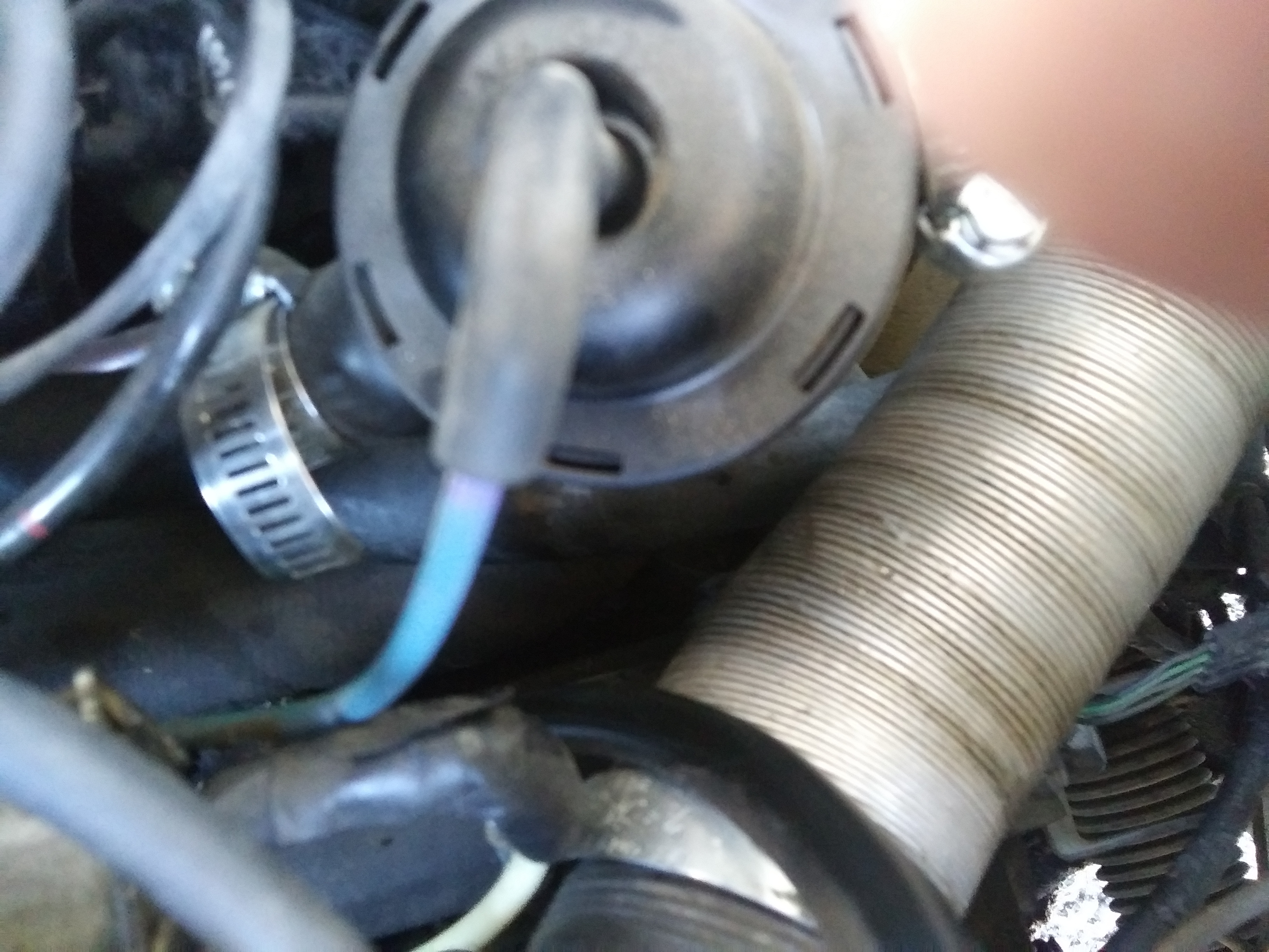

Sending pic I think this blue line from the SAS goes to the pump. I'm not sure but where on the pump if so. Or does it go somewhere else Thanks ....

It goes to the SAS solenoid mounted up on the little shelf at the fan shroud. The the left (when facing the car) of the open rubber elbow in the first pic.

That’s where the open shown end goes,
The other end goes to the SAS valve just in front of the firewall, attached to the little UFO that sits there

Yes, the second picture shows it connected there. So OP, just attach the open line and the P0410 may go away.
