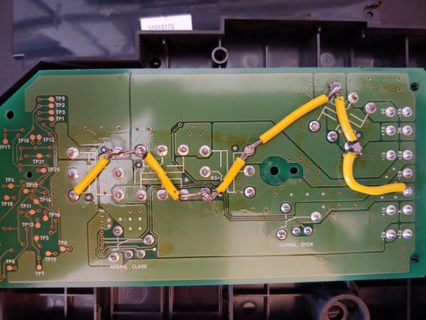

Its alive! everything is working through the switches. Thanks Bogdan abscate jbeebo wadeatl I'll post some more pics and a video maybe when its finished.

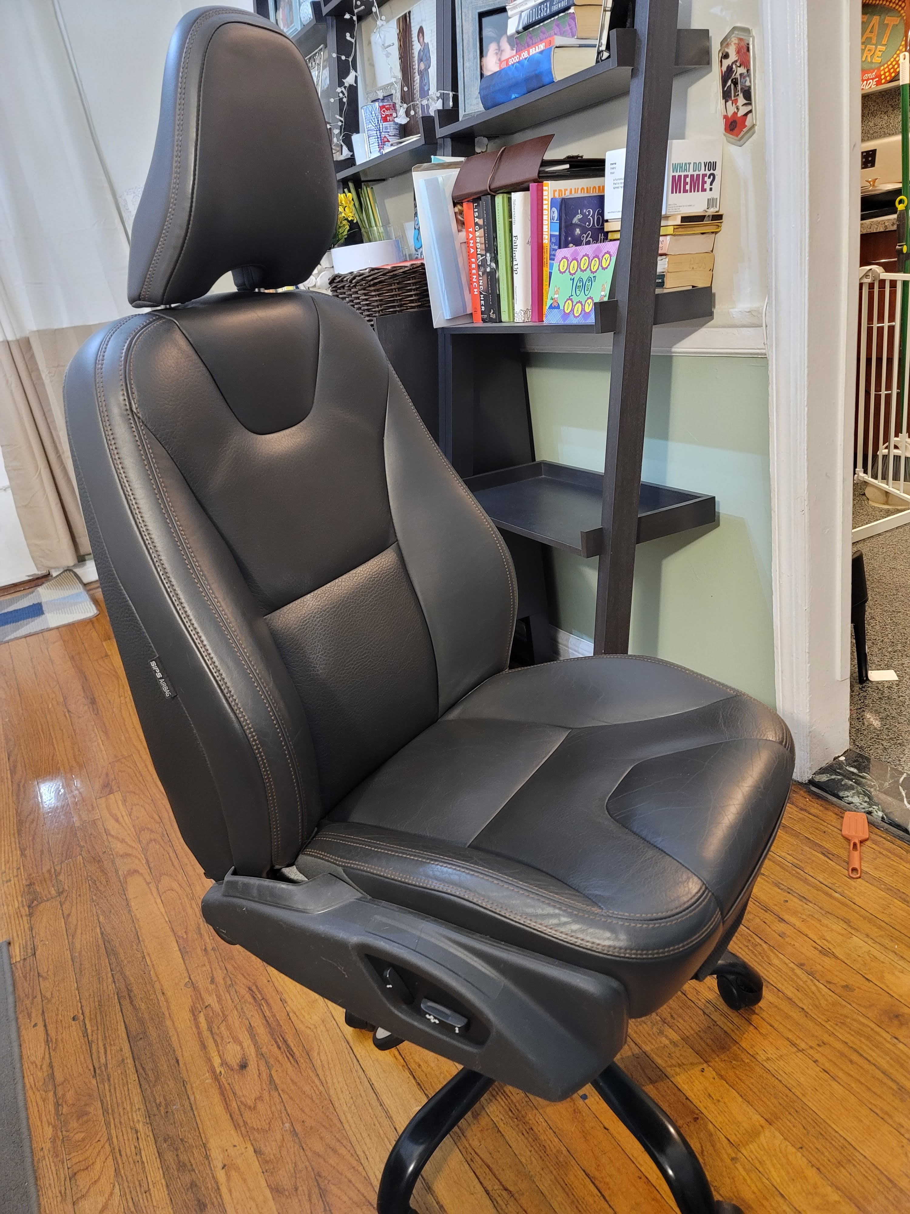

Finally got around to finishing the seat. I ended up removing the slider mechanism and ordering a shorter cylinder for the office chair base to lower the seat height a bit. Then I used some 1 inch ply and some L brackets to mount it to where the slider had been attached. I had to trim down the metal on the arm that lowers the rear to make space for the L bracket. All in all not too bad once you get it worked out.

WAIT WAIT are you bypassing the module and powering the motors directly via those factory switches? Are those factory switches rated for high currents, is there a load cutoff to prevent motor burn?

As long as you cut power when the seat is fully reclined thats when the current will rocket to about 10amps, this will over time kill the switches and damage the motor or will have a hot (fire) office seat.

You should able to use the limit switches to cut the motor power easily, look for the little roller switches on the track for angle and tilt. The fore aft motor has an internal limit switchdarrylrobert wrote: 11 Jan 2021, 05:11 As long as you cut power when the seat is fully reclined thats when the current will rocket to about 10amps, this will over time kill the switches and damage the motor or will have a hot (fire) office seat.
I dont recommend people try this mod in their cars.
Both switches are normally open you need to cut the power to the full stopdirection only, so that you can still reverse the seat. That’s left as an exercise for the student.
