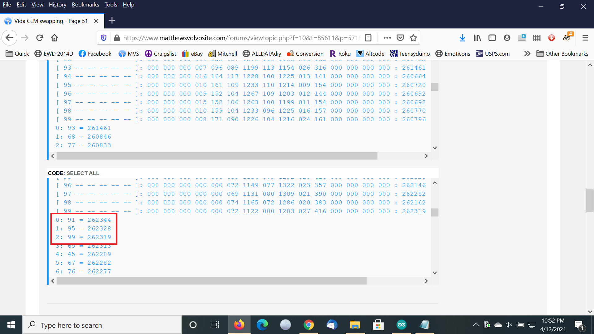

Yes and it fails. It is the 2011 P2 CEM below. Yagger has already bench cracked the CEM and has done some of the reprogramming with the CEM in the car. Still got a ways to go on the electrical and software.
Part number from logs: 2005 = 000030765643, 2011 = 000031394157. The Arduino code is calling this number ECU. This is a Volvo Part number for a P2-L CEM.

Tried to crack a 2011 P2 today. All three candidates pins[0 - 2] are too close to call and the crack fails. The pin cracker works on a my 2005 P2. I attached the log files from both sessions. Can anybody extract any insight from them?
Code: Select all

[ 89 -- -- -- -- -- ]: 000 000 000 015 160 094 1279 106 1181 012 153 000 000 000 000 : 260657
[ 90 -- -- -- -- -- ]: 000 000 000 010 154 093 1263 105 1214 009 152 000 000 000 000 : 260737
[ 91 -- -- -- -- -- ]: 000 000 000 015 173 107 1201 108 1246 011 139 000 000 000 000 : 260691
[ 92 -- -- -- -- -- ]: 000 000 000 009 152 087 1278 110 1185 016 163 000 000 000 000 : 260762
[ 93 -- -- -- -- -- ]: 000 000 000 007 096 089 1199 113 1154 026 316 000 000 000 000 : 261461
[ 94 -- -- -- -- -- ]: 000 000 000 016 164 113 1228 100 1225 013 141 000 000 000 000 : 260664
[ 95 -- -- -- -- -- ]: 000 000 000 010 161 109 1233 110 1214 009 154 000 000 000 000 : 260720
[ 96 -- -- -- -- -- ]: 000 000 000 009 152 104 1267 109 1203 012 144 000 000 000 000 : 260692
[ 97 -- -- -- -- -- ]: 000 000 000 015 152 106 1263 100 1199 011 154 000 000 000 000 : 260692
[ 98 -- -- -- -- -- ]: 000 000 000 010 159 104 1233 096 1225 016 157 000 000 000 000 : 260770
[ 99 -- -- -- -- -- ]: 000 000 000 008 171 090 1226 104 1216 024 161 000 000 000 000 : 260796
0: 93 = 261461
1: 68 = 260846
2: 77 = 260833
3: 53 = 260833
4: 54 = 260827
5: 76 = 260818
6: 33 = 260816
7: 85 = 260799
8: 48 = 260797
9: 26 = 260796
10: 99 = 260796
11: 49 = 260796
12: 22 = 260789
13: 27 = 260786
14: 51 = 260783
15: 52 = 260783
16: 88 = 260780
17: 72 = 260775
18: 98 = 260770
19: 23 = 260767
20: 92 = 260762
21: 87 = 260760
22: 74 = 260756
23: 61 = 260749
24: 65 = 260748
pin[0] candidate: 93 with latency 261461
[ 93 00 -- -- -- -- ]: 000 000 000 006 091 091 1194 100 1172 034 312 000 000 000 000 : 261503
[ 93 01 -- -- -- -- ]: 000 000 000 005 088 109 1237 096 1140 032 293 000 000 000 000 : 261344
[ 93 02 -- -- -- -- ]: 000 000 000 005 078 098 1212 110 1165 033 299 000 000 000 000 : 261466
[ 93 03 -- -- -- -- ]: 000 000 000 004 085 102 1251 096 1137 025 300 000 000 000 000 : 261361
[ 93 04 -- -- -- -- ]: 000 000 000 006 092 097 1173 093 1213 027 299 000 000 000 000 : 261497
[ 93 05 -- -- -- -- ]: 000 000 000 010 086 102 1228 106 1130 021 317 000 000 000 000 : 261393
[ 93 06 -- -- -- -- ]: 000 000 000 006 090 096 1242 110 1120 021 315 000 000 000 000 : 261379
[ 93 07 -- -- -- -- ]: 000 000 000 006 098 095 1263 089 1110 025 314 000 000 000 000 : 261331
[ 93 08 -- -- -- -- ]: 000 000 000 009 093 118 1217 084 1191 022 266 000 000 000 000 : 261265
[ 93 09 -- -- -- -- ]: 000 000 000 007 099 103 1238 104 1151 022 276 000 000 000 000 : 261254
[ 93 10 -- -- -- -- ]: 000 000 000 003 112 111 1251 093 1136 024 270 000 000 000 000 : 261173
[ 93 11 -- -- -- -- ]: 000 000 000 005 114 107 1229 088 1129 033 295 000 000 000 000 : 261275
[ 93 12 -- -- -- -- ]: 000 000 000 005 105 114 1249 088 1142 027 270 000 000 000 000 : 261194
[ 93 13 -- -- -- -- ]: 000 000 000 009 094 093 1187 113 1199 032 273 000 000 000 000 : 261391
[ 93 14 -- -- -- -- ]: 000 000 000 009 108 094 1232 102 1155 025 275 000 000 000 000 : 261250
[ 93 15 -- -- -- -- ]: 000 000 000 002 109 100 1222 098 1147 032 290 000 000 000 000 : 261324
[ 93 16 -- -- -- -- ]: 000 000 000 009 100 098 1181 103 1154 033 322 000 000 000 000 : 261473
[ 93 17 -- -- -- -- ]: 000 000 000 010 094 098 1214 096 1160 028 300 000 000 000 000 : 261384
[ 93 18 -- -- -- -- ]: 000 000 000 008 095 104 1241 096 1140 019 297 000 000 000 000 : 261303
[ 93 19 -- -- -- -- ]: 000 000 000 011 081 095 1237 097 1176 026 277 000 000 000 000 : 261345
[ 93 20 -- -- -- -- ]: 000 000 000 006 101 093 1278 102 1090 025 305 000 000 000 000 : 261264
[ 93 21 -- -- -- -- ]: 000 000 000 003 108 098 1172 106 1168 032 313 000 000 000 000 : 261467
[ 93 22 -- -- -- -- ]: 000 000 000 008 116 092 1170 097 1195 026 296 000 000 000 000 : 261401
[ 93 23 -- -- -- -- ]: 000 000 000 009 093 107 1223 098 1137 018 315 000 000 000 000 : 261366
[ 93 24 -- -- -- -- ]: 000 000 000 007 108 111 1213 085 1161 023 292 000 000 000 000 : 261296
[ 93 25 -- -- -- -- ]: 000 000 000 008 103 090 1178 109 1182 026 304 000 000 000 000 : 261447
[ 93 26 -- -- -- -- ]: 000 000 000 008 087 086 1193 099 1161 037 329 000 000 000 000 : 261564
[ 93 27 -- -- -- -- ]: 000 000 000 009 099 102 1210 103 1157 031 289 000 000 000 000 : 261339
[ 93 28 -- -- -- -- ]: 000 000 000 007 089 091 1220 115 1129 025 324 000 000 000 000 : 261454
[ 93 29 -- -- -- -- ]: 000 000 000 006 113 107 1197 095 1145 028 309 000 000 000 000 : 261354
[ 93 30 -- -- -- -- ]: 000 000 000 008 091 088 1227 093 1156 030 307 000 000 000 000 : 261429
[ 93 31 -- -- -- -- ]: 000 000 000 011 098 103 1165 110 1173 024 316 000 000 000 000 : 261460
[ 93 32 -- -- -- -- ]: 000 000 000 008 098 098 1156 102 1184 026 328 000 000 000 000 : 261542
[ 93 33 -- -- -- -- ]: 000 000 000 013 077 118 1205 098 1155 029 305 000 000 000 000 : 261404
[ 93 34 -- -- -- -- ]: 000 000 000 014 093 105 1164 093 1216 029 286 000 000 000 000 : 261423
[ 93 35 -- -- -- -- ]: 000 000 000 005 114 109 1179 097 1176 028 292 000 000 000 000 : 261349
[ 93 36 -- -- -- -- ]: 000 000 000 011 094 113 1180 096 1176 021 309 000 000 000 000 : 261413
[ 93 37 -- -- -- -- ]: 000 000 000 008 090 085 1179 101 1175 028 334 000 000 000 000 : 261582
[ 93 38 -- -- -- -- ]: 000 000 000 009 072 105 1214 104 1164 019 313 000 000 000 000 : 261465
[ 93 39 -- -- -- -- ]: 000 000 000 009 096 120 1186 095 1158 021 315 000 000 000 000 : 261395
[ 93 40 -- -- -- -- ]: 000 000 000 010 101 123 1205 085 1143 028 305 000 000 000 000 : 261320
[ 93 41 -- -- -- -- ]: 000 000 000 010 080 093 1259 084 1120 041 313 000 000 000 000 : 261416
[ 93 42 -- -- -- -- ]: 000 000 000 009 090 094 1179 106 1163 030 329 000 000 000 000 : 261537
[ 93 43 -- -- -- -- ]: 000 000 000 000 000 099 1160 116 1204 026 395 000 000 000 000 : 262083
[ 93 44 -- -- -- -- ]: 000 000 000 008 109 087 1213 110 1145 029 299 000 000 000 000 : 261354
[ 93 45 -- -- -- -- ]: 000 000 000 016 097 102 1185 110 1150 019 321 000 000 000 000 : 261407
[ 93 46 -- -- -- -- ]: 000 000 000 006 103 103 1154 102 1164 024 344 000 000 000 000 : 261551
[ 93 47 -- -- -- -- ]: 000 000 000 008 104 100 1158 099 1167 027 337 000 000 000 000 : 261530
[ 93 48 -- -- -- -- ]: 000 000 000 010 101 112 1220 106 1131 027 293 000 000 000 000 : 261277
[ 93 49 -- -- -- -- ]: 000 000 000 011 101 115 1135 102 1201 030 305 000 000 000 000 : 261464
[ 93 50 -- -- -- -- ]: 000 000 000 007 093 113 1216 116 1143 027 285 000 000 000 000 : 261303
[ 93 51 -- -- -- -- ]: 000 000 000 009 104 098 1184 099 1135 029 342 000 000 000 000 : 261491
[ 93 52 -- -- -- -- ]: 000 000 000 008 080 089 1208 095 1180 029 311 000 000 000 000 : 261513
[ 93 53 -- -- -- -- ]: 000 000 000 009 096 089 1214 107 1135 022 328 000 000 000 000 : 261447
[ 93 54 -- -- -- -- ]: 000 000 000 006 079 108 1183 100 1193 022 309 000 000 000 000 : 261504
[ 93 55 -- -- -- -- ]: 000 000 000 011 092 091 1193 115 1145 022 331 000 000 000 000 : 261487
[ 93 56 -- -- -- -- ]: 000 000 000 009 091 101 1191 094 1158 036 320 000 000 000 000 : 261488
[ 93 57 -- -- -- -- ]: 000 000 000 005 098 094 1217 112 1106 027 341 000 000 000 000 : 261464
[ 93 58 -- -- -- -- ]: 000 000 000 015 091 095 1183 104 1179 028 305 000 000 000 000 : 261444
[ 93 59 -- -- -- -- ]: 000 000 000 006 091 104 1173 106 1187 024 309 000 000 000 000 : 261484
[ 93 60 -- -- -- -- ]: 000 000 000 011 088 112 1263 091 1110 031 294 000 000 000 000 : 261259
[ 93 61 -- -- -- -- ]: 000 000 000 009 095 101 1209 093 1144 033 316 000 000 000 000 : 261426
[ 93 62 -- -- -- -- ]: 000 000 000 005 116 093 1169 104 1157 026 330 000 000 000 000 : 261476
[ 93 63 -- -- -- -- ]: 000 000 000 006 107 086 1175 114 1157 030 325 000 000 000 000 : 261500
[ 93 64 -- -- -- -- ]: 000 000 000 002 088 116 1243 081 1145 040 285 000 000 000 000 : 261333
[ 93 65 -- -- -- -- ]: 000 000 000 013 105 093 1179 109 1145 030 326 000 000 000 000 : 261451
[ 93 66 -- -- -- -- ]: 000 000 000 003 091 100 1157 106 1175 025 343 000 000 000 000 : 261612
[ 93 67 -- -- -- -- ]: 000 000 000 008 098 101 1200 105 1126 024 338 000 000 000 000 : 261460
[ 93 68 -- -- -- -- ]: 000 000 000 007 098 102 1246 116 1114 030 287 000 000 000 000 : 261263
[ 93 69 -- -- -- -- ]: 000 000 000 011 099 092 1146 091 1190 035 336 000 000 000 000 : 261597
[ 93 70 -- -- -- -- ]: 000 000 000 006 087 116 1250 091 1148 030 272 000 000 000 000 : 261257
[ 93 71 -- -- -- -- ]: 000 000 000 011 086 096 1202 114 1144 018 329 000 000 000 000 : 261471
[ 93 72 -- -- -- -- ]: 000 000 000 005 094 091 1156 105 1161 028 360 000 000 000 000 : 261657
[ 93 73 -- -- -- -- ]: 000 000 000 011 094 097 1150 104 1181 034 329 000 000 000 000 : 261566
[ 93 74 -- -- -- -- ]: 000 000 000 011 082 115 1213 098 1155 031 295 000 000 000 000 : 261369
[ 93 75 -- -- -- -- ]: 000 000 000 007 082 101 1163 107 1174 031 335 000 000 000 000 : 261602
[ 93 76 -- -- -- -- ]: 000 000 000 010 095 091 1209 102 1116 026 351 000 000 000 000 : 261505
[ 93 77 -- -- -- -- ]: 000 000 000 006 092 115 1160 107 1191 023 306 000 000 000 000 : 261465
[ 93 78 -- -- -- -- ]: 000 000 000 007 080 107 1224 105 1144 018 315 000 000 000 000 : 261419
[ 93 79 -- -- -- -- ]: 000 000 000 013 116 122 1141 099 1170 033 306 000 000 000 000 : 261369
[ 93 80 -- -- -- -- ]: 000 000 000 007 088 086 1219 108 1165 036 291 000 000 000 000 : 261427
[ 93 81 -- -- -- -- ]: 000 000 000 012 102 095 1205 103 1157 026 300 000 000 000 000 : 261360
[ 93 82 -- -- -- -- ]: 000 000 000 005 084 114 1255 090 1139 031 282 000 000 000 000 : 261292
[ 93 83 -- -- -- -- ]: 000 000 000 011 095 105 1230 100 1123 028 308 000 000 000 000 : 261334
[ 93 84 -- -- -- -- ]: 000 000 000 007 080 095 1236 093 1152 031 306 000 000 000 000 : 261438
[ 93 85 -- -- -- -- ]: 000 000 000 009 099 094 1200 098 1142 028 330 000 000 000 000 : 261467
[ 93 86 -- -- -- -- ]: 000 000 000 008 085 099 1181 109 1142 028 348 000 000 000 000 : 261576
[ 93 87 -- -- -- -- ]: 000 000 000 012 077 101 1125 110 1186 036 353 000 000 000 000 : 261711
[ 93 88 -- -- -- -- ]: 000 000 000 016 113 104 1201 094 1166 023 283 000 000 000 000 : 261249
[ 93 89 -- -- -- -- ]: 000 000 000 010 098 092 1160 098 1198 029 315 000 000 000 000 : 261523
[ 93 90 -- -- -- -- ]: 000 000 000 011 098 098 1219 115 1136 027 296 000 000 000 000 : 261325
[ 93 91 -- -- -- -- ]: 000 000 000 007 083 095 1141 085 1203 041 345 000 000 000 000 : 261712
[ 93 92 -- -- -- -- ]: 000 000 000 011 088 098 1185 104 1157 024 333 000 000 000 000 : 261515
[ 93 93 -- -- -- -- ]: 000 000 000 012 109 105 1131 106 1197 023 317 000 000 000 000 : 261478
[ 93 94 -- -- -- -- ]: 000 000 000 005 087 095 1240 105 1118 029 321 000 000 000 000 : 261428
[ 93 95 -- -- -- -- ]: 000 000 000 007 089 106 1144 082 1194 036 342 000 000 000 000 : 261641
[ 93 96 -- -- -- -- ]: 000 000 000 011 101 098 1180 103 1182 026 299 000 000 000 000 : 261408
[ 93 97 -- -- -- -- ]: 000 000 000 006 108 106 1162 101 1150 031 336 000 000 000 000 : 261498
[ 93 98 -- -- -- -- ]: 000 000 000 017 094 114 1254 100 1100 027 294 000 000 000 000 : 261204
[ 93 99 -- -- -- -- ]: 000 000 000 011 091 107 1140 095 1184 039 333 000 000 000 000 : 261590
0: 43 = 262083
1: 91 = 261712
2: 87 = 261711
3: 72 = 261657
4: 95 = 261641
5: 66 = 261612
6: 75 = 261602
7: 69 = 261597
8: 99 = 261590
9: 37 = 261582
10: 86 = 261576
11: 73 = 261566
12: 26 = 261564
13: 46 = 261551
14: 32 = 261542
15: 42 = 261537
16: 47 = 261530
17: 89 = 261523
18: 92 = 261515
19: 52 = 261513
20: 76 = 261505
21: 54 = 261504
22: 00 = 261503
23: 63 = 261500
24: 97 = 261498
pin[1] candidate: 43 with latency 262083
[ 93 43 00 -- -- -- ]: 000 000 000 000 000 100 1101 111 1284 032 372 000 000 000 000 : 262163
[ 93 43 01 -- -- -- ]: 000 000 000 000 000 107 1086 123 1267 037 380 000 000 000 000 : 262181
[ 93 43 02 -- -- -- ]: 000 000 000 000 000 103 1229 099 1206 027 336 000 000 000 000 : 261833
[ 93 43 03 -- -- -- ]: 000 000 000 000 000 108 1264 102 1164 039 323 000 000 000 000 : 261731
[ 93 43 04 -- -- -- ]: 000 000 000 000 000 119 1214 111 1160 027 369 000 000 000 000 : 261869
[ 93 43 05 -- -- -- ]: 000 000 000 000 000 120 1259 106 1171 027 317 000 000 000 000 : 261677
[ 93 43 06 -- -- -- ]: 000 000 000 000 000 102 1222 111 1223 025 317 000 000 000 000 : 261798
[ 93 43 07 -- -- -- ]: 000 000 000 000 000 120 1244 107 1175 024 330 000 000 000 000 : 261729
[ 93 43 08 -- -- -- ]: 000 000 000 000 000 102 1180 107 1228 028 355 000 000 000 000 : 261965
[ 93 43 09 -- -- -- ]: 000 000 000 000 000 106 1267 095 1173 028 331 000 000 000 000 : 261743
[ 93 43 10 -- -- -- ]: 000 000 000 000 000 103 1206 101 1222 025 343 000 000 000 000 : 261889
[ 93 43 11 -- -- -- ]: 000 000 000 000 000 109 1247 122 1159 030 333 000 000 000 000 : 261753
[ 93 43 12 -- -- -- ]: 000 000 000 000 000 120 1236 086 1163 036 359 000 000 000 000 : 261836
[ 93 43 13 -- -- -- ]: 000 000 000 000 000 098 1218 102 1196 028 358 000 000 000 000 : 261912
[ 93 43 14 -- -- -- ]: 000 000 000 000 000 092 1241 115 1180 035 337 000 000 000 000 : 261836
[ 93 43 15 -- -- -- ]: 000 000 000 000 000 110 1259 109 1148 032 342 000 000 000 000 : 261759
[ 93 43 16 -- -- -- ]: 000 000 000 000 000 108 1247 106 1165 031 343 000 000 000 000 : 261793
[ 93 43 17 -- -- -- ]: 000 000 000 000 000 119 1195 097 1180 033 376 000 000 000 000 : 261941
[ 93 43 18 -- -- -- ]: 000 000 000 000 000 108 1191 117 1191 028 365 000 000 000 000 : 261935
[ 93 43 19 -- -- -- ]: 000 000 000 000 000 108 1258 115 1172 017 330 000 000 000 000 : 261722
[ 93 43 20 -- -- -- ]: 000 000 000 000 000 104 1126 103 1261 037 369 000 000 000 000 : 262108
[ 93 43 21 -- -- -- ]: 000 000 000 000 000 100 1296 104 1133 038 329 000 000 000 000 : 261700
[ 93 43 22 -- -- -- ]: 000 000 000 000 000 129 1289 088 1147 029 318 000 000 000 000 : 261612
[ 93 43 23 -- -- -- ]: 000 000 000 000 000 117 1215 111 1169 030 358 000 000 000 000 : 261854
[ 93 43 24 -- -- -- ]: 000 000 000 000 000 114 1259 096 1170 038 323 000 000 000 000 : 261728
[ 93 43 25 -- -- -- ]: 000 000 000 000 000 109 1252 101 1168 026 344 000 000 000 000 : 261782
[ 93 43 26 -- -- -- ]: 000 000 000 000 000 116 1189 103 1225 034 333 000 000 000 000 : 261871
[ 93 43 27 -- -- -- ]: 000 000 000 000 000 133 1180 105 1216 019 347 000 000 000 000 : 261849
[ 93 43 28 -- -- -- ]: 000 000 000 000 000 095 1165 120 1207 035 378 000 000 000 000 : 262056
[ 93 43 29 -- -- -- ]: 000 000 000 000 000 114 1238 090 1205 025 328 000 000 000 000 : 261773
[ 93 43 30 -- -- -- ]: 000 000 000 000 000 104 1187 094 1217 030 368 000 000 000 000 : 261986
[ 93 43 31 -- -- -- ]: 000 000 000 000 000 109 1284 110 1146 023 328 000 000 000 000 : 261674
[ 93 43 32 -- -- -- ]: 000 000 000 000 000 113 1306 104 1136 026 315 000 000 000 000 : 261601
[ 93 43 33 -- -- -- ]: 000 000 000 000 000 115 1268 097 1161 028 331 000 000 000 000 : 261712
[ 93 43 34 -- -- -- ]: 000 000 000 000 000 111 1225 110 1167 039 348 000 000 000 000 : 261842
[ 93 43 35 -- -- -- ]: 000 000 000 000 000 112 1245 100 1178 019 346 000 000 000 000 : 261785
[ 93 43 36 -- -- -- ]: 000 000 000 000 000 105 1300 119 1125 024 327 000 000 000 000 : 261644
[ 93 43 37 -- -- -- ]: 000 000 000 000 000 095 1222 102 1205 029 347 000 000 000 000 : 261892
[ 93 43 38 -- -- -- ]: 000 000 000 000 000 098 1277 102 1191 030 302 000 000 000 000 : 261684
[ 93 43 39 -- -- -- ]: 000 000 000 000 000 106 1312 101 1123 029 329 000 000 000 000 : 261644
[ 93 43 40 -- -- -- ]: 000 000 000 000 000 114 1243 106 1193 037 307 000 000 000 000 : 261717
[ 93 43 41 -- -- -- ]: 000 000 000 000 000 105 1207 110 1204 021 353 000 000 000 000 : 261888
[ 93 43 42 -- -- -- ]: 000 000 000 000 000 086 1058 117 1315 037 387 000 000 000 000 : 262320
[ 93 43 43 -- -- -- ]: 000 000 000 000 000 079 1055 112 1284 048 422 000 000 000 000 : 262433
[ 93 43 44 -- -- -- ]: 000 000 000 000 000 091 1027 141 1303 040 398 000 000 000 000 : 262368
[ 93 43 45 -- -- -- ]: 000 000 000 000 000 103 993 135 1302 035 432 000 000 000 000 : 262469
[ 93 43 46 -- -- -- ]: 000 000 000 000 000 095 1039 116 1305 035 410 000 000 000 000 : 262376
[ 93 43 47 -- -- -- ]: 000 000 000 000 000 100 1047 107 1317 043 386 000 000 000 000 : 262314
[ 93 43 48 -- -- -- ]: 000 000 000 000 000 096 1068 117 1282 033 404 000 000 000 000 : 262300
[ 93 43 49 -- -- -- ]: 000 000 000 000 000 091 1037 107 1305 042 418 000 000 000 000 : 262424
[ 93 43 50 -- -- -- ]: 000 000 000 000 000 108 1111 113 1284 029 355 000 000 000 000 : 262080
[ 93 43 51 -- -- -- ]: 000 000 000 000 000 078 1030 124 1292 043 433 000 000 000 000 : 262491
[ 93 43 52 -- -- -- ]: 000 000 000 000 000 086 1032 125 1296 031 430 000 000 000 000 : 262444
[ 93 43 53 -- -- -- ]: 000 000 000 000 000 081 1004 108 1337 032 438 000 000 000 000 : 262549
[ 93 43 54 -- -- -- ]: 000 000 000 000 000 094 1045 111 1283 036 431 000 000 000 000 : 262415
[ 93 43 55 -- -- -- ]: 000 000 000 000 000 107 1027 117 1302 034 413 000 000 000 000 : 262368
[ 93 43 56 -- -- -- ]: 000 000 000 000 000 099 1005 108 1338 048 402 000 000 000 000 : 262437
[ 93 43 57 -- -- -- ]: 000 000 000 000 000 093 1058 106 1304 041 398 000 000 000 000 : 262336
[ 93 43 58 -- -- -- ]: 000 000 000 000 000 093 1101 109 1253 031 413 000 000 000 000 : 262267
[ 93 43 59 -- -- -- ]: 000 000 000 000 000 106 1061 103 1269 035 426 000 000 000 000 : 262344
[ 93 43 60 -- -- -- ]: 000 000 000 000 000 109 1234 104 1209 028 316 000 000 000 000 : 261761
[ 93 43 61 -- -- -- ]: 000 000 000 000 000 086 1008 107 1329 039 431 000 000 000 000 : 262520
[ 93 43 62 -- -- -- ]: 000 000 000 000 000 081 1062 131 1265 038 423 000 000 000 000 : 262386
[ 93 43 63 -- -- -- ]: 000 000 000 000 000 091 1092 112 1249 039 417 000 000 000 000 : 262304
[ 93 43 64 -- -- -- ]: 000 000 000 000 000 102 1027 112 1296 056 407 000 000 000 000 : 262398
[ 93 43 65 -- -- -- ]: 000 000 000 000 000 099 1044 113 1266 048 430 000 000 000 000 : 262410
[ 93 43 66 -- -- -- ]: 000 000 000 000 000 083 1043 124 1279 045 426 000 000 000 000 : 262438
[ 93 43 67 -- -- -- ]: 000 000 000 000 000 095 1074 113 1268 038 412 000 000 000 000 : 262316
[ 93 43 68 -- -- -- ]: 000 000 000 000 000 092 1078 102 1296 035 397 000 000 000 000 : 262295
[ 93 43 69 -- -- -- ]: 000 000 000 000 000 101 1053 096 1303 041 406 000 000 000 000 : 262348
[ 93 43 70 -- -- -- ]: 000 000 000 000 000 089 1160 119 1232 047 353 000 000 000 000 : 262047
[ 93 43 71 -- -- -- ]: 000 000 000 000 000 104 1014 116 1331 043 392 000 000 000 000 : 262371
[ 93 43 72 -- -- -- ]: 000 000 000 000 000 097 1040 101 1323 038 401 000 000 000 000 : 262368
[ 93 43 73 -- -- -- ]: 000 000 000 000 000 097 1037 108 1315 030 413 000 000 000 000 : 262383
[ 93 43 74 -- -- -- ]: 000 000 000 000 000 085 1044 117 1291 037 426 000 000 000 000 : 262429
[ 93 43 75 -- -- -- ]: 000 000 000 000 000 097 1018 126 1299 034 426 000 000 000 000 : 262433
[ 93 43 76 -- -- -- ]: 000 000 000 000 000 103 1032 105 1305 028 427 000 000 000 000 : 262404
[ 93 43 77 -- -- -- ]: 000 000 000 000 000 104 1105 118 1224 029 420 000 000 000 000 : 262229
[ 93 43 78 -- -- -- ]: 000 000 000 000 000 083 1047 118 1322 034 396 000 000 000 000 : 262365
[ 93 43 79 -- -- -- ]: 000 000 000 000 000 083 1100 109 1269 041 398 000 000 000 000 : 262279
[ 93 43 80 -- -- -- ]: 000 000 000 000 000 119 1230 100 1174 024 353 000 000 000 000 : 261813
[ 93 43 81 -- -- -- ]: 000 000 000 000 000 104 1264 105 1161 027 339 000 000 000 000 : 261760
[ 93 43 82 -- -- -- ]: 000 000 000 000 000 121 1210 101 1174 026 368 000 000 000 000 : 261878
[ 93 43 83 -- -- -- ]: 000 000 000 000 000 103 1216 103 1186 040 352 000 000 000 000 : 261900
[ 93 43 84 -- -- -- ]: 000 000 000 000 000 081 1021 116 1310 049 423 000 000 000 000 : 262494
[ 93 43 85 -- -- -- ]: 000 000 000 000 000 101 1044 105 1308 035 407 000 000 000 000 : 262353
[ 93 43 86 -- -- -- ]: 000 000 000 000 000 087 1054 115 1300 036 408 000 000 000 000 : 262368
[ 93 43 87 -- -- -- ]: 000 000 000 000 000 103 1052 110 1313 038 384 000 000 000 000 : 262283
[ 93 43 88 -- -- -- ]: 000 000 000 000 000 087 1107 113 1277 035 381 000 000 000 000 : 262209
[ 93 43 89 -- -- -- ]: 000 000 000 000 000 094 999 123 1346 031 407 000 000 000 000 : 262442
[ 93 43 90 -- -- -- ]: 000 000 000 000 000 107 1148 099 1238 034 374 000 000 000 000 : 262066
[ 93 43 91 -- -- -- ]: 000 000 000 000 000 089 1030 137 1301 033 410 000 000 000 000 : 262389
[ 93 43 92 -- -- -- ]: 000 000 000 000 000 083 1052 113 1301 042 409 000 000 000 000 : 262394
[ 93 43 93 -- -- -- ]: 000 000 000 000 000 087 934 108 1320 048 503 000 000 000 000 : 262817
[ 93 43 94 -- -- -- ]: 000 000 000 000 000 095 1058 116 1302 047 382 000 000 000 000 : 262294
[ 93 43 95 -- -- -- ]: 000 000 000 000 000 093 1047 114 1311 028 407 000 000 000 000 : 262355
[ 93 43 96 -- -- -- ]: 000 000 000 000 000 099 1038 104 1313 043 403 000 000 000 000 : 262372
[ 93 43 97 -- -- -- ]: 000 000 000 000 000 096 1101 116 1278 033 376 000 000 000 000 : 262179
[ 93 43 98 -- -- -- ]: 000 000 000 000 000 089 1086 106 1250 034 435 000 000 000 000 : 262359
[ 93 43 99 -- -- -- ]: 000 000 000 000 000 082 1037 107 1334 041 399 000 000 000 000 : 262412
0: 93 = 262817
1: 53 = 262549
2: 61 = 262520
3: 84 = 262494
4: 51 = 262491
5: 45 = 262469
6: 52 = 262444
7: 89 = 262442
8: 66 = 262438
9: 56 = 262437
10: 43 = 262433
11: 75 = 262433
12: 74 = 262429
13: 49 = 262424
14: 54 = 262415
15: 99 = 262412
16: 65 = 262410
17: 76 = 262404
18: 64 = 262398
19: 92 = 262394
20: 91 = 262389
21: 62 = 262386
22: 73 = 262383
23: 46 = 262376
24: 96 = 262372
pin[2] candidate: 93 with latency 262817
Candidate PIN 0x93 0x43 0x93 -- -- -- : brute forcing bytes 3 to 5 (3 bytes), will take up to 657 seconds
Progress: 0%..5%..10%..15%..20%..25%..30%..35%..40%..45%..50%..done
found PIN: 0x25 0x43 0x27 0x93 0x52 0x93
PIN is cracked in 921.64 seconds
Validating PIN
PIN verified.
done

=~=~=~=~=~=~=~=~=~=~=~= PuTTY log 2021.04.12 16:36:03 =~=~=~=~=~=~=~=~=~=~=~=
2011 CEM-L
CPU Maximum Frequency: 600000000
CPU Frequency: 180000000
Execution Rate: 180 cycles/us
Minimum CEM Reply Time: 30us
Platform: P2
PIN bytes to measure: 3
Number of samples: 30
Number of loops: 1000
CAN high-speed init done.
CAN low-speed init done.
Initialization done.
Putting all ECUs into programming mode.
---> ID=000ffffe data=ff 86 00 00 00 00 00 00
Reading part number from ECU 0x50
---> ID=000ffffe data=50 88 00 00 00 00 00 00
<--- ID=00000003 data=50 8e 00 00 31 39 41 57
Part Number: 000031394157
Calculating bytes 0-2
1000 pins in 658 ms, 1519 pins/s, average response: 87
[ 00 -- -- -- -- -- ]: 000 000 000 000 000 072 1295 081 1111 030 411 000 000 000 000 : 261965
[ 01 -- -- -- -- -- ]: 000 000 000 000 000 088 1419 057 1015 028 393 000 000 000 000 : 261655
[ 02 -- -- -- -- -- ]: 000 000 000 000 000 084 1236 082 1253 027 318 000 000 000 000 : 261857
[ 03 -- -- -- -- -- ]: 000 000 000 000 000 072 1219 075 1312 024 298 000 000 000 000 : 261891
[ 04 -- -- -- -- -- ]: 000 000 000 000 000 085 1200 074 1291 023 327 000 000 000 000 : 261948
[ 05 -- -- -- -- -- ]: 000 000 000 000 000 066 1198 082 1352 019 283 000 000 000 000 : 261909
[ 06 -- -- -- -- -- ]: 000 000 000 000 000 068 1166 092 1377 015 282 000 000 000 000 : 261951
[ 07 -- -- -- -- -- ]: 000 000 000 000 000 083 1146 090 1352 016 313 000 000 000 000 : 262011
[ 08 -- -- -- -- -- ]: 000 000 000 000 000 078 1143 077 1344 026 332 000 000 000 000 : 262093
[ 09 -- -- -- -- -- ]: 000 000 000 000 000 064 1127 098 1410 021 280 000 000 000 000 : 262037
[ 10 -- -- -- -- -- ]: 000 000 000 000 000 078 1306 075 1177 022 342 000 000 000 000 : 261785
[ 11 -- -- -- -- -- ]: 000 000 000 000 000 074 1051 097 1483 013 282 000 000 000 000 : 262156
[ 12 -- -- -- -- -- ]: 000 000 000 000 000 079 1093 097 1436 012 283 000 000 000 000 : 262058
[ 13 -- -- -- -- -- ]: 000 000 000 000 000 055 1089 091 1487 018 260 000 000 000 000 : 262104
[ 14 -- -- -- -- -- ]: 000 000 000 000 000 076 1128 079 1407 019 291 000 000 000 000 : 262038
[ 15 -- -- -- -- -- ]: 000 000 000 000 000 069 1064 099 1500 014 254 000 000 000 000 : 262088
[ 16 -- -- -- -- -- ]: 000 000 000 000 000 068 1107 099 1447 014 265 000 000 000 000 : 262027
[ 17 -- -- -- -- -- ]: 000 000 000 000 000 055 1050 096 1506 026 267 000 000 000 000 : 262199
[ 18 -- -- -- -- -- ]: 000 000 000 000 000 061 1170 103 1329 024 313 000 000 000 000 : 262024
[ 19 -- -- -- -- -- ]: 000 000 000 000 000 066 1039 087 1523 017 268 000 000 000 000 : 262190
[ 20 -- -- -- -- -- ]: 000 000 000 000 000 079 1449 058 1006 029 379 000 000 000 000 : 261594
[ 21 -- -- -- -- -- ]: 000 000 000 000 000 047 1047 098 1530 012 266 000 000 000 000 : 262211
[ 22 -- -- -- -- -- ]: 000 000 000 000 000 062 1075 101 1505 010 247 000 000 000 000 : 262067
[ 23 -- -- -- -- -- ]: 000 000 000 000 000 067 1011 091 1575 013 243 000 000 000 000 : 262185
[ 24 -- -- -- -- -- ]: 000 000 000 000 000 068 1109 088 1422 022 291 000 000 000 000 : 262094
[ 25 -- -- -- -- -- ]: 000 000 000 000 000 072 1038 093 1533 015 249 000 000 000 000 : 262128
[ 26 -- -- -- -- -- ]: 000 000 000 000 000 075 1060 095 1487 015 268 000 000 000 000 : 262111
[ 27 -- -- -- -- -- ]: 000 000 000 000 000 072 1023 090 1561 023 231 000 000 000 000 : 262133
[ 28 -- -- -- -- -- ]: 000 000 000 000 000 072 1184 089 1342 024 289 000 000 000 000 : 261929
[ 29 -- -- -- -- -- ]: 000 000 000 000 000 052 1003 110 1567 022 246 000 000 000 000 : 262242
[ 30 -- -- -- -- -- ]: 000 000 000 000 000 073 1318 084 1165 024 336 000 000 000 000 : 261757
[ 31 -- -- -- -- -- ]: 000 000 000 000 000 058 1041 091 1530 023 257 000 000 000 000 : 262190
[ 32 -- -- -- -- -- ]: 000 000 000 000 000 067 1080 100 1460 018 275 000 000 000 000 : 262107
[ 33 -- -- -- -- -- ]: 000 000 000 000 000 060 996 102 1560 015 267 000 000 000 000 : 262275
[ 34 -- -- -- -- -- ]: 000 000 000 000 000 063 1149 089 1386 028 285 000 000 000 000 : 262022
[ 35 -- -- -- -- -- ]: 000 000 000 000 000 066 1081 099 1494 018 242 000 000 000 000 : 262043
[ 36 -- -- -- -- -- ]: 000 000 000 000 000 049 1113 108 1429 019 282 000 000 000 000 : 262102
[ 37 -- -- -- -- -- ]: 000 000 000 000 000 069 1033 091 1536 015 256 000 000 000 000 : 262163
[ 38 -- -- -- -- -- ]: 000 000 000 000 000 076 1183 074 1354 019 294 000 000 000 000 : 261939
[ 39 -- -- -- -- -- ]: 000 000 000 000 000 060 1049 086 1526 022 257 000 000 000 000 : 262172
[ 40 -- -- -- -- -- ]: 000 000 000 000 000 080 1183 072 1301 033 331 000 000 000 000 : 262017
[ 41 -- -- -- -- -- ]: 000 000 000 000 000 051 1216 106 1277 020 330 000 000 000 000 : 261989
[ 42 -- -- -- -- -- ]: 000 000 000 000 000 068 1117 089 1341 024 361 000 000 000 000 : 262219
[ 43 -- -- -- -- -- ]: 000 000 000 000 000 059 1138 087 1334 021 361 000 000 000 000 : 262203
[ 44 -- -- -- -- -- ]: 000 000 000 000 000 062 1193 086 1309 023 327 000 000 000 000 : 262019
[ 45 -- -- -- -- -- ]: 000 000 000 000 000 064 1104 087 1350 014 381 000 000 000 000 : 262289
[ 46 -- -- -- -- -- ]: 000 000 000 000 000 070 1175 086 1321 019 329 000 000 000 000 : 262031
[ 47 -- -- -- -- -- ]: 000 000 000 000 000 064 1148 087 1321 034 346 000 000 000 000 : 262151
[ 48 -- -- -- -- -- ]: 000 000 000 000 000 081 1171 086 1348 020 294 000 000 000 000 : 261937
[ 49 -- -- -- -- -- ]: 000 000 000 000 000 057 1129 095 1360 022 337 000 000 000 000 : 262172
[ 50 -- -- -- -- -- ]: 000 000 000 000 000 072 1213 083 1290 021 321 000 000 000 000 : 261938
[ 51 -- -- -- -- -- ]: 000 000 000 000 000 063 1095 087 1387 018 350 000 000 000 000 : 262252
[ 52 -- -- -- -- -- ]: 000 000 000 000 000 085 1144 076 1349 015 331 000 000 000 000 : 262058
[ 53 -- -- -- -- -- ]: 000 000 000 000 000 070 1118 087 1385 015 325 000 000 000 000 : 262132
[ 54 -- -- -- -- -- ]: 000 000 000 000 000 081 1162 087 1355 022 293 000 000 000 000 : 261954

0: 91 = 262344
1: 95 = 262328
2: 99 = 262319
3: 65 = 262313
4: 45 = 262289
5: 67 = 262282
6: 76 = 262277
7: 33 = 262275
8: 68 = 262260
9: 97 = 262252
10: 51 = 262252
11: 29 = 262242
12: 61 = 262226
13: 63 = 262225
14: 89 = 262221
15: 42 = 262219
16: 21 = 262211
17: 43 = 262203
18: 17 = 262199
19: 79 = 262195
20: 69 = 262195
21: 71 = 262193
22: 31 = 262190
23: 19 = 262190
24: 85 = 262187
pin[0] candidate: 91 with latency 262344
Warning: Selected candidate is very close to the next candidate!
Selection may be incorrect.

Candidate PIN 0x91 0x09 0x20 -- -- -- : brute forcing bytes 3 to 5 (3 bytes), will take up to 658 seconds
Progress: 0%..5%..10%..15%..20%..25%..30%..35%..40%..45%..50%..55%..60%..65%..70%..75%..80%..85%..90%..95%..
PIN is NOT cracked in 1233.74 seconds
done
Resetting all ECUs.
---> ID=000ffffe data=ff c8 00 00 00 00 00 00

Shoot no wonder the 2011 not working. No sufficient difference in latency.
Increase BUCKETS_PER_US, for better resolution? Then hope for the best ..

For me it looks like to much noise on the can bus, i dont trust this 3,3V transceivers.
This is mcp original with 16mhz crystall and the buckets are much better sorted with less noise.

- Posts: 19
- Joined: 22 March 2021
- Year and Model: S60 II 2015
- Location: Latvia
- Has thanked: 2 times
- Been thanked: 3 times
Are you experimenting with finding pin on one block and the same flash area?
If so, I can send you a dump of flash on which the cracker cannot find pin, and not just me.
I sent it to 2 participants in this forum and we all had a negative result with this dump.
Therefore, the presence of noise or the use of non-original chips is not yet the fact of a successful or unsuccessful search for a pin.
Volvo S40, V40, V50, V60, S60, S80, V70, XC60, XC70, XC90, C30, C70 - Р1, Р2, Р3, 1998 - 2016 - language replacement DIM, ICM, PHM.
T5Luke
- Posts: 142
- Joined: 11 November 2020
- Year and Model: S60 T5 2001
- Location: DE
- Has thanked: 11 times
- Been thanked: 130 times
Noise has effect on pin finding, if you have the same noise over all bytes, it will have no difference on the average cause the teensy searches for the highest average. But if noise differs on different bytes this will cause bad results. Also the average method is not the only method to find the correct byte. If you have measurements without noise, you can see right bytes very clear like here:
On the first byte:
20 00 00 00 00 00: 000 000 304 000 2360 000 2149 000 187 000 000 000 000 : 434438
21 00 00 00 00 00: 000 000 148 000 2159 000 2214 000 479 000 000 000 000 : 436048
22 00 00 00 00 00: 000 000 399 000 2055 000 2290 000 256 000 000 000 000 : 434806
If you look through the row you see a big shift to higher latencys, byte 21 as with 148 counts less then the half counts as byte 20.
With 479 counts at 89us it has much more later counts.
The first byte is not so clear. But look to the 2nd:
Measurements in us: 80us 83us
21 64 00 00 00 00: 000 000 125 001 2273 000 2120 000 481 000 000 000 000 : 435913
21 65 00 00 00 00: 000 000 115 000 2336 000 2079 000 470 000 000 000 000 : 435808
21 66 00 00 00 00: 000 000 000 000 2096 000 2202 001 701 000 000 000 000 : 437211
21 67 00 00 00 00: 000 000 085 001 2259 000 2180 000 475 000 000 000 000 : 436089
21 68 00 00 00 00: 000 000 131 000 2260 000 2108 000 501 000 000 000 000 : 435958
Here you see the very clear gap, which i see an all my tries. Byte 66 gives no response within 83us. With this gap you can be very certain you got the right byte and stop the finding for 2nd byte.
With much noise in you can't be certain about the 2nd byte...
On the first byte:

But in addition to these problematic dumps from versions H, which with most other dumps - from blocks L versions, the pin is determined very quickly, even with SAMPLES 10.
And this is all with the same chipset at the cracker.
How can you explain all this?

I recently got a straight CEM (-2004) donation from a fellow Volvo enthusiast. Waiting for K-Line chips, should be there any day.
Also yesterday tried to use the cracker on C30, and it failed, and I could not figure out what is wrong, so I got the same p/n off ebay. Should take time to ship from Poland to US.

The code must detect the latency jitter that is produced by 3 compare instructions and 3 conditional jumps. The prime latency is in Renesas M32C's (or Motorola's) clock domain, which is then converted to the clock domain of CAN. CAN's tick is much-much longer than M32C tick, the latency jitter is gone in most cases by the time the reply begins its travel over wires. But not in all. By sending hundreds-thousands of same samples these rare outliers still can be detected in software, and this is what we do.
Now, the attack method relies on the constant execution time of the rest of the CEM code. The only extra latency produced by the CEM must come from the PIN comparison routine. This approach proved to work fairly well in a large share of cases. However there's something different in other cases (where the case is the CEM software revision), where the PIN detection sees equal or random distribution for all bytes, thus the outlier is not detected.
I have a theory this is due to variation in execution time of the CEM code path outside of PIN comparison, but too lazy to proof it - it would require spending too much time reading the disassembled code. I'm splitting my free time mostly between laying out hardwood floor, fixing Volvo that, frankly, does not need to be moving at all and debating with wife whether I truly need a plasma cutter.
