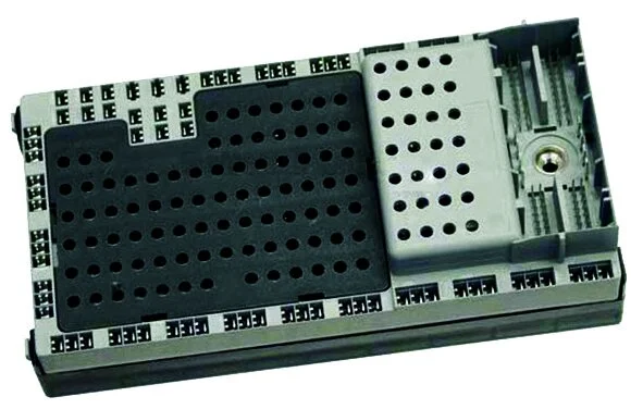

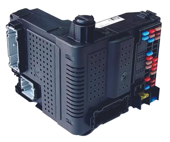

The CEM-H is the K-line CEM used in all P2 cars from 1999 to 2004. CEM-H has a Motorola MC68386. It is called a CEM-H because it is physically shaped like a H. The CEM-L has a Renesas M32C and is physically shaped like a L.T5Luke wrote: 13 Apr 2021, 06:23 The CEM H are just the CEMs for the XC90, they have a minimal hardware difference but no real software difference between the CEMs of the other cars.

Ok, then tell me what is this?RickHaleParker wrote: 13 Apr 2021, 12:40The CEM-H is the K-line CEM used in all P2 cars from 1999 to 2004. CEM-H has a Motorola MC68386. It is called a CEM-H because it is physically shaped like a H. The CEM-L has a Renesas M32C and is physically shaped like a L.T5Luke wrote: 13 Apr 2021, 06:23 The CEM H are just the CEMs for the XC90, they have a minimal hardware difference but no real software difference between the CEMs of the other cars.
https://www.ebay.com/itm/Volvo-XC90-CE ... SwPJFgcVJI
The XC90 have some extra ICs on the CEM and it is called CEM-H then

It is a CEM-L.T5Luke wrote: 13 Apr 2021, 13:11 Ok, then tell me what is this?
If you consider a eBay vendor with a super low 88.9% Positive feedback as good source of facts ... You are beyond help.
CEM-H P2 1999 - 2004.
CEM-L P2 2005 - 2014.
