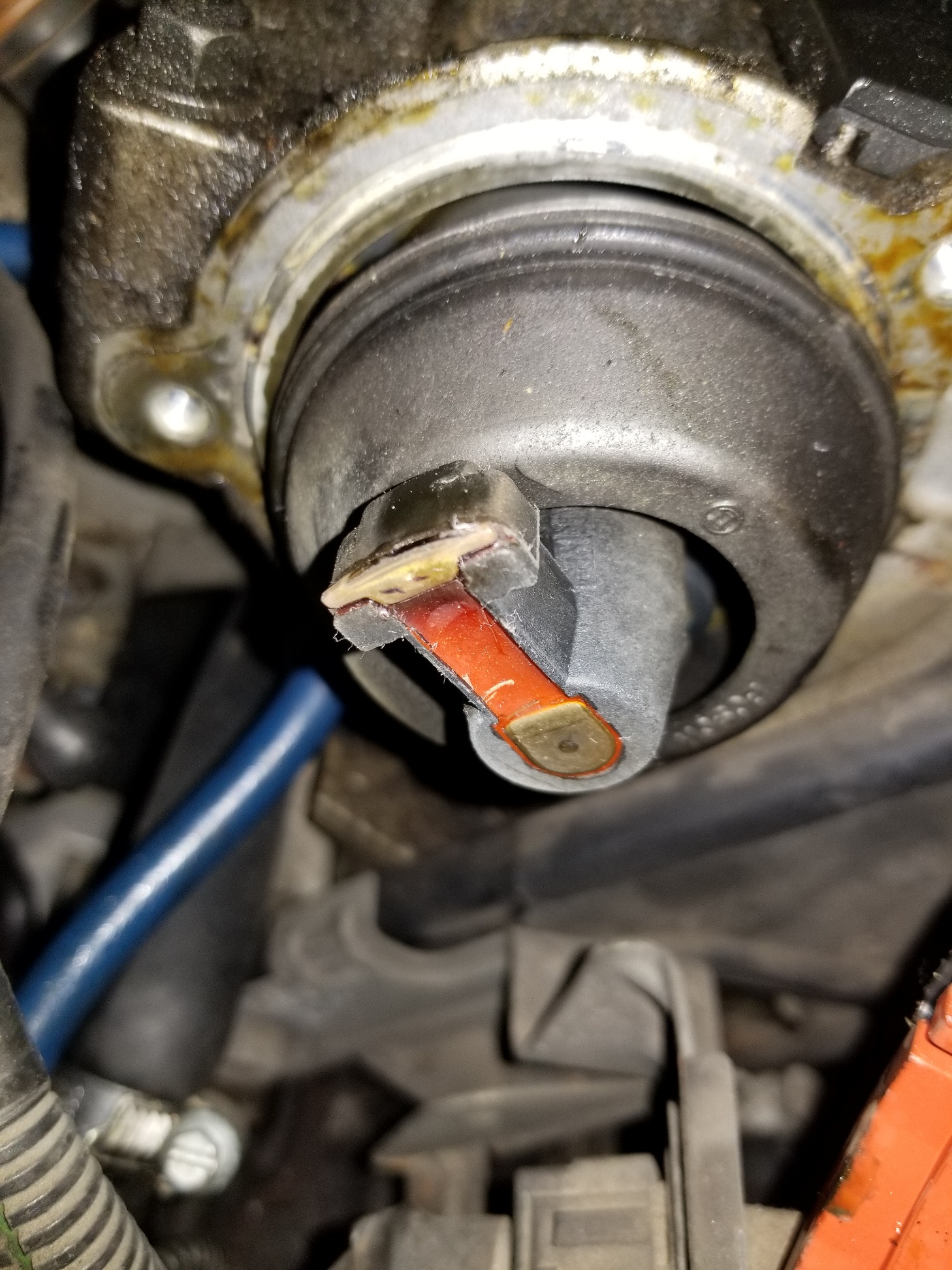

So it's been driving for two solid days with no leaks. About 260 miles. Currently tracing down the cause of the rough idle. Replaced the plugs, that helped a bit. Then I suspected the cap and rotor. Cleaned the contacts and that helped a lot. So I ordered a new cap and rotor. Attached is a picture of the old rotor before I cleaned it.
If it's not that then I'll have to triple check the mechanical timing by hand again.

That looks pretty torched. I would put new one on, and get a real Bosch and cry once....

Yep that's exactly what I did.abscate wrote: 14 Feb 2019, 08:36 That looks pretty torched. I would put new one on, and get a real Bosch and cry once....
Still idling a little rough, so now I get to check the mechanical timing again this weekend. Maybe I got it off a tooth.
It's probably described by the word "racing" it's like the engine is excited and wants to review up. Then there's an occasional light stumble. So it overall ends up being lightly off balance and vibrating. Maybe I'll post a video tonight. Everyone loves s YouTube video of an engine idling....
