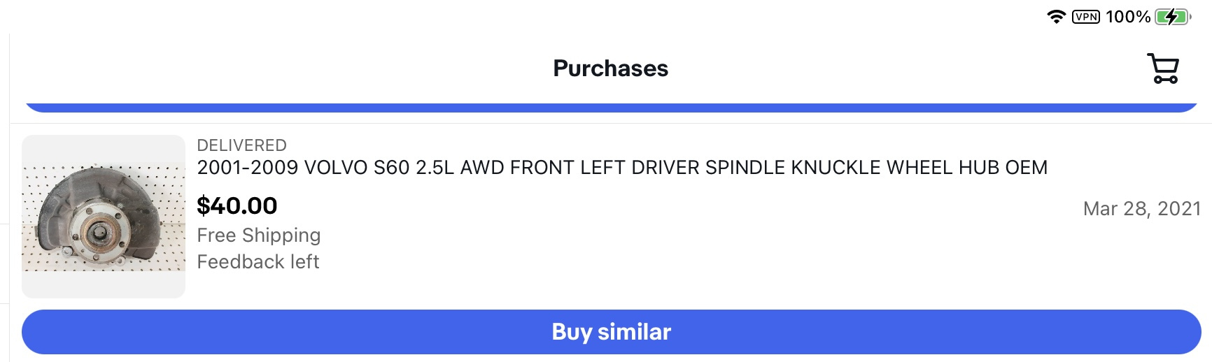

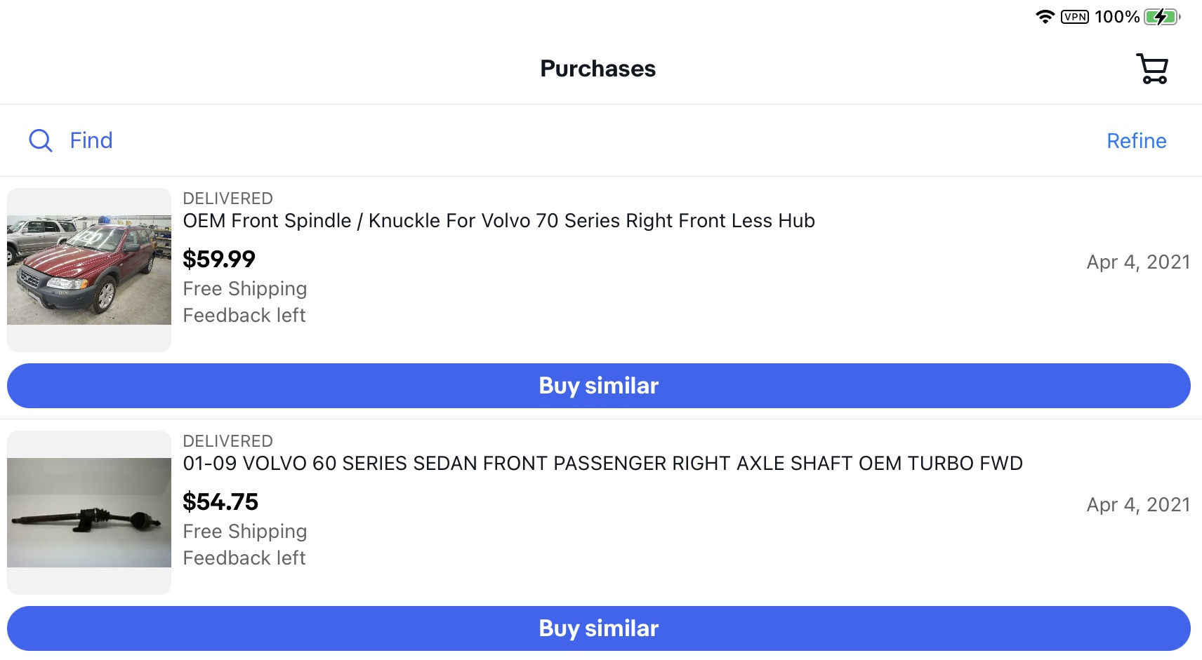

I saw that video too. I had a right CV/Axle separate at the mid point while doing my control arms recently. I picked one up for $55 on eBay. It has 118k on it. Works great. I also went a little wild and picked up both knuckles for it as well. One for $40, one for $59. Wheel bearing included with one, ABS sensor and ball joint included with the other. All in real good condition and free shipping as well. I figured it would be good to have spares or just the knuckle that I could add new parts to while on my bench and swap when I need to. You may want to browse the eBay junkyard sales to get it back on the road. You can always swap them out for new later. And no your transmission does not need to come out. The axle’s just slide in.
