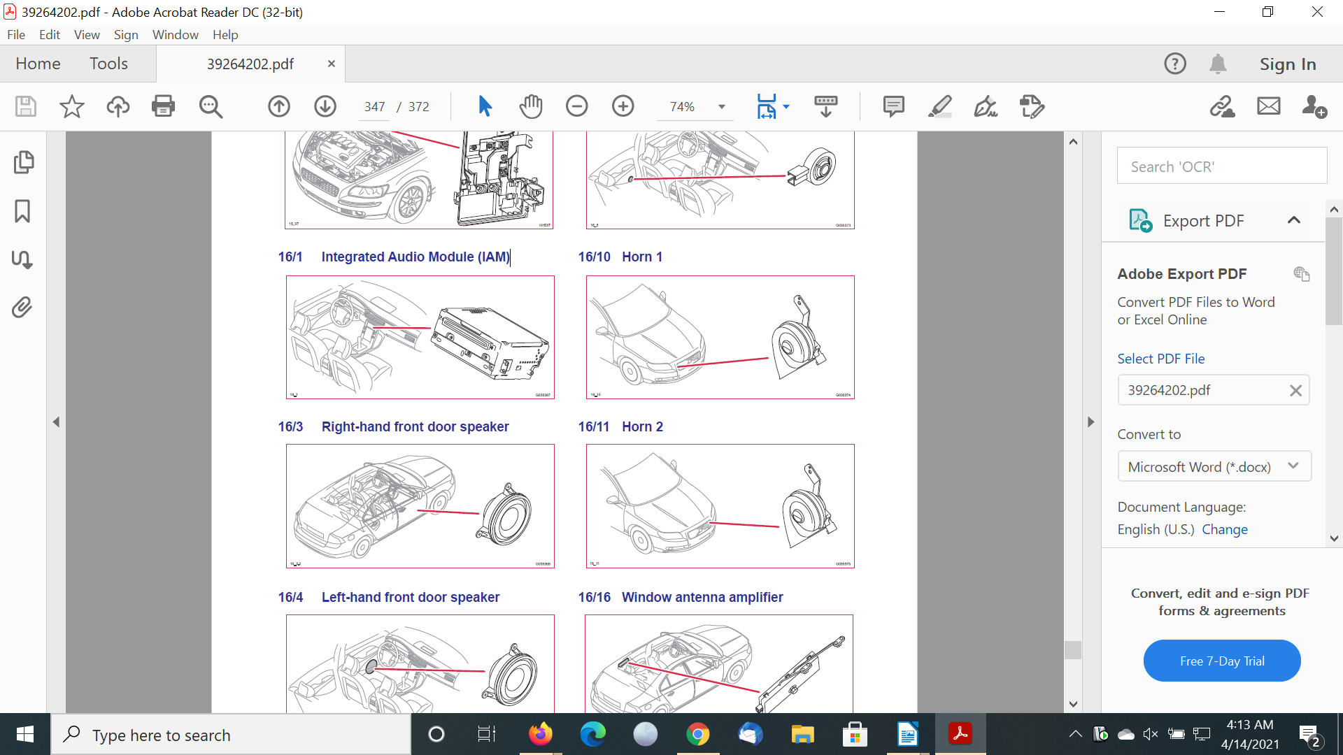

I've found reasonable speaker replacements for the 4 doors.
How hard is it to add an oem amp to the factory wiring?
Is the wire harness already there?

The OEM Audio amp is in the Integrated Audio Module (IAM). Which includes the optical disk drive.

VIDA says the following about MOST bus security:woodysca wrote: 17 Apr 2021, 13:35 Can I swap in another IAM? Is it plug and play or do you need to download data from the old one and upload it to the new one?
In order to function in the MOST network, the infotainment control module (ICM) checks that the integrated audio module (IAM) has a correct serial number. If the number is incorrect, the integrated audio module (IAM) does not work.
