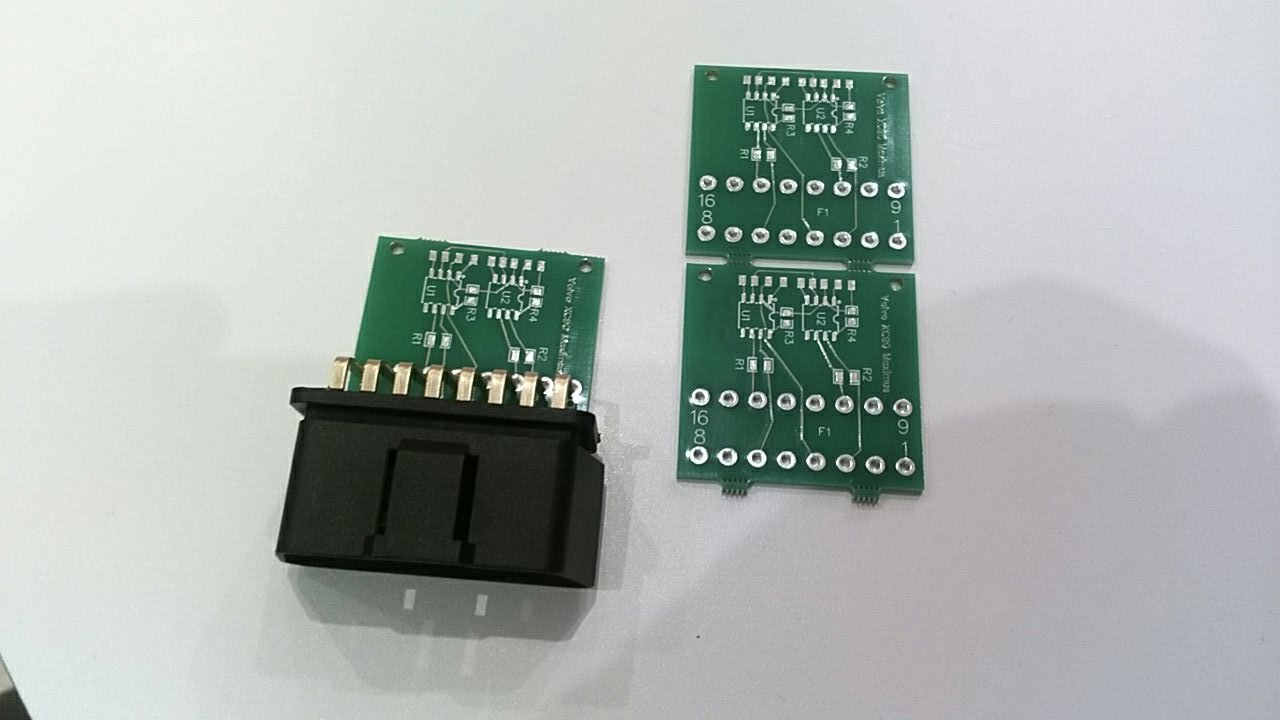

It also need a driver for K-line, for earlier P2s. I used mc33290d connected to serial port 3.MaxDenisov wrote: 24 Apr 2021, 12:57 @vtl I am working on new pc/hardware design. Please let me know if you are interesting in spare pcb/device

MaxDenisov
- Posts: 36
- Joined: 06 Mar 2021, 12:34
- Year and Model: XC90 2010
- Location: Moscow
- Has thanked: 2 times
two in one or just separate device/adapter?vtl wrote: 25 Apr 2021, 08:10It also need a driver for K-line, for earlier P2s. I used mc33290d connected to serial port 3.MaxDenisov wrote: 24 Apr 2021, 12:57 @vtl I am working on new pc/hardware design. Please let me know if you are interesting in spare pcb/device
