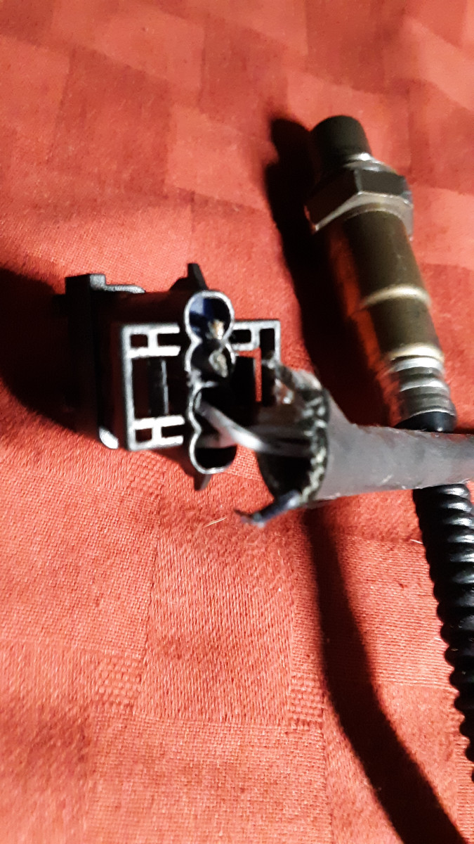

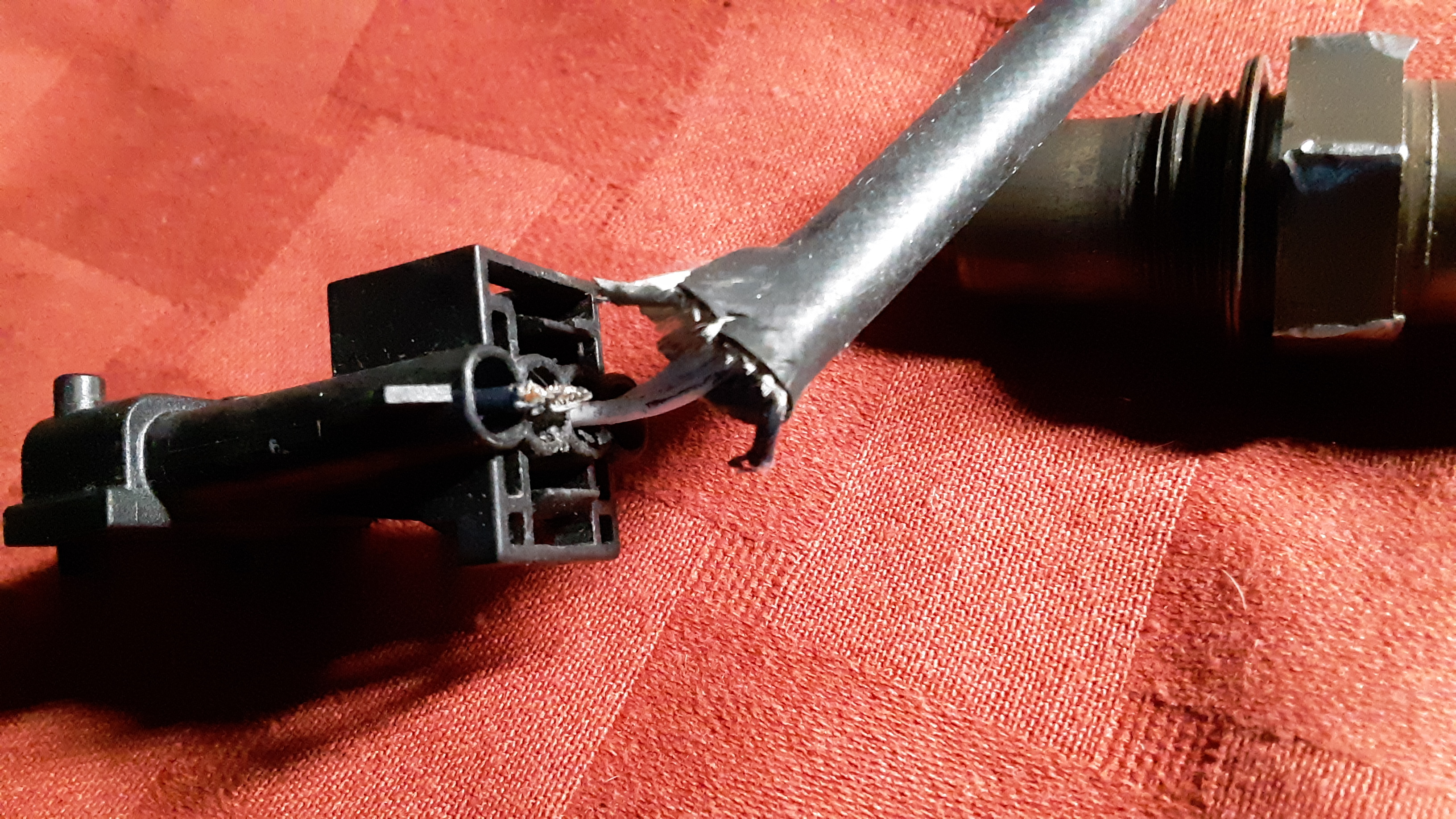

I found the problem with the downstream O2 sensor. Seeing as the wiring is stainless steel, and my pulling on the wire was not hard enough to do this, I suspect someone tried to change the sensor (it was easy to unscrew from the converter), and didn't know what they were doing. Yes, I pulled on the wire go get it through the maze of tubes and wiring looms so I could disconnected it. No, I didn't twist it.
Once again prior responders prove they know what they are talking about.
