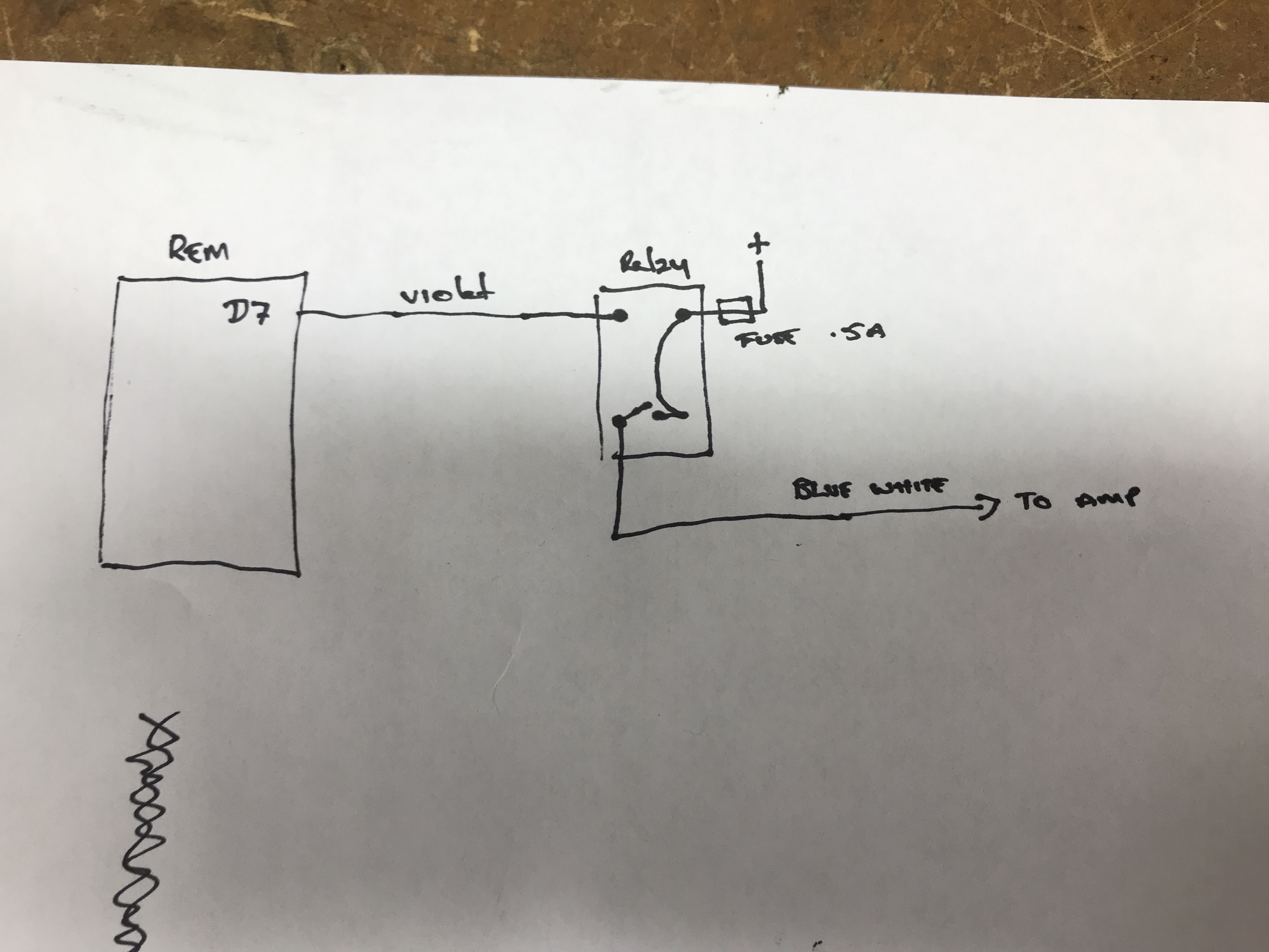

My understanding is that D7 goes low on turn on. It goes to ground (zero volts) - you would need a relay to turn this into a positive feed for your amps turn on blue /white wire.

Stu70 wrote: 04 May 2021, 03:36 My understanding is that D7 goes low on turn on. It goes to ground (zero volts) - you would need a relay to turn this into a positive feed for your amps turn on blue /white wire.

I still have the original Volvo cable for the subwoofer: two +12V wires, two ground wires and the four wires coming from the rear d pillar speakers. I only need to turn on the subwofer amp connecting "something" to the pos 2 of the diagram above.

D7 goes to 0v when the key goes to position 1 Not when the radio remote is powered.(That’s what the ‘x’ means)
If you connected the blue/white wire from the alpine to the Volvo subwoofer it won’t turn on. But a usual aftermarket amp should.If you have a test lamp or multi meter (if you haven’t get one, it’s essential for these types of issues), put one lead on the violet wire and one of the red wires. You should have no power with key off and a light/12v present with key on ‘accessory’
I got different answers when asking similar questions to you.Some suggesting the violet wire had to be ‘turned on’ via dealer programming.
If the blue /white wire goes to 12v when the hu is turned on and your aftermarket amp requires a 12v remote on signal it may require running a new wire to the amp. Or it will work using the relay diagram above
