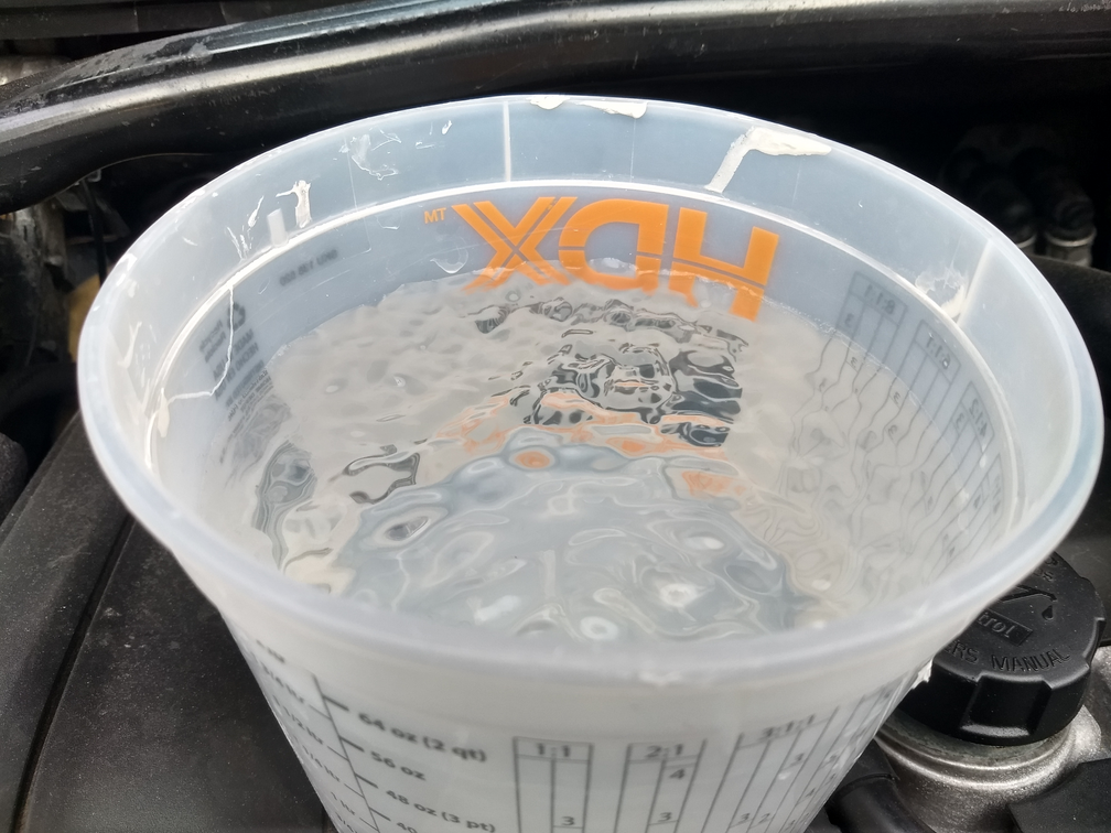

Alright, that's my engine:
As you see, lots of waves, however no vibrations in the cabin.

Are you talking about my video of the water bucket of water on the engine? It's exactly the same as vlt's video.
