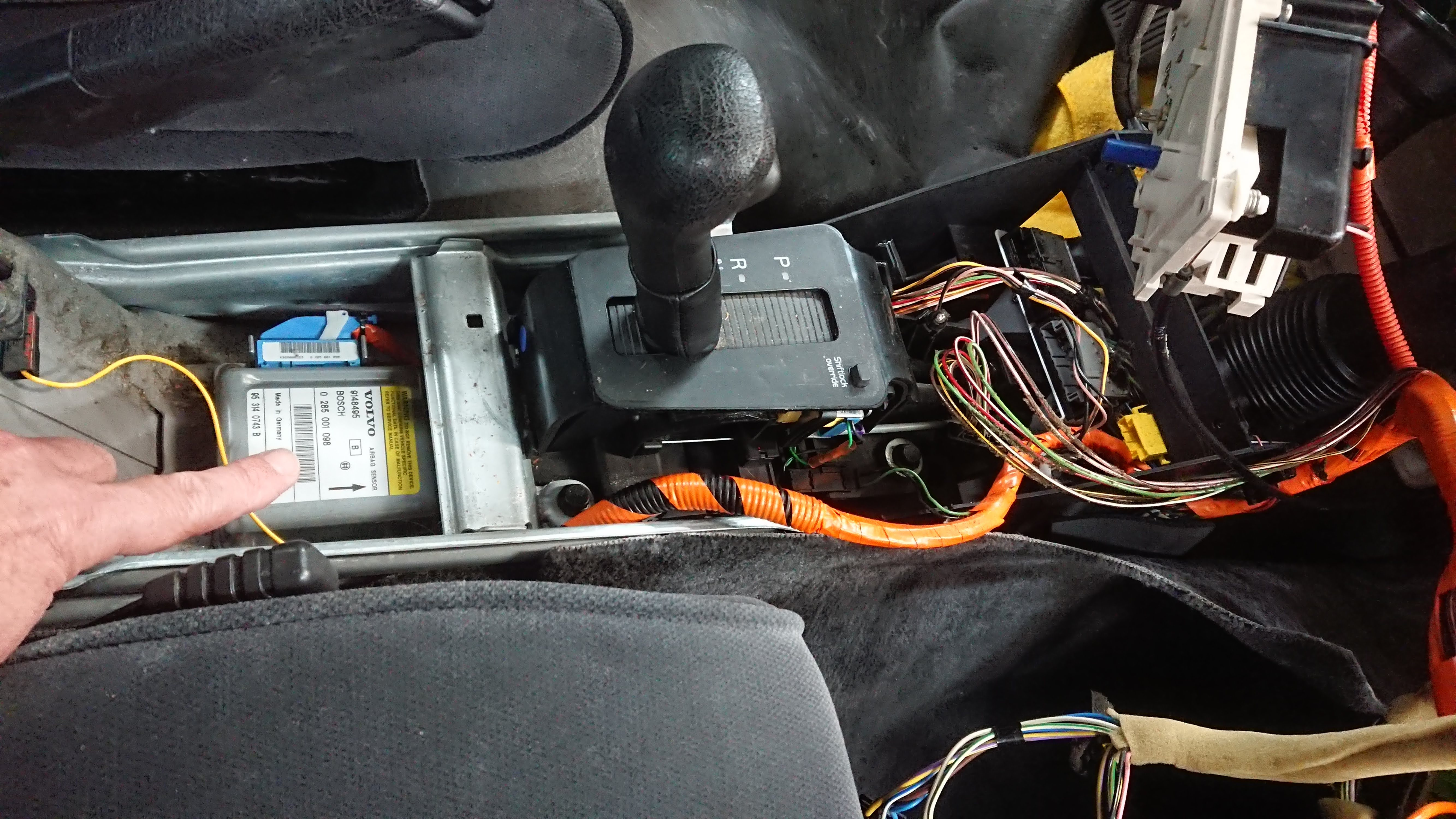

I could disconnect all the plugs in the center console harness and remove that, except for that weird little box behind the shifter. It says on there: DO NOT REMOVE. What's up with that?
Here is a photo showing how the cable from the right side knob is going under the harness:
Then this one shows the box I can't disconnect:

Airbag control module. Disconnect battery leads, wait 10-15 minutes, unplug and remove this module. Keep it carefully, install back in last.

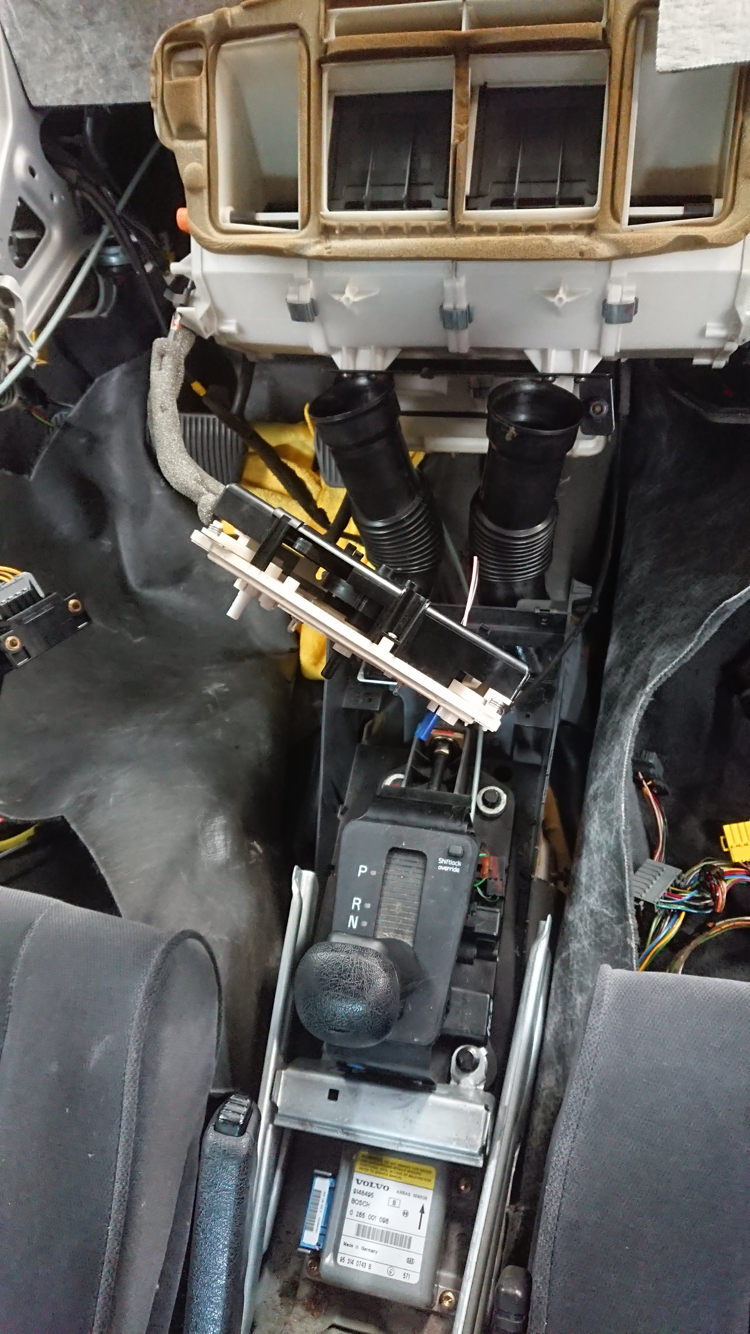

Azik09 wrote: 10 May 2021, 11:27 Airbag control module. Disconnect battery leads, wait 10-15 minutes, unplug and remove this module. Keep it carefully, install back in last.
Thank you Azik. This worked and I was able to remove the center console harness:

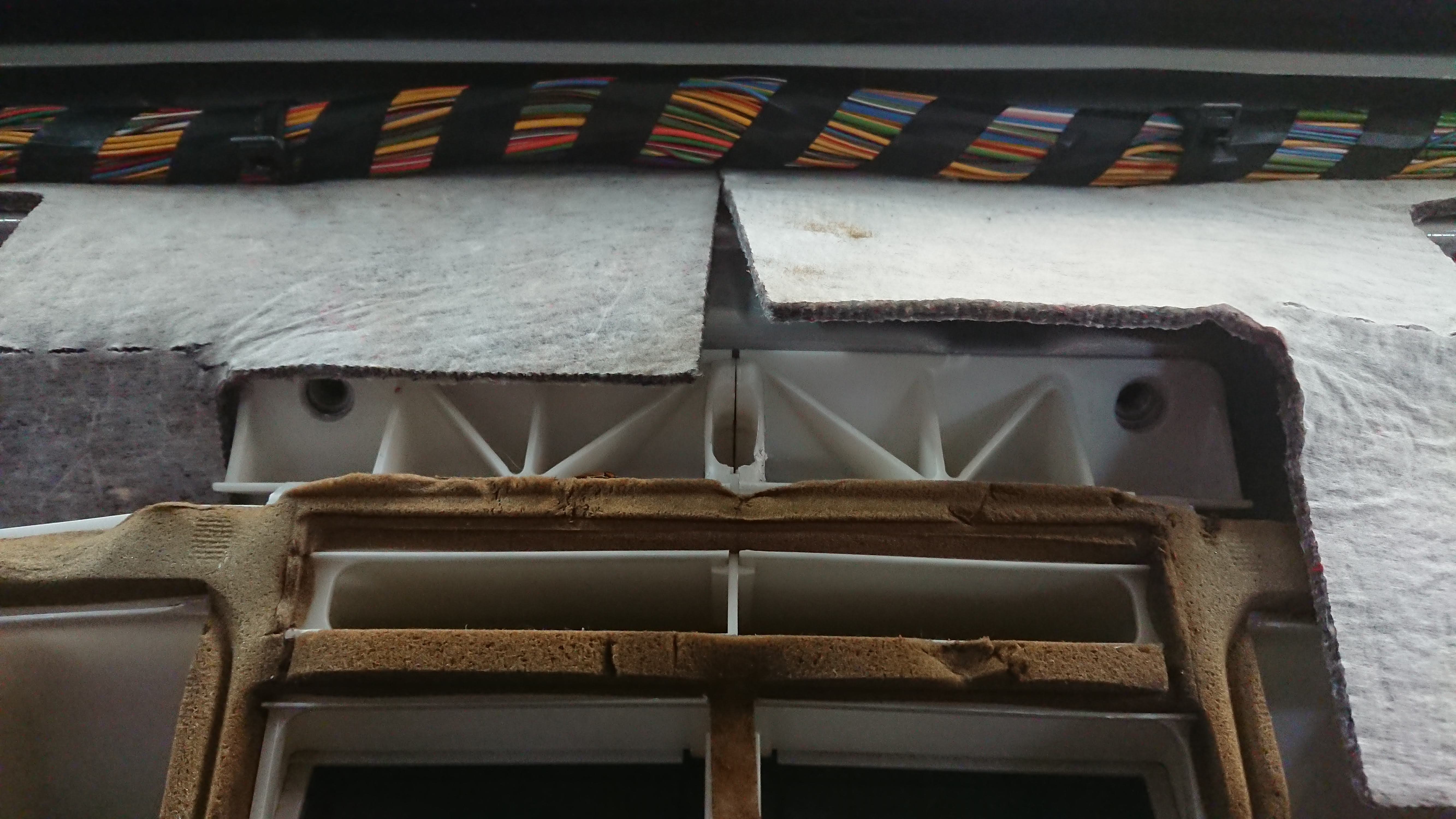

New problem though. I have everything disconnected from the heater box, but it won't come out.
There seems to be something still connected right in the center between the left set of screws:
It feels like I would have to yank really hard, or something would break.
Anybody know what to do here?
Thanks, Dirk

Posts: 35272
Has thanked: 1497 times
Been thanked: 3810 times
It sits in a hard plastic pin that extends into the dash. I took pictures wAy back in 2013 when I did mine
Page three of this thread
viewtopic.php?f=1&t=56005&hilit=1999+v70+t5&start=20
I think you have to lift as you draw back to unhook the pin
