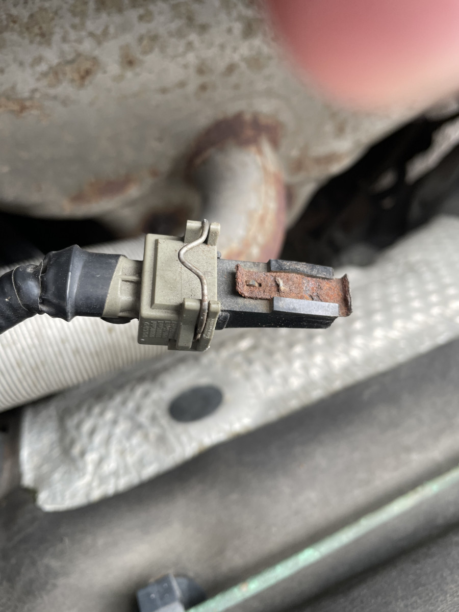

Please help me identify this plug 99 V70
- BEJinFbk
- Posts: 4070
- Joined: 05 Jan 2008, 22:32
- Year and Model: '98 V70 R
- Location: Fairbanks, Alaska
- Has thanked: 94 times
- Been thanked: 146 times
Peel back a little tape. If you see a
Yellow/Red and a Brown, then it’s
a prewired connector for a security
system horn that your car wasn’t
shipped out with.
The black dummy plug with the metal
clip is there to waterproof and keep the
unused connector from flopping around.

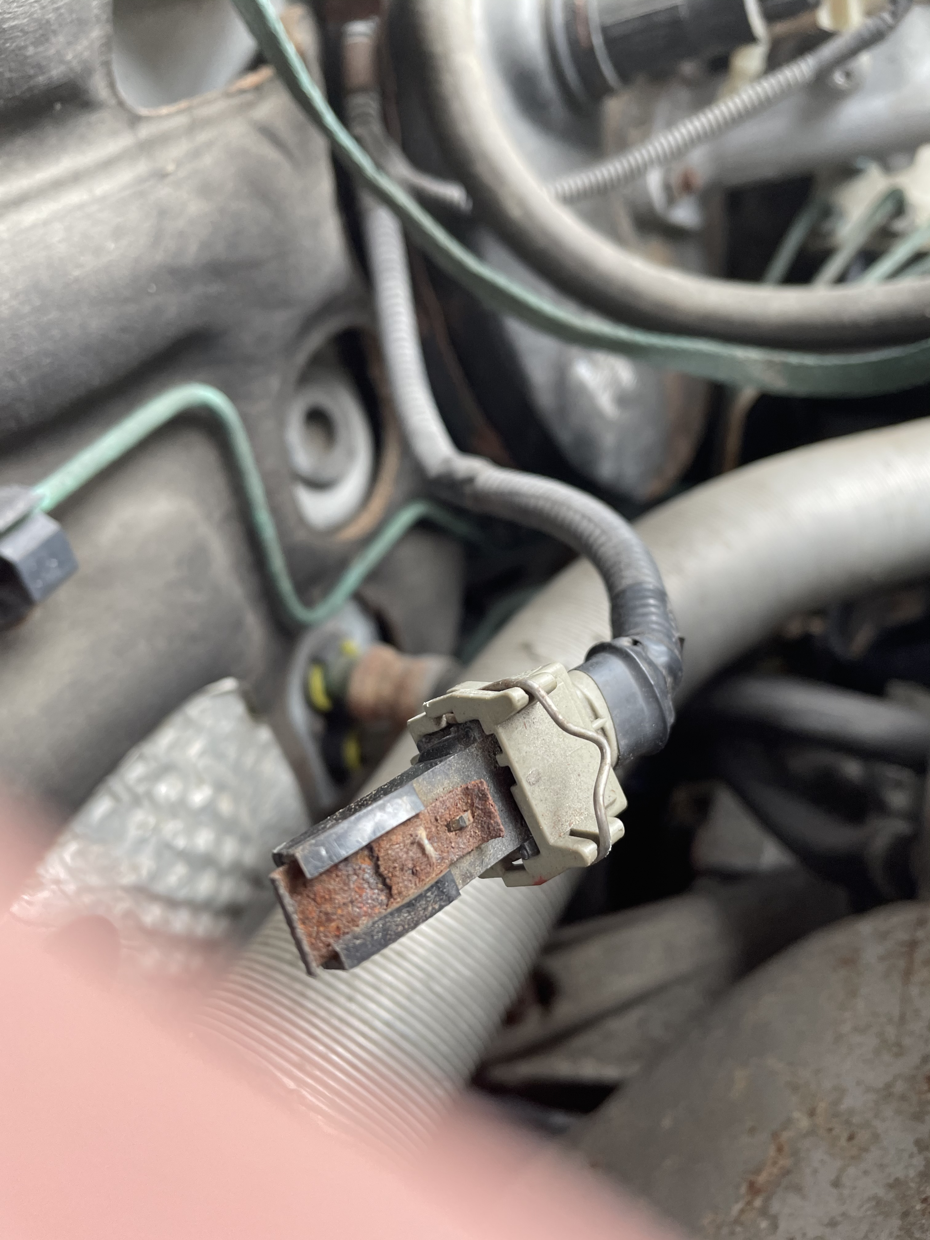

Could we get another pic of that?

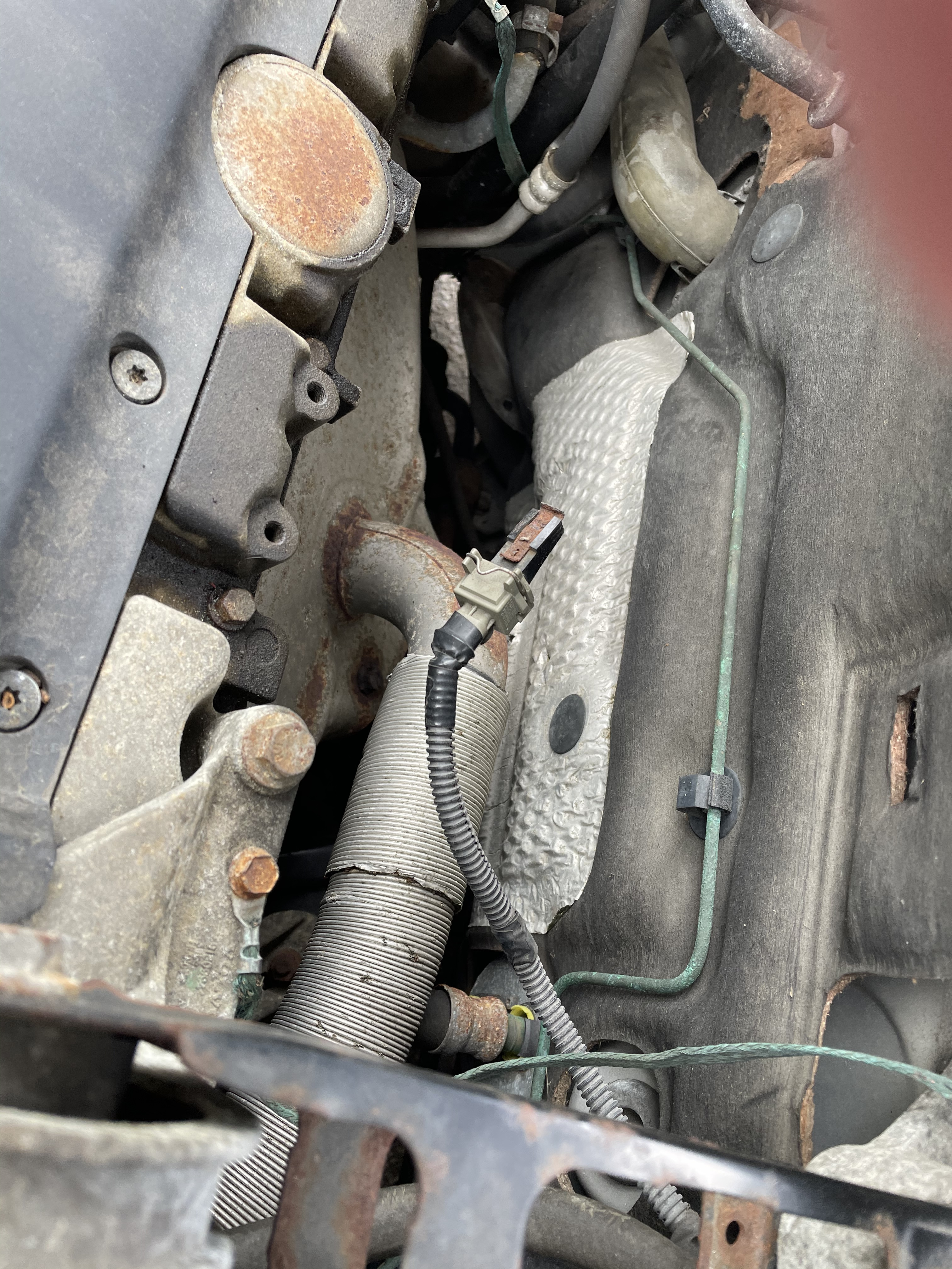

Everything about it being a non installed security component makes sense. I found the plug hanging but there is no symptoms or non working components. The black dummy plug seems to have been welded to the firewall and broken off.

It's connector for alarm system horn.

Pop quiz, extreme Volvo trivia
How can you tell it’s a 99NA given only picture number 1?

Pretty easy. No turbo, aluminium torque rod mount ))abscate wrote: 11 May 2021, 17:07 Pop quiz, extreme Volvo trivia
