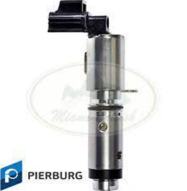

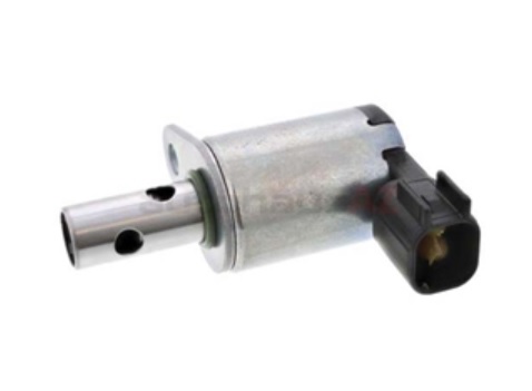

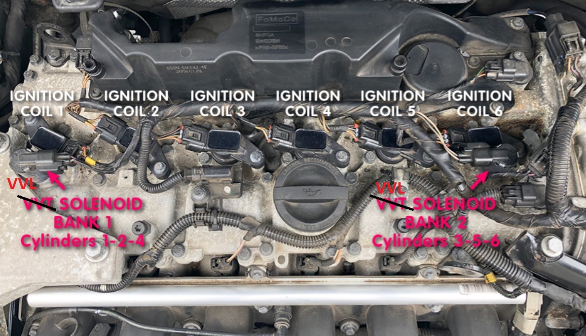

Here are the parts that I am recommending that you swap
And these parts should look like this
If you removed the Variable Valve Timing instead of the Variable Valve lift then it will look like this
If this is the part that you removed and you need O-rings then get the Land Rover O-rings (they should work fine)
LR003093 for the bottom O-ring
I don't have a part number for the other O-ring
Take care
Paul

The full code was ECM-P003F00 Intake (A) Camshaft Profile Control Stuck On (Bank 2). I replaced the single long VVT, which I believe is the correct one?

Dude, I replaced the wrong one didn't I. :(

Confirmed I replaced the wrong one. Was led astray by another poster in another thread/site along with the Carsoft code referencing the "Intake" so I focused on that other intake solenoid. Just removed the smaller one next to it and was total crap ;-)
