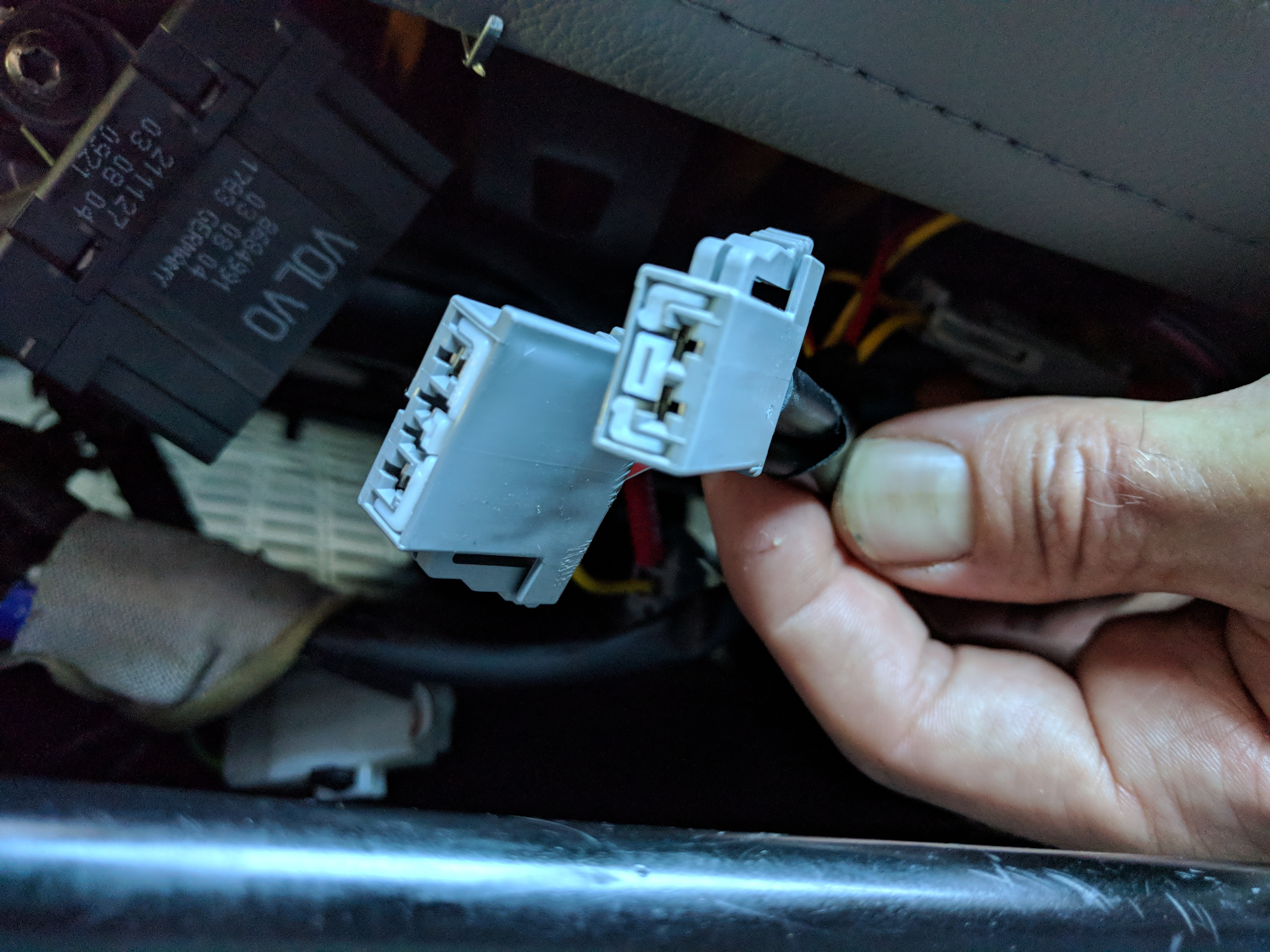

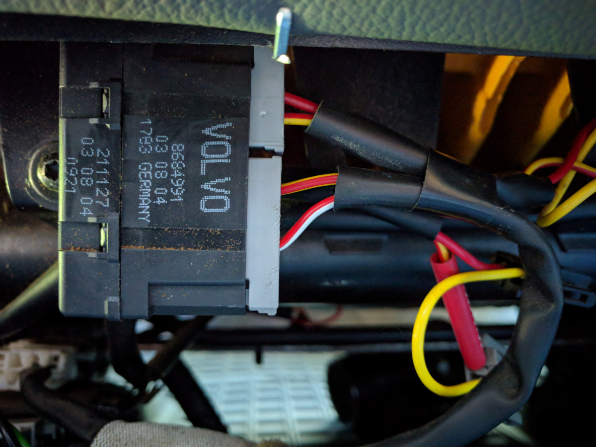

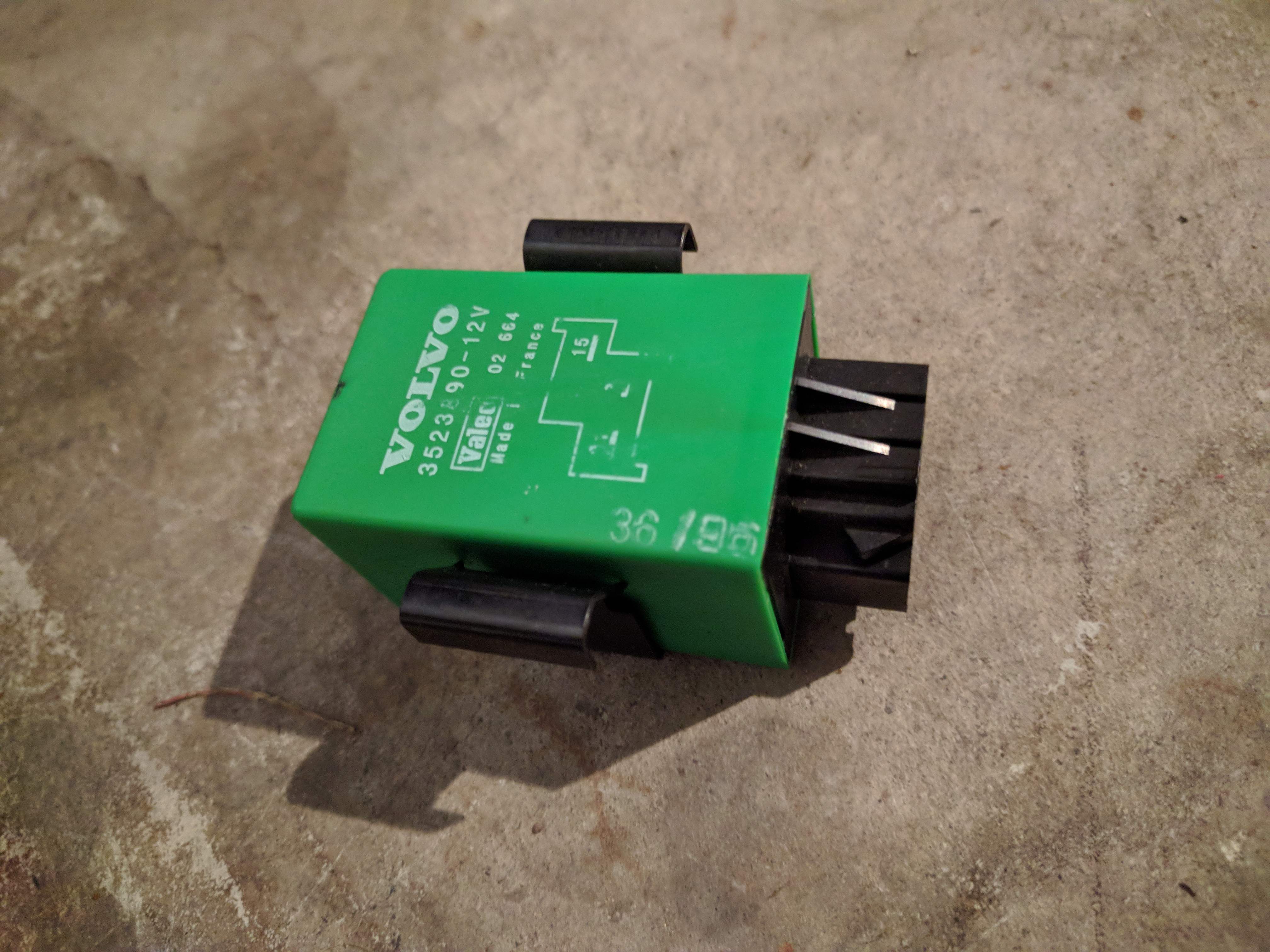

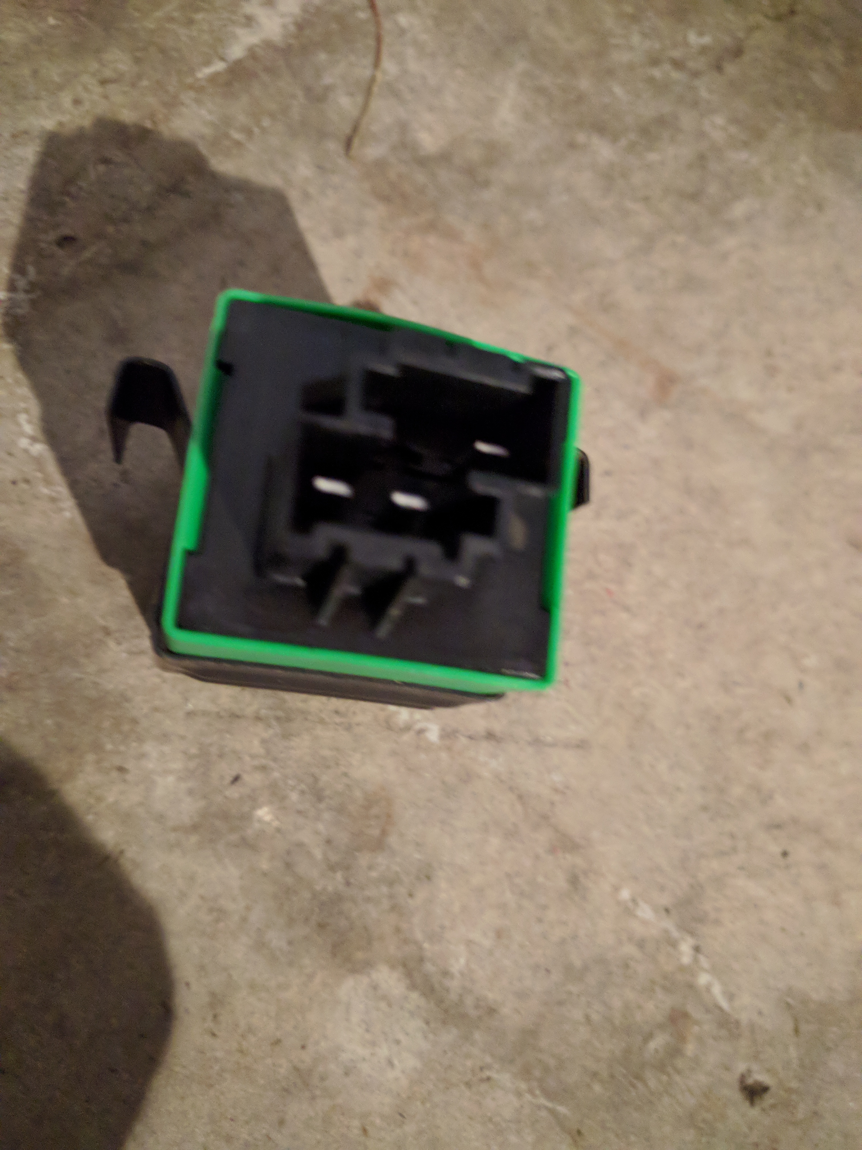

Thought about changing out the wiring harness. Did the same project on a '93 850 but replaced torn-up leather seats with nice condition cloth seats and the relays were similar, one was just marked "leather". The first photos of the green relay are for the leather seat, the third is the plugs for the original heated seat, and the last photo is the original relay in the car.

The last image looks like the retrofit recall relay to deal with fire issues. As such, that's the one I'd go with and be trying to fit. The same recall relay kit was used for both cloth and leather, so should be your best bet.
