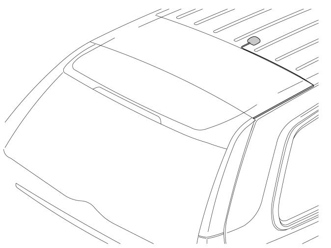

I recently purchased a Sirius Onyx radio (https://shop.siriusxm.com/onyx-plus-vehicle.html) for my 2009 XC90 and I'm having trouble trying to figure out how to run the magnetic antenna. I originally was going to try and put in on the back of the roof on top of the brake light panel and then try to figure out how to run the cable to the front but that panel is plastic. I then decided to put it near the top corner of the windshield near the driver's side but I can't figure out how to run the cable. I've installed the radio before on my old Saab and was able to tuck it beneath the weather stripping but I can't seem to figure out how to do this on my XC90. Any suggestions? Has anyone done this before?

Look forward of the third brake light.
There is a spot to mount the Antenna and a channel to run the wire from center to left then to rear tailgate.
This is where the OEM Sat Antenna is installed. The OEM does have a thin coax cable and a rubber jacked molded to fit the channel. You can make a jacket out of RTV.
