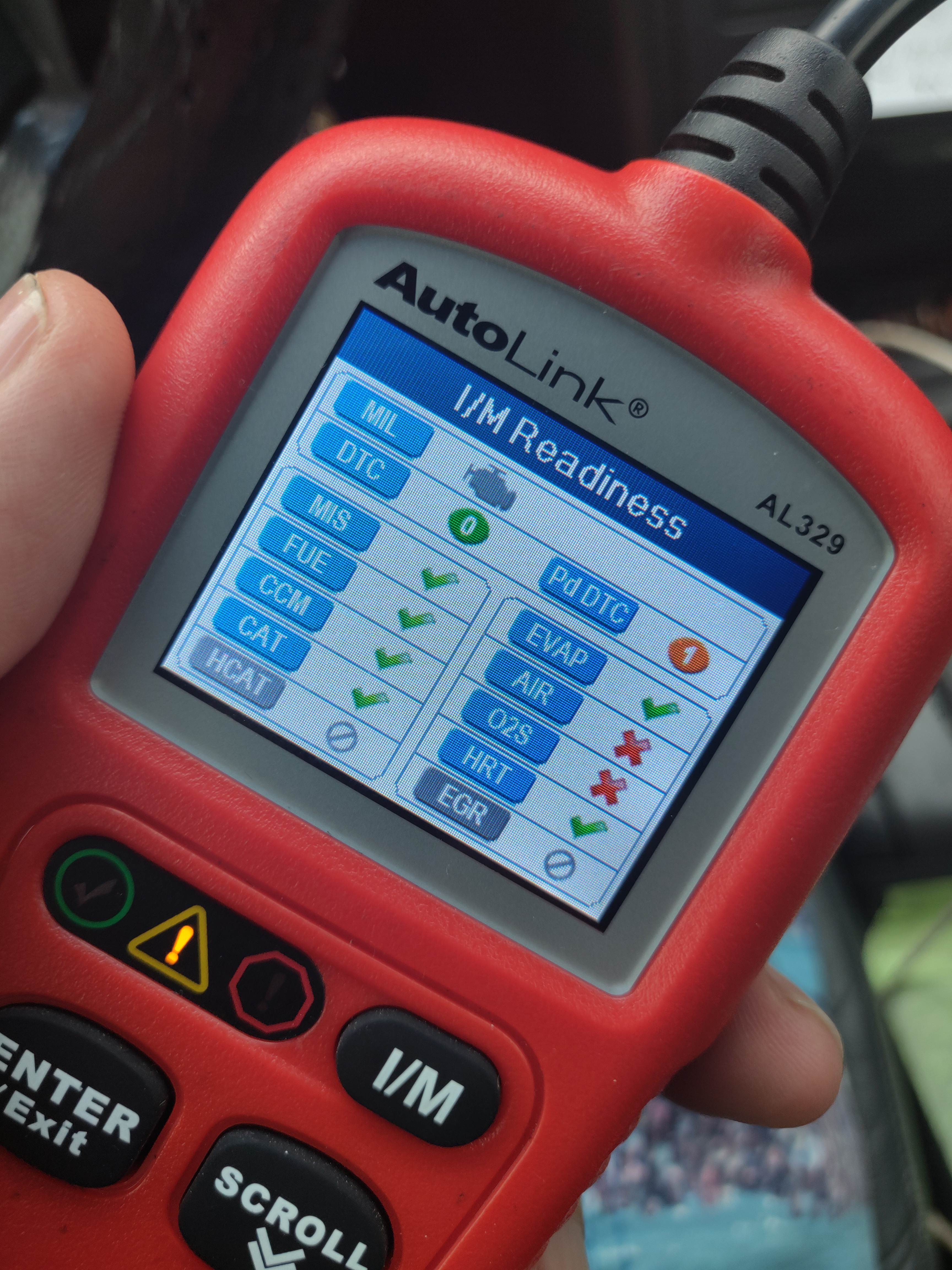

Sufbug
- Posts: 125
- Joined: 16 Sep 2020, 18:06
- Year and Model: 1998 V70
- Location: Fairfax VA
- Has thanked: 2 times
- Been thanked: 2 times
Ok, so I started the V70 this am. Let it idle for 15 mins. Cold start to try getting some of readiness codes to move in a positive direction.
NOW..... I have the 410 code 'pending'.
Is that bad? Will that stop emmisions from passing?
Still going to try and get the other readiness codes to turn green.
I did find posts on doing a flywheel regeneration adaptation drive. They say you must do this before the drive cycles.
You guys have any experience with that one?
So currently, I am filling the gas to 3/4...and going to let the car cool down for about 5 hours.
Then try some drive cycles. There seem to be three main ones.
I will post them here when I have a moment.
Thanks!

Sufbug
- Posts: 125
Hello, just checking in at 853 am EST from lovely rainy Fairfax VA.
Where men are MEN! and sheep are nervouse....
Ok, so I filled the gas to a little over halfway.
I went and did the 'flywheel adaption' drive. Went like this.
Put V70 wagon GLT in 3rd gear. I have an automatic. So instead of putting the gearshift in 'D' I put the gearshift into '3' the marking on the shift plate. Ya know.....3rd gear!
Then , drove south on 286 from rt 50. Got the vehicle up to 3000-3500 RPMs. Held that level for about 15 seconds. Then, coasted down to 1000 RPMs approx.
Maybe 1200, sometimes 800, but slowed down WITHOUT HITTING THE BRAKE.
Then did this about 9 times. (I had to hit the brake once, so I did this 9 times instead of
No ac. No brake. No changing the gearshift position. Very slow and steady throttle application.
When I did hit the brake, once, I didn't count that run. So I did one more run up to 3000-3500 ...held for 15 seconds plus, then let my foot off of the throttle , and coasted to 1000 or under...plus or minus 150 RPMs.
One of my monitors became ready! Yay! Only 4 more to go....
