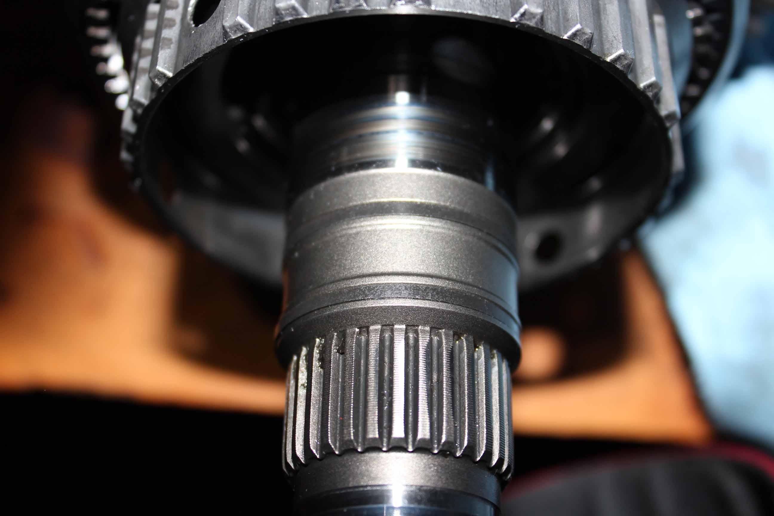

If you're planning on doing all the work yourself and replacing your current transmission with a good used one I will say you have the skills to split open the case of the transmission and replace many of the parts that are likely causing your 3-4 flare. I suspect it's worn 4-5 clutch frictions or a pressure drop due to a leak in the 4-5 apply fluid circuit which includes 3 sealing rings. For the 4-5 clutch apply the fluid enters through the end of the transfer shaft with a sealing ring on the end of the shaft. The fluid then exits through the shaft into the 4-5 drum and there's two more sealing between the drum and the shaft. The sealing rings are hard nylon/teflon type rings and used in different places within transmission. If any of these seals were leaking then there will be a drop in the clutch apply pressure. They're easy to replace when the transmission is apart.
The friction plates are not difficult to replace either. Replacing the seals for the apply pistons is a little more involved because you have compress the springs to get the retaining rings off and pistons out. Replacing shafts bushings is a little tricky if required but doable. There's also possible case wear which would require machining and an insert.
The challenge with a used transmission is finding a known good one and one that's compatible, which depends on the final drive ratio and if it's a FWD or AWD, plus there are changes to the wiring harness connections from 2005 on I believe. If you can find a good used one it's definitely does save time and labor over rebuilding one but if the used the transmission isn't a good one or isn't compatible for some reason and you have do it all over again then I think it's more work than repairing your current transmission.
These two seals are for the 4-5 fluid apply pressure.
There's a sealing ring in the case for the end of the shaft (not shown) where the fluid enters the shaft for 4-5 apply
4-5 drum with clutch that's applied for the 3-4 shift, applied in 4th and 5th gear
CC) 4-5 clutch drum ready to install note inside beveled edge of top steel plate.jpg
