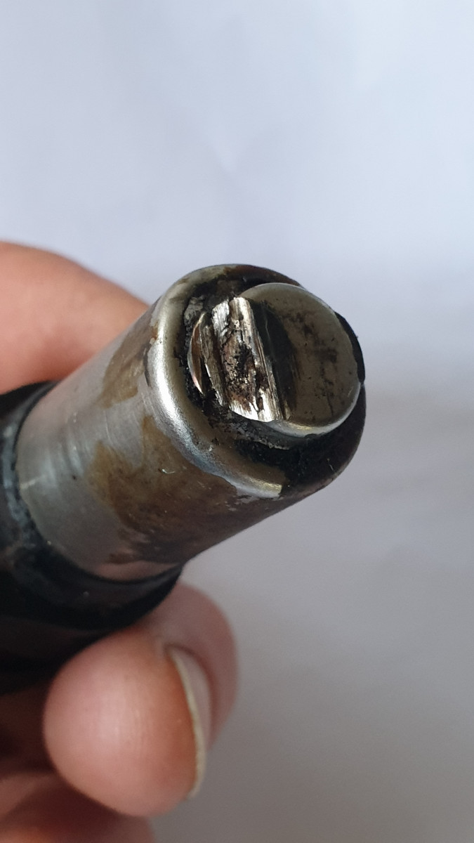

Even though we 96 upwards p80 owners know that the ABS/Tracs double orange means the module is faulty - it's not always the case, as I will photoproof here.
Interestingly, the lights were off in dry wearher and only came on in rauny condiruons, which made me suspect the wiring.
I guess a tiny rock got stuck in the ABS ring and slowly did grind off part of the sensor.
It's not always the ABS module

But, the fantastic thing is: even though this should have been the issue, the double orange is back. I will measure the ohms between the pins of each single wheel sensor at the main connector one of these days

Thanks Misha, that is what I am suspecting, because sometimes it seems to be triggered by full lock steering qheel action, sometimes not. Really weird
