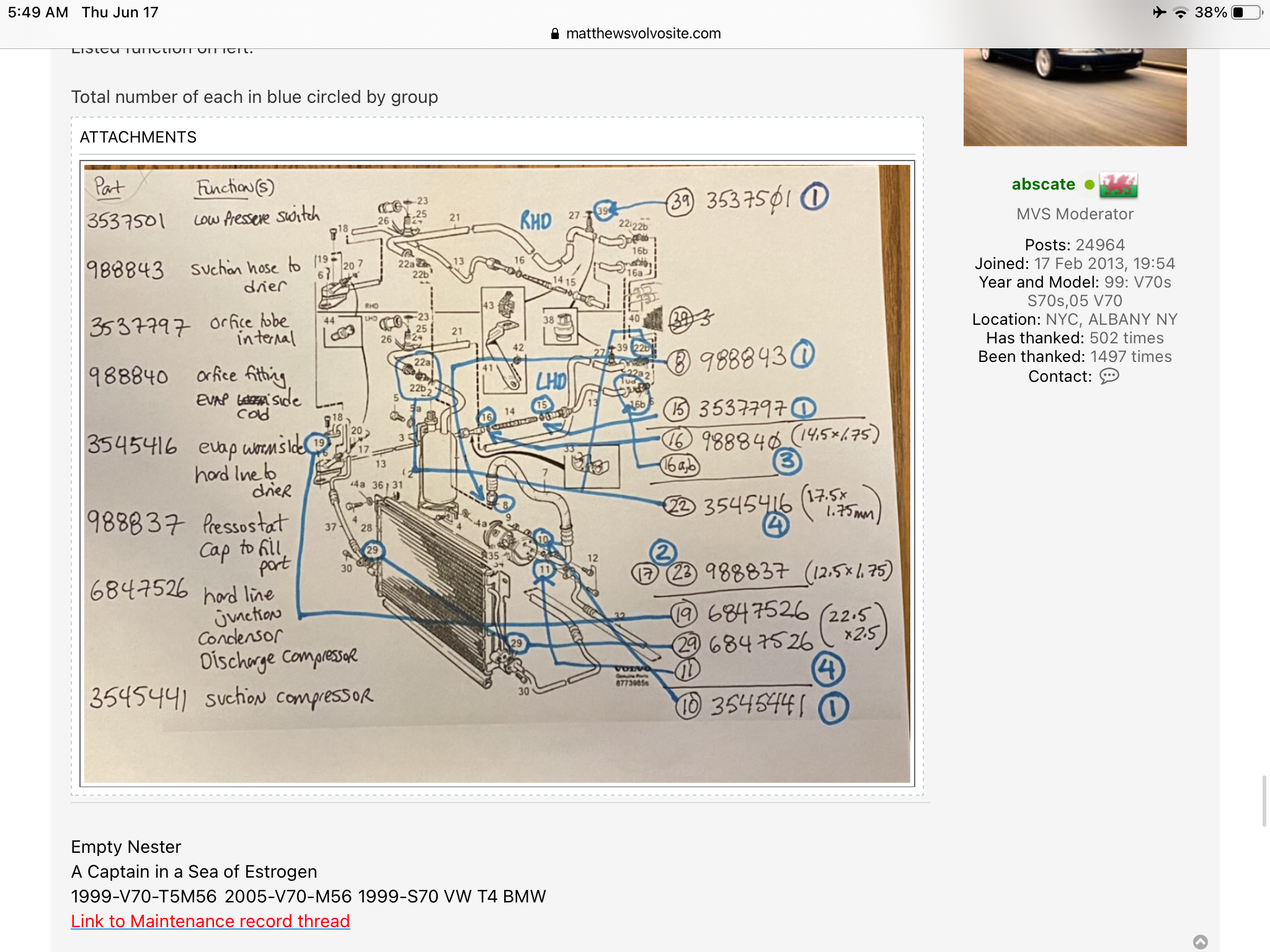

Try the master oring size thread in this forum
viewtopic.php?f=1&t=88579

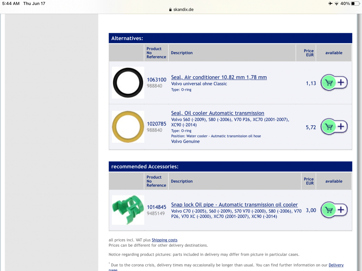

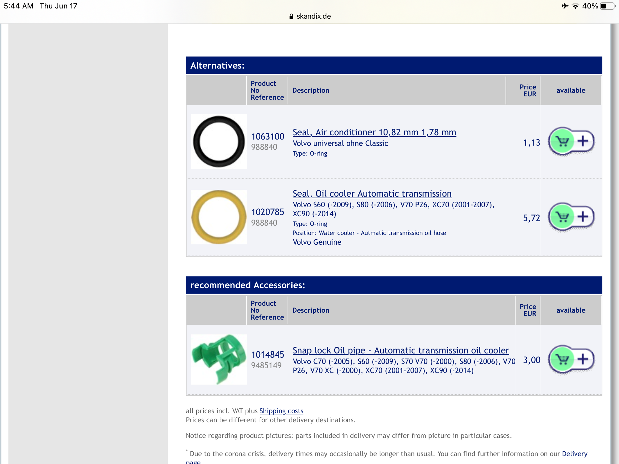

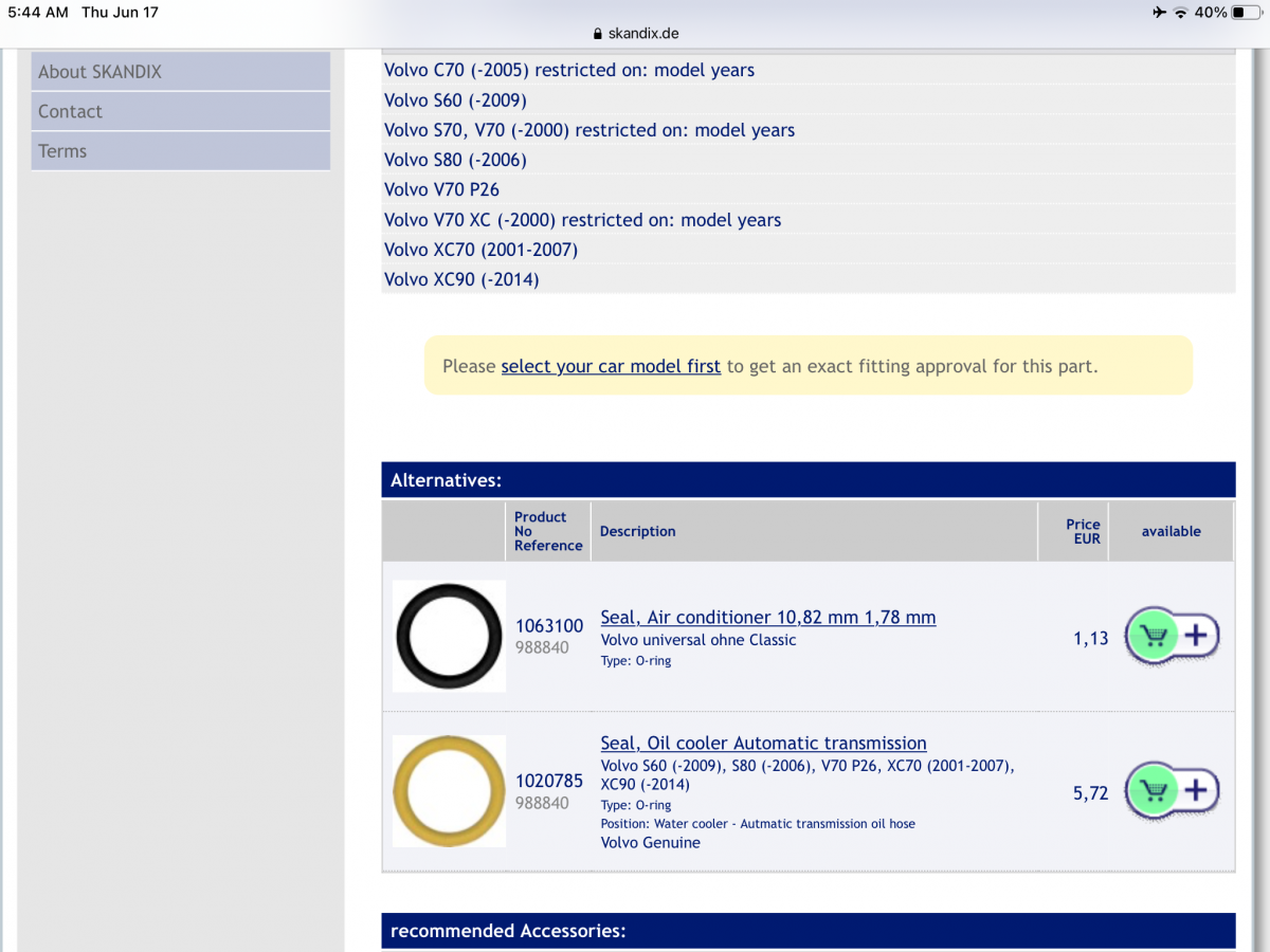

988840
It’s showing as 15.5 mm x 2 mm there
Hmmmm…skandix has a different size.
988840
- Posts: 36147
Ah, measured in the ACsystem, on right , mid page
Measurements are OD and thickness
