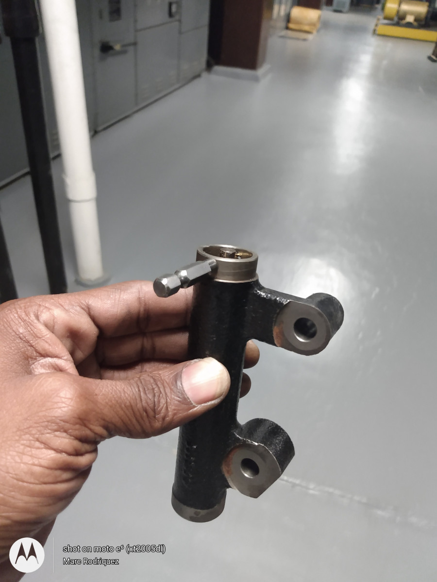

Here's a good hack if you're doing timing belt work. Y'all may know this already but a 5/64 drill bit makes a perfect pin to hold the piston in on the tensioner for the install. This is a Milwaukee bit.
